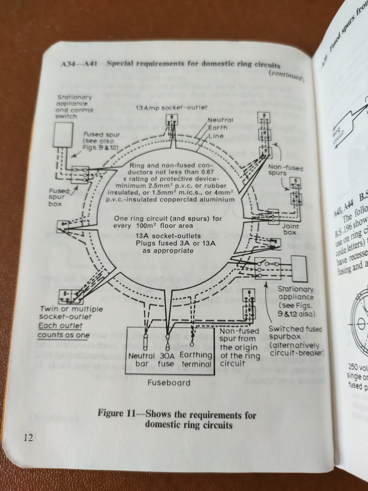

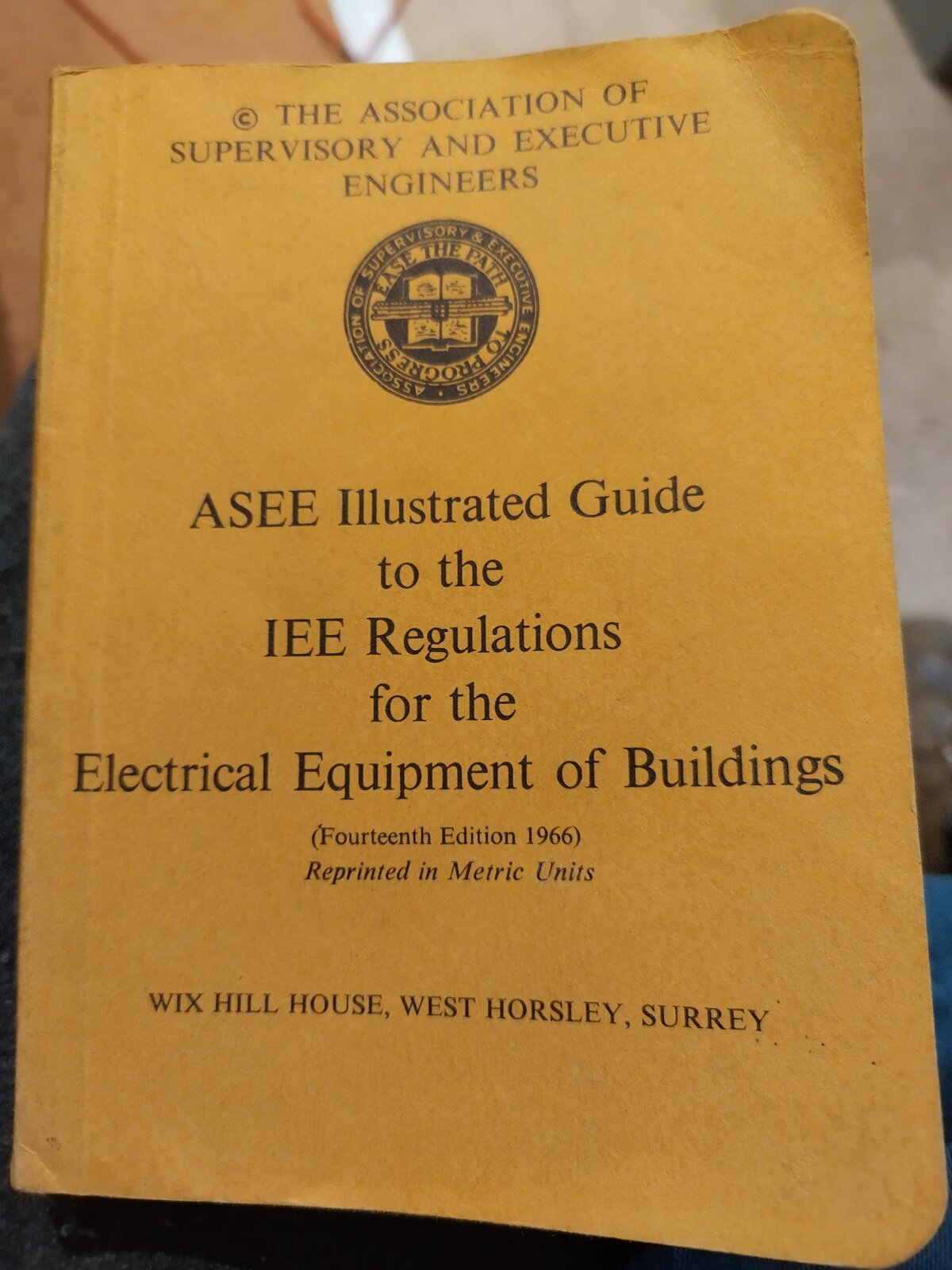

Been trawling online bookshops for old regs and guides again, sad old git that I am.
My latest is this:
It's the September 1976 Metric edition.
Ever wondered where the inspiration for Appx. 15 came from?
Four things immediately slap me in the face here:
1. You could use a 15A CB instead of an FCU.
2. Three sockets on a non fused spur. In my early copy of the 14th, you could have two single sockets or one double or one stationary appliance. Maybe the Metric 14th was changed? Can anyone with a Metric 14th tell me what A40 says?
3. Recommended fusing for plugs is at 3 or 13A, which is what is recommended now.
4. Mention of CCA cable. As late as 1976.

I mentioned an mcb used as a fcu years ago, during a discussion on here regarding what accessories are allowed on a ring and noone believed me, i'm not sure when it got deleted as i was at college early 80s.
This reg would likely have allowed 16a commando sockets off the ring which may have been beneficial
I mentioned an mcb used as a fcu years ago, during a discussion on here regarding what accessories are allowed on a ring and noone believed me, i'm not sure when it got deleted as i was at college early 80s. This reg would likely have allowed 16a commando sockets off the ring which may have been beneficial
I suspect that it's purely by 'oversight' that the reg permitting ring finals has never been updated to allow such circuits to supply things other than "accessories to BS 1363". Don't forget that that reg was born long before MCBs (and probably 'commando sockets) came into being. Maybe something for us to mention during the consultation for the next edition of the regs?
The '16 A commando socket' might, however, raise other issues if connected to a 30/32 A circuit, since it has no fuse
As far as I am aware that (strictly speaking) restriction only applies to ring finals -i.e. the regs would be happy with an MCB being 'used as an FCU' on a radial circuit.
I have also made similar comments on here as I'm totally convinced it was in the regs, I've certainly fitted a few 16A+RCD in an enclosure for external circuits off a ring
Not permitted as they have no shutters, allegedly even the interlocked don't qualify:rolleyes:
Two single sockets spurred from a ring that used to be allowed...didn't it?
Not sure why I wouldn't be allowed as it makes sense
What edition did that change?
