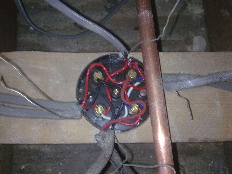

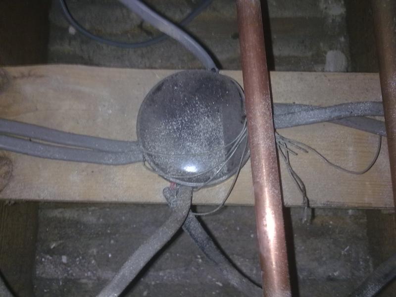

Junction box for downstairs room wall lights, note all the earth wires twisted together outside the box.
Wall lights also wired with speaker wire chased into the wall, seems to be a common thing in this house...!!
It was a fairly common practice to twist the earths together outside the junction box, on lighting circuits. In those days earthing lighting circuits wasn't always required, and so connecting earths wasn't taken too seriously. Even when earth sleeving was introduced, it took a while for people to use it all the time.

(Back on topic) joint boxes like this are quite common in older houses. Speaker wire obviously is not. Probably and addition carried out by a not so clever Mr DIY.

found some more today, some twist on cable connectors stuffed into a metal conduit box, with no earth.
