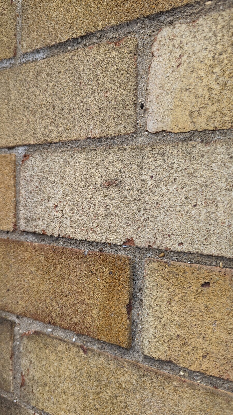

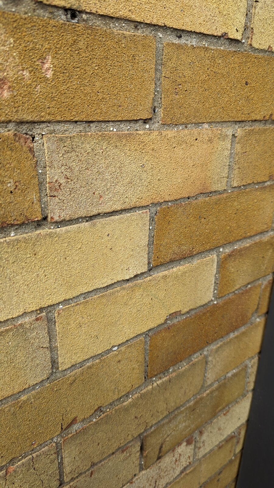

I need to replace some blown bricks but I'm struggling to find a suitable colour match for the mortar. It's a kind of in-between grey/buff I think
Does anyone have any suggestions on what to use?

Local quarry sand so go look at local independent sand and gravel merchants. Might find what you're looking for
I live on the edge of Cotswolds and all the DIY stores stock wrong colour sand for most of the area houses. They stock red not yellow. I buy from local independent merchants
