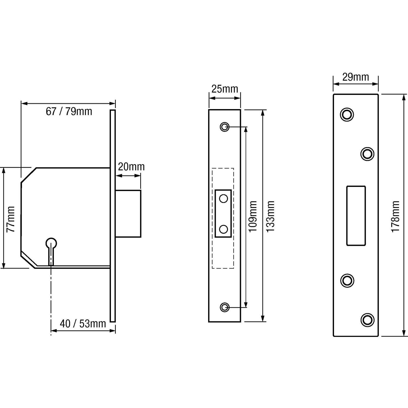

Photograph whatever words and numbers are stamped on the end. Photograph both sides of the lock, and measure it, all round including thickness, accurately, to within a sixteenth of an inch.
There is a good chance we will recognise it. If you know the probable age that will help. Look at the back door lock, and try the key, in case it is the same, before removing it. If it looks similar, photograph the key.
Example of lock measurement
Be precise because you want one that will be an exact fit replacement.

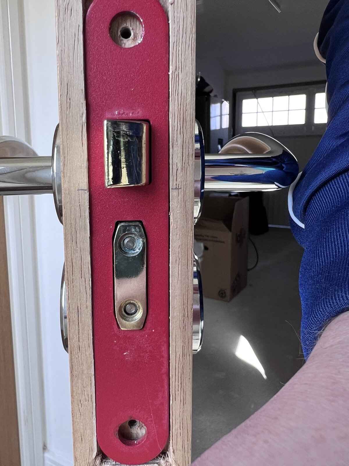

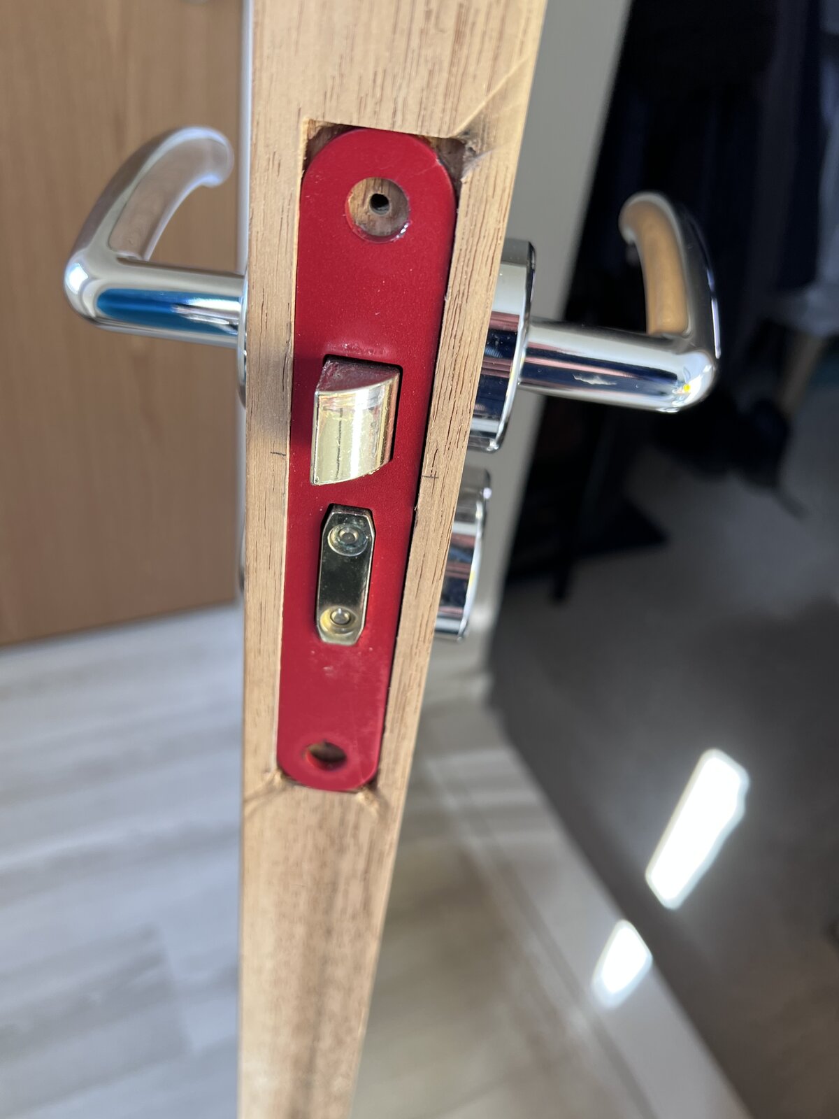

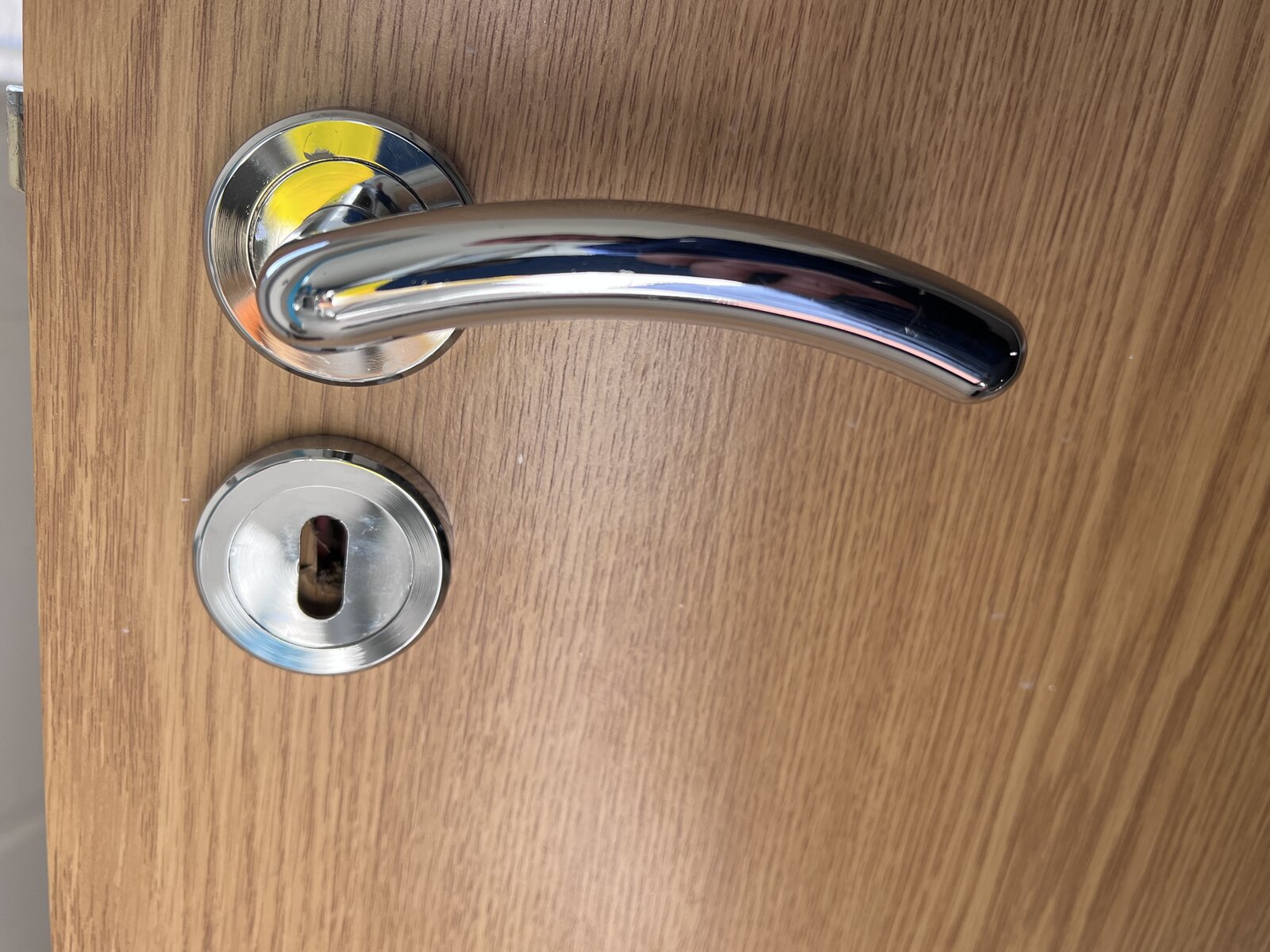

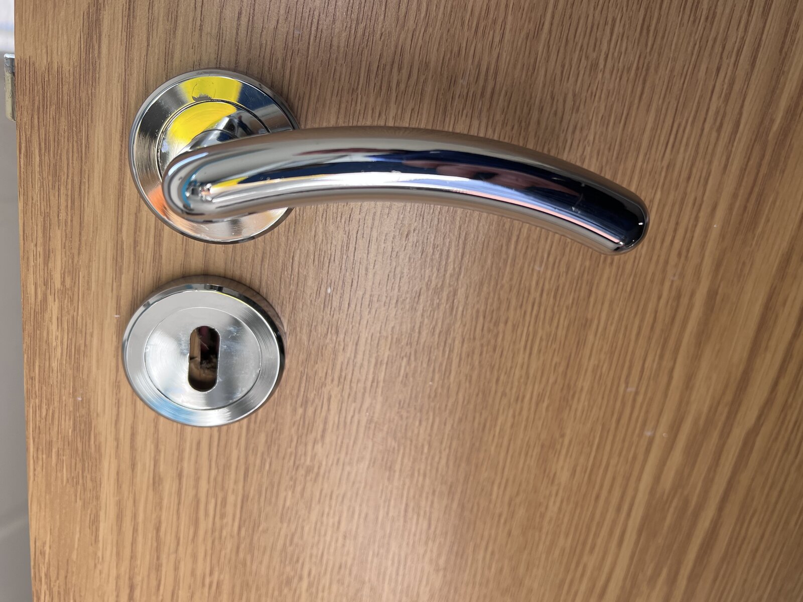

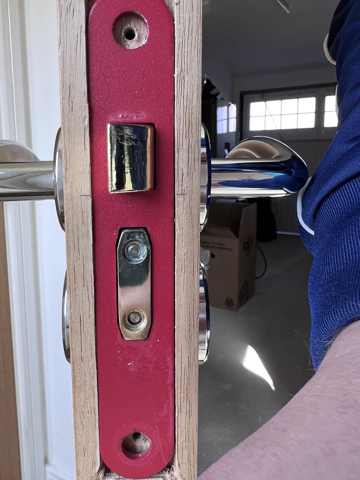

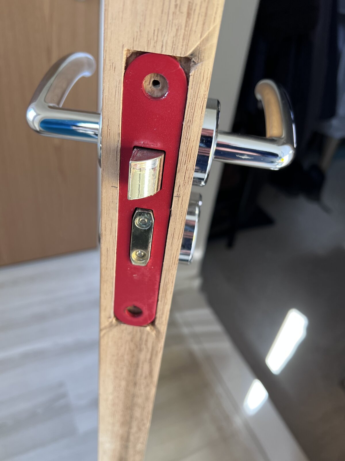

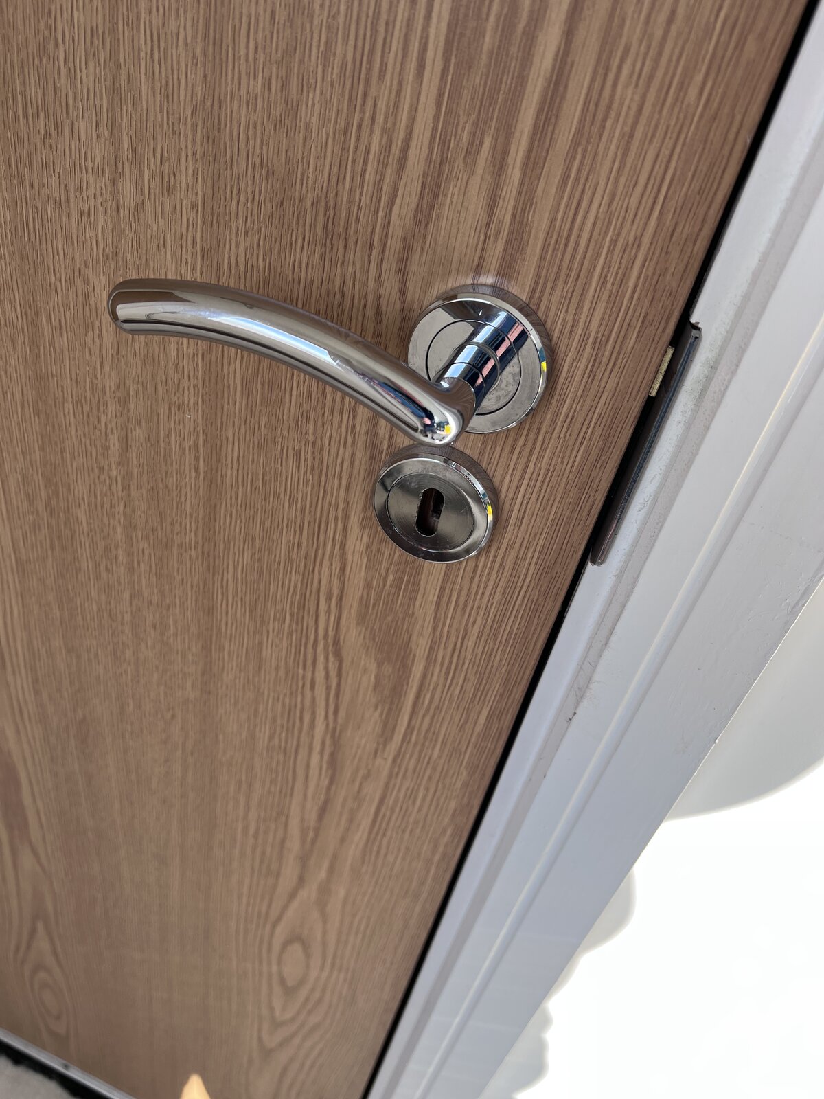

Here are a few pictures. I think it's as described by JohnD. I'll take a couple of screwdrivers to it tonight after work

The red plate is simply a cover plate and can be pulled off to expose the lock mechanism.
One of the door handles has to come off. Typically an Allen key is needed to loosen a samll screw at the bottom of the round plate (or in the handle itself)
