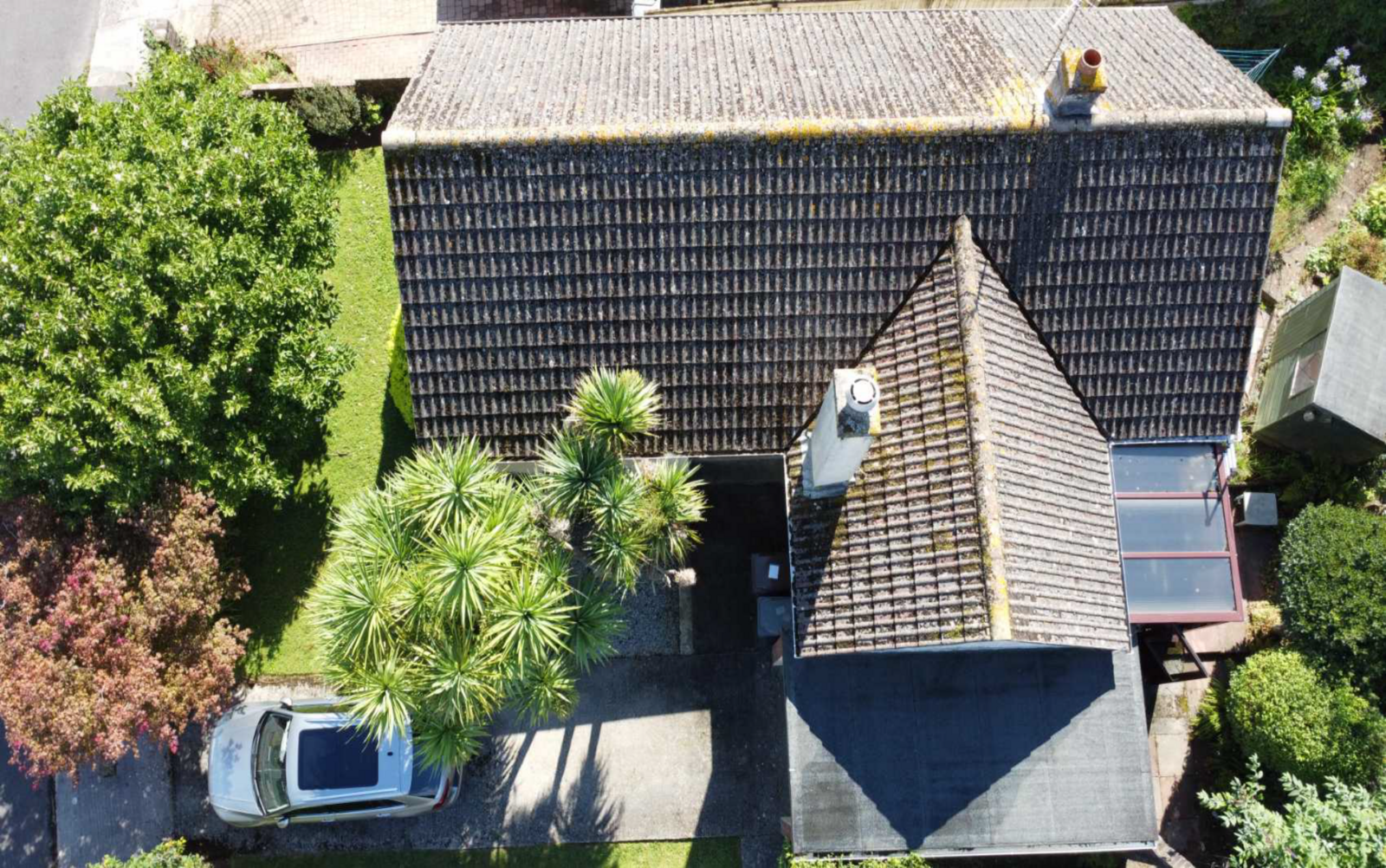

Hello
Looking to remove moss and lichen from a bungalow roof, the bungalow is detached so access all around is not an issue, the smaller section of the roof is accessible from the garage roof.
I am looking for a method if possible that does not involve walking on the tiles, something I can apply from gutter level would be the ideal solution.
Thanks in advance.

Personally I wouldn’t bother
If you treat it, it will still come back over the winter and die off during the summer.

Wet and forgot do a product you spray on
Patio Magic (which I have used) and Wet & Forget (which I have not) are basically dilute forms of benzalkonium chloride. Something like 7 or 8% and you dilute it down to 1 or 2%. I bought a lot of BAC 50, which is a 50% solution of benzalkonium chloride and use that on my rather ratty front yard.
NB Any moss killer will kill the moss, that is all, it will not remove the dead moss. On a patio the dead moss needs to be removed by brushing. On a roof it may be loose enough to blow away, but then it might not.

As someone else has said, applying chemicals will just kill the moss & lichen - it won't remove it. So the roof may end up looking worse than it does now, unless someone is prepared to get on the roof and physically remove the dead stuff, and that carries the risk of breaking or dislodging some of the tiles.
If the roof is leak tight I'd just leave it alone - if it ain't broke...don't fix it!

Dead moss will eventually dry up and weather away.
Yes, but no.
It depends on how well attached to the surface the moss is. We have a very tatty, tarmac front yard which I treated early this year, see
There was still some green (mainly places I think I missed) so I gave all of it another dose a few weeks later. After that everything was brown, however it would not easily sweep out, i.e. a broom would not shift it but a scrubbing brush would.
Had we had a long hot summer it might have shrivelled up and come loose, but we didn't and it didn't.
On a roof there it will be more exposed to wind & rain, plus there is gravity pulling it down, so it may be more likely to go without manual intervention.
