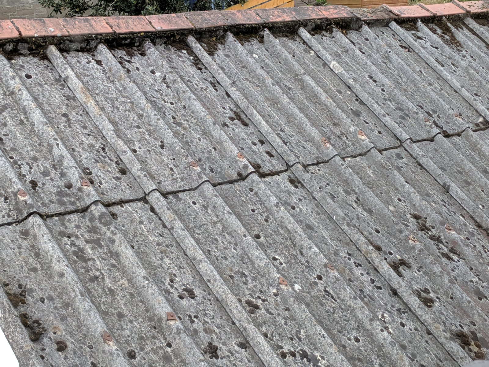

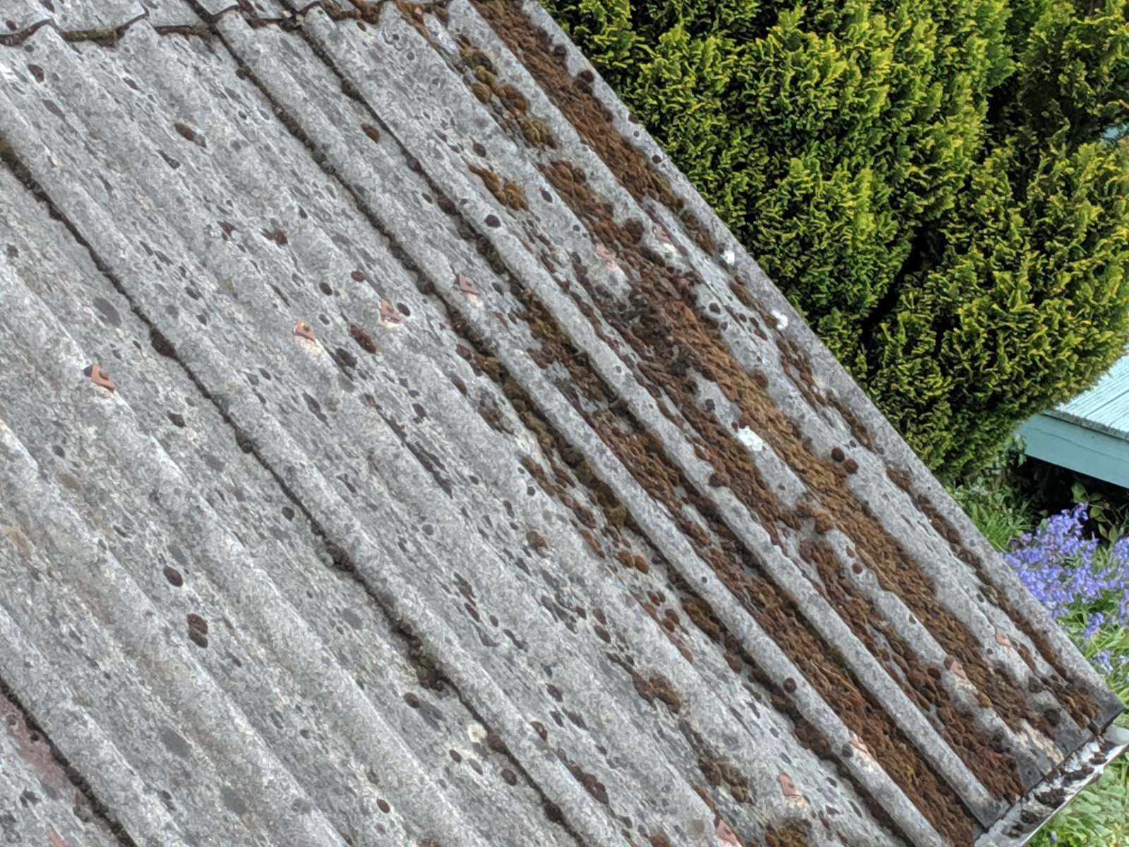

I've attached pics of more and less mossy parts of the roof. How tricky would it be to lay a copper strip or wire along the ridge?

No risk from roof unless you start cutting it or smashing it, causing fine dust .

One discussion I heard of [OK some time ago] was,
Moss growing on an Asbestos Cement roof will hold on to the roof by a small root system.
The discussion went something like if you scrape of the moss, the embedded roots [could ! ! ! ] ??? release Asbestos Fiber into the atmosphere.
Ok that view could be looked at as being ultra cautious, also given the operation is occurring outside, any breeze will dissipate whatever small volume of fibers are released by prizing of the moss?
