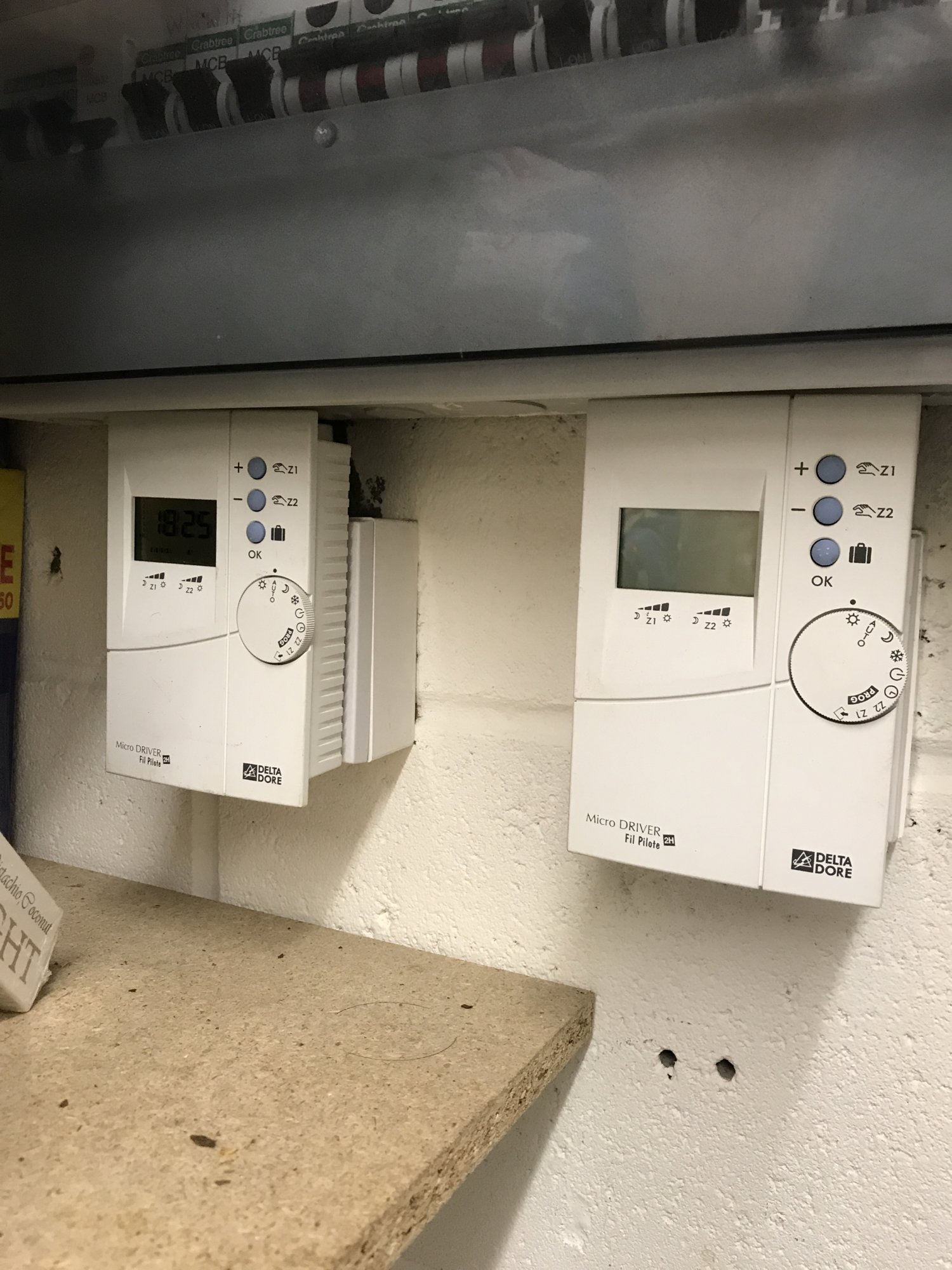

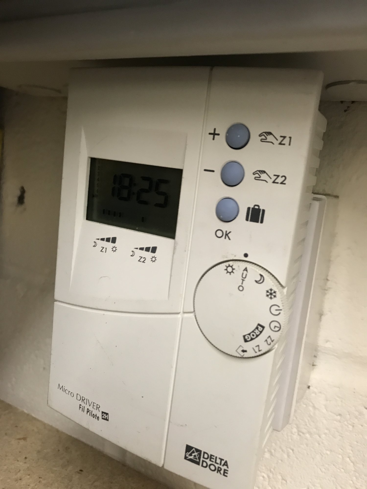

In the garage, near the power circuit unit, there’s two timers. One is on and the other is not powered up/off completely
The one that’s on, we have it constantly on daylight mode. Tbh we’ve no idea how to work it and we were simply advised by the landlord to keep it at that.

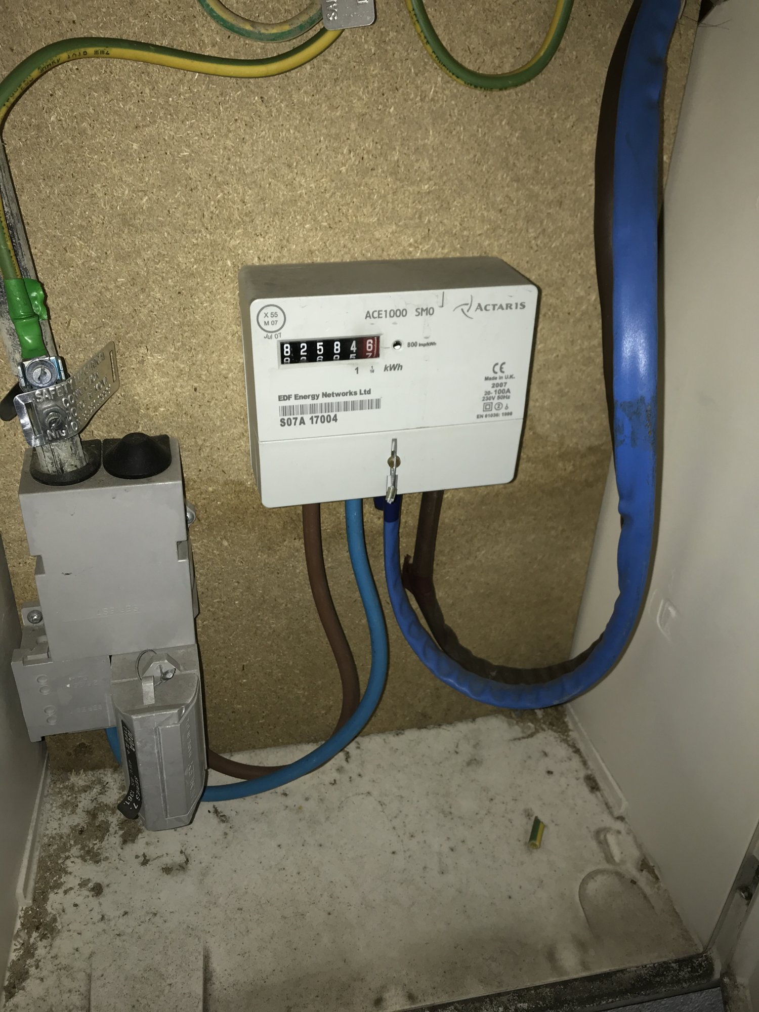

Finally, I’ve read on how this water heater is good for use with economy 7 meters as the bottom half can be set up to heat the water at night while rates are low. However, checking my meter it seems that I don’t have an economy 7 meter?

Your cutout main fuse unit is upside down which is odd, but perhaps still meets the IP rating. What isn't right is that there's a water pipe bonding clamp on the outside of the cable, presumably to provide some kind of tn-s earth from the sheath. That needs correcting by the electricity company.
Regarding the efficiency, with electric heating on a single rate it'll be expensive whatever. Try to get economy 7 fitted?

If you want to keep your bills down, then I'd suggest you move house. You can fit economy 7, but it the electric heaters aren't storage heaters, and just panel heaters, then you'd be paying a higher rate to heat these during the day, just to get a cheaper night rate for the hot water. Your heat and boost arrangement suggest you had economy 7 at some stage, and that you would have had storage heaters as well, but when they've changed them for panel heaters, they've taken out the economy 7 rate.
