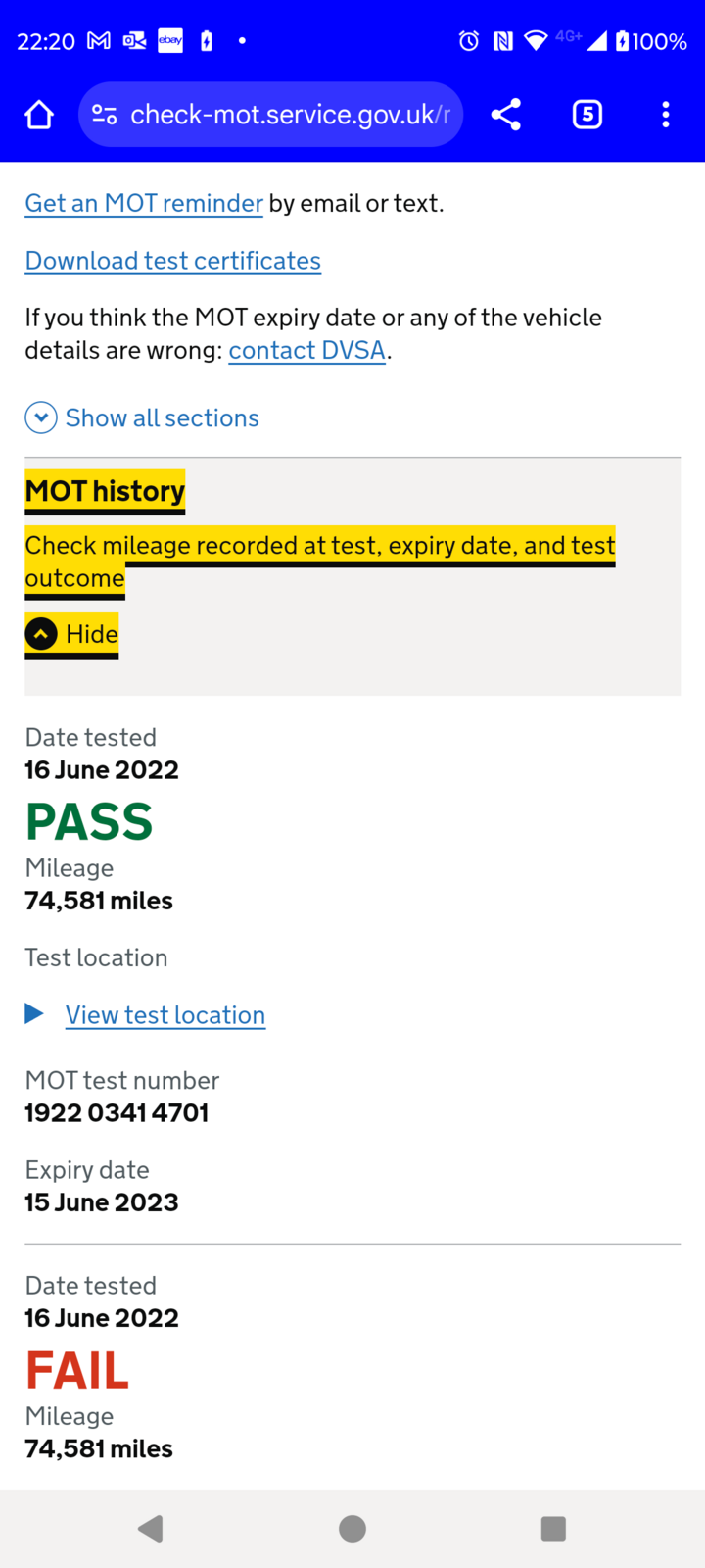

does it have to work ? and will 300 mile since last year be enough?
Yes. 300 miles is no problem. My mum hardly used her car. One year she had only covered 40 miles and 26 of those were done by me bringing it back after one test and taking it in the following year. The tester won’t be concerned in any way about the mileage - it could even have 100,000 miles less than the previous year. All the tester has to do is record the mileage at the time of the test. If you didn’t give them the previous years certificate, how would they know what mileage it had last year?

There's been a recent update with the need to accurately report mileages.
The system gives a prompt if it feels the mileage is too low, too high, or the same as last MOT ( assumes Speedo isn't working).
The mileage can still be the same but the tester has to double check now.
Its all on a central database,
….that you don’t see or need to see, when registering a car onto the system for a test. Well, you didn’t when I was last testing 5 years ago but I don’t think it’s changed.

It only has to work at the time of the test. It is not checked for accuracy. As long as it records a speed as car is driven into test bay, or road test if needed.
It can pack up 2 minutes later and not be an issue
The actual mileage doesn't matter, as long as it is recorded accurately and re checked if prompted

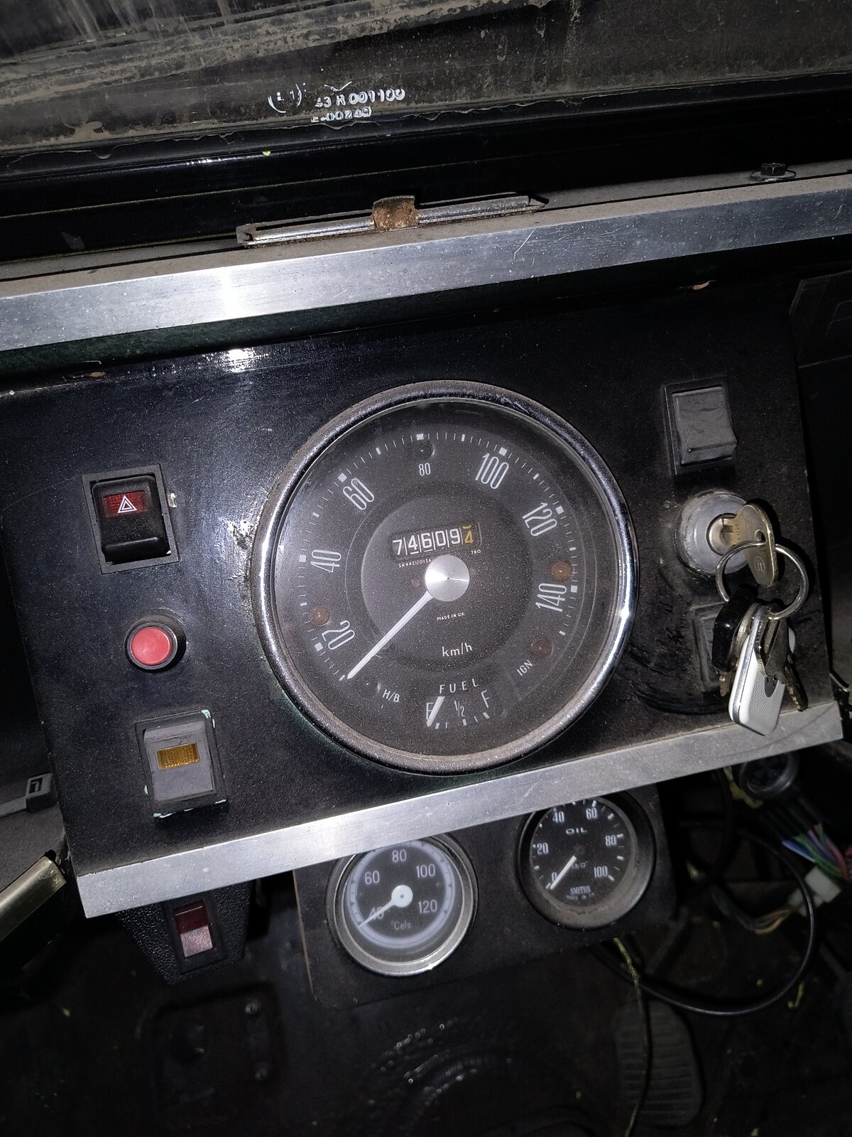

Out of interest, what would you testers do with this? It's been recorded as miles on the MOT.
