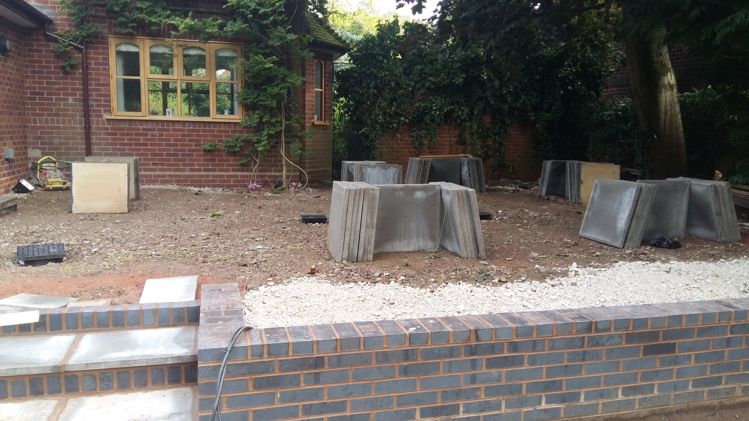

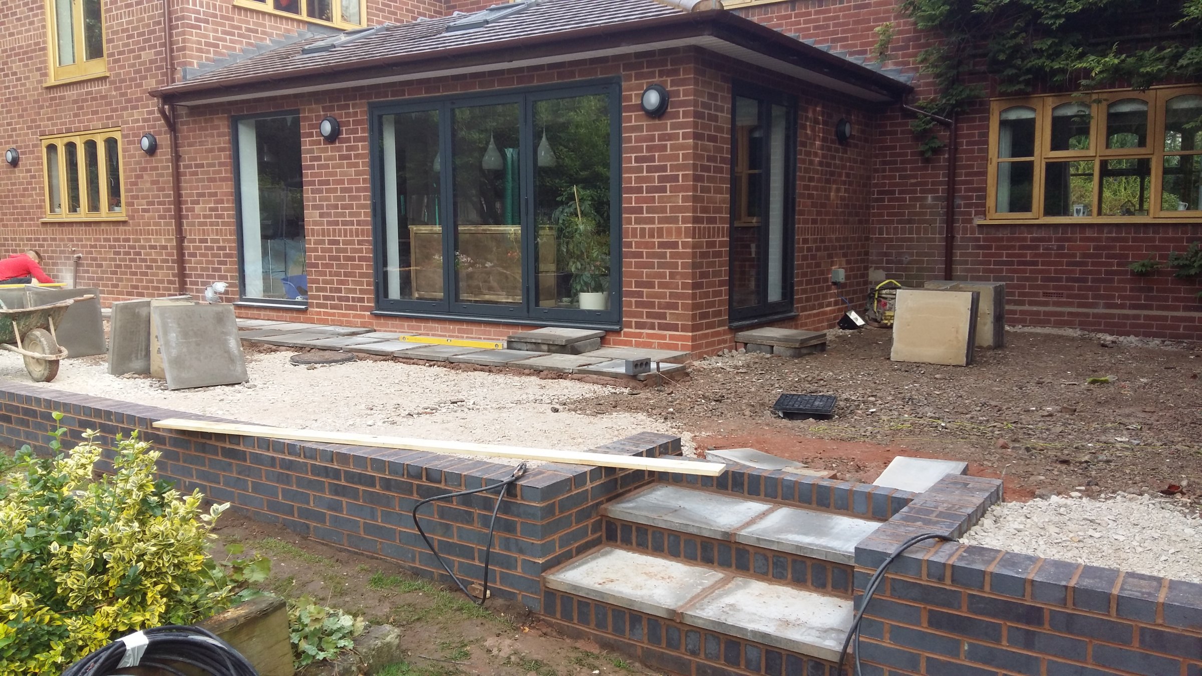

That looks really smart, nice job.
Is the hedge made of alternate oak and Willow trees? At least you know it's never going to move again!
