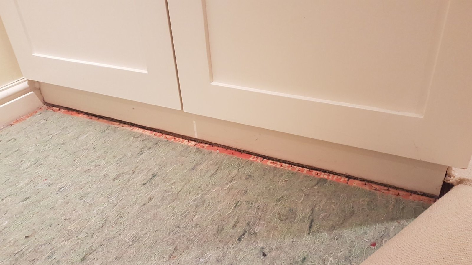

We live in a rented flat and have recently started having problems with carpet moths in one of the rooms. There is 100% fitted wool carpet everywhere, so perfect for them. When trying to find the nest we noticed what looked like rice grains near the fitted/built-in cupboard/dresser and pulled up the carpet. Apparently, there is a carpet square that's been left under the dresser, which is likely the source of the infestation (photos attached). Not sure why anyone would do this but here we are. Repeated treatments of the carpet square and the room itself with steam, insecticide powder and a permethrin-based spray haven't helped - the moths still seem to come out of that area. So, I thought we need to either remove the carpet square or isolate it from the outside.
Since this is a built-in dresser (no gaps on top or near the walls), it wouldn't be easy to remove it so that the carpet square can be extracted. The other thought I had is to seal the gap between the concrete floor and wooden dresser but I'm not sure what I should use - expandable foam? Silicone sealant? Also, the fitted carpet is meant to go into the gap underneath the dresser, so if I seal it, it wouldn't fit property anymore (not that it does now once we've pulled it up...). Would be grateful for any ideas.
I'd ask the landlord as you will damage the carpet doing anything.
is that a baseboard fitted after the unit is in there?
Rice grains.. Black? That's mouse poo
The landlord is aware but will not do or suggest anything unless we do it ourselves, according to our 4 year experience in the flat. Not sure I understand re: the baseboard - there is a baseboard that only goes up to the cabinet and then the cabinet itself is built in. There does seem to be a baseboard underneath the cabinet but it seems to be a part of the cabinet itself (the cabinet floor is level with the top of it). The rice grains were whitish, semi-transparent. Definitely not rodent-related. Plenty of moths on the traps to prove it's them. :D
I'd back the hole with nylon string, then apply silicone.
The string is only to support the silicone before it dries but no point adding "food'
By baseboard, I meant that many bedroom/kitchen units have the bottom front clipped on, so that adjustable legs can be used and concealed. because the left hand skirting board is cut at an angle, it looks as if it can be slid out
Thanks, I'll see what I can find in Screwfix - I've never used sealants before so not much experience there. In regards to the baseboards, I know what you mean - unfortunately it doesn't look like it can get removed easily - it looks like there is a square (or at least 2 sides/corner) of baseboards glued together and the dresser is placed on top of them.
What's in the cupboard? They must be eating something
I suffered tiny moths in my kitchen and it turned out to be a bag of flour that was the source
They seem to be eating the carpet. The cupboard has clothes in it but we've gone over the entire thing twice and there's no sign of them (yet)...
You could push back the carpet under the unit with a long tool. [wood chisel, bolster etc] then expanding foam , cut back excess .No trim needed as new carpet will need to tuck under a little.
Though your l/lord should deal with infestations.
The carpet square under the cupboard seems quite tightly wedged in - I think I might have difficulty pushing it in...will see what I can do. As I mentioned, the landlord won't take charge although he does reimburse us (not for the effort it takes to find/manage the handymen though!)
Should be simple to tuck the carpet back, should be hollow behind base board.

Get rid of the infested carpet under the cupboard. Easier said then done, but needs doing.

I'd make every effort to remove the peice of carpet under the wardrobe and bin the carpet and underlay if it was me.

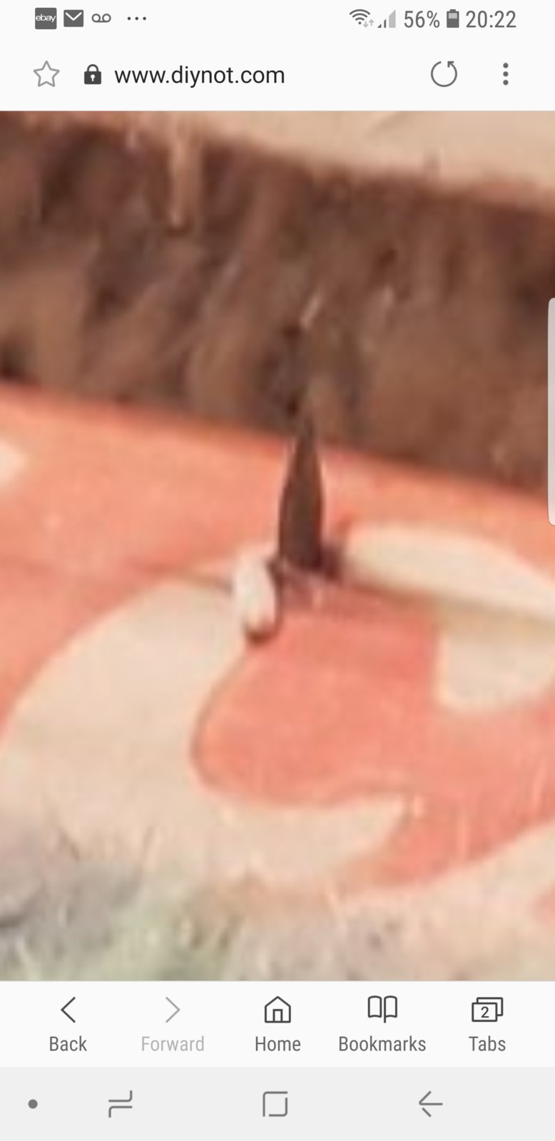

That's a carpet moth larvae, they look like tiny maggots..
Update - filled the gap under the cupboard with some Polyfilla and the number of moths definitely went down. Put up moth papers in cupboards and drawers, put clothes in bags. Vacuuming all the time, especially corners. Insecticide powder is still in the room corners, will vacuum up today. The Rentokil surveyor quoted something like £2800 for 5-7 weekly spray treatments of the entire flat, including heat treatments of clothes and woolens. Replacing the carpet in the bedroom that's most affected with a good quality synthetic would be closer to £1000. Landlord's decision but I'm not going to feel comfortable in a flat where most of the carpets are 100% wool...
BTW, that thing next to the nail in the photo ended up being a wood splinter, not a larvae...
