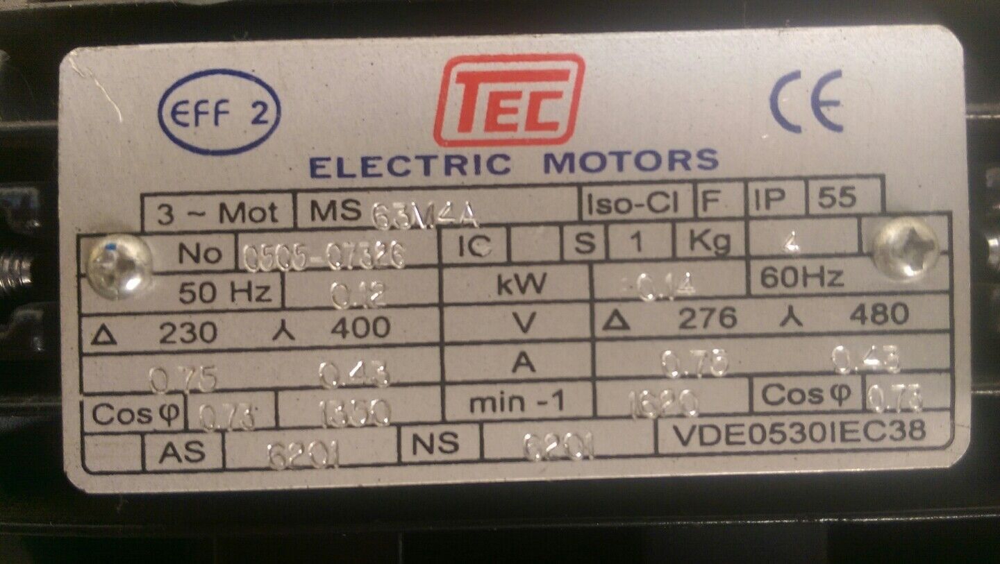

Been reading up on DOL starters, as needed for AM2.
I have a couple of questions please. For motors less than 4kW
Can a DOL starter be used for a star connected motor and a Delta connected motor?
Why would you chose one over the other. ( I know a little about the start up currents, and the start delta starter) This is particular to the DOL
Looking at some rating plates you get the following U220-240 D / 380-415 Y
This confuses me, as I would have thought the 320-415V would be delta and the 220 - 240 would be Star, as you have a 230 connection in star.
I thought delta was 400v? Poor misunderstanding on my part
Any help would be great, thanks

I'm not sure I understand what you are depicting. However .....
With 'star' connection of the windings, one end of each of the three windings will be connected together at the notional 'neutral' point, with the other ends of each winding connected to one of the phases of the supply. There will therefore be 230V across each winding.
With 'delta' connection, the three windings will be connected together in a 'ring', with each of the three 'connection points' connected to one of the phases of the supply. There will therefore be 400V across each winding.
Does that help?

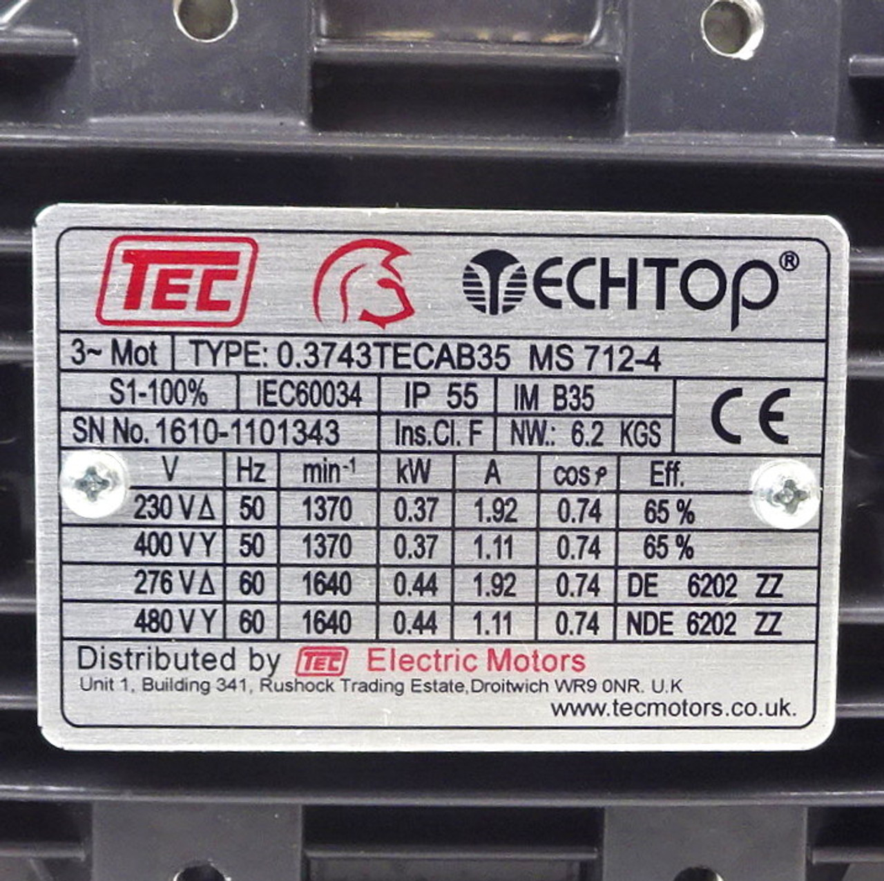

I would interpret it as the motor rating plate is telling you how to wire up the motor depending on the supply you have.
Three phase supplies are normally quoted by the voltage between phases. If you have a supply with 400V between phases you should wire it up in Star. If you have a supply with 230V between phases you should wire it up in Delta.
Supplies with 230V between phases are basically unheard of in the UK, but I believe they are sometimes encountered in other parts of Europe.

Where there is more than one voltage figure listed, the delta (△) connection is the lo-voltage connection, while the star (Y) configuration is for a high-voltage connection. The wiring diagram for both delta and star configurations will often also be added to the nameplate.
