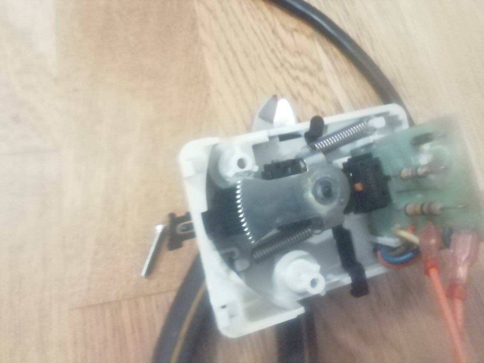

no the teeth on rack wear out or break, the microswitches can stick the plastic leavers can snap . there is several things that can go up with a head other than just the motor

considerable stress my ar5e you can see the size of the springs which you clearly have no clue how big they actually are .
no they are made out of shyte materials now in the past a honeywell valve would never have teeth worn or broke , explain how the springs cause a micro switch to stick and how plastic components break by people being heavy handed .

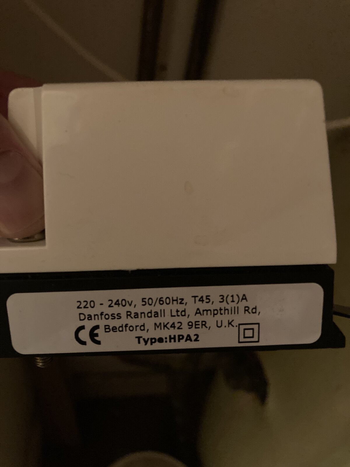

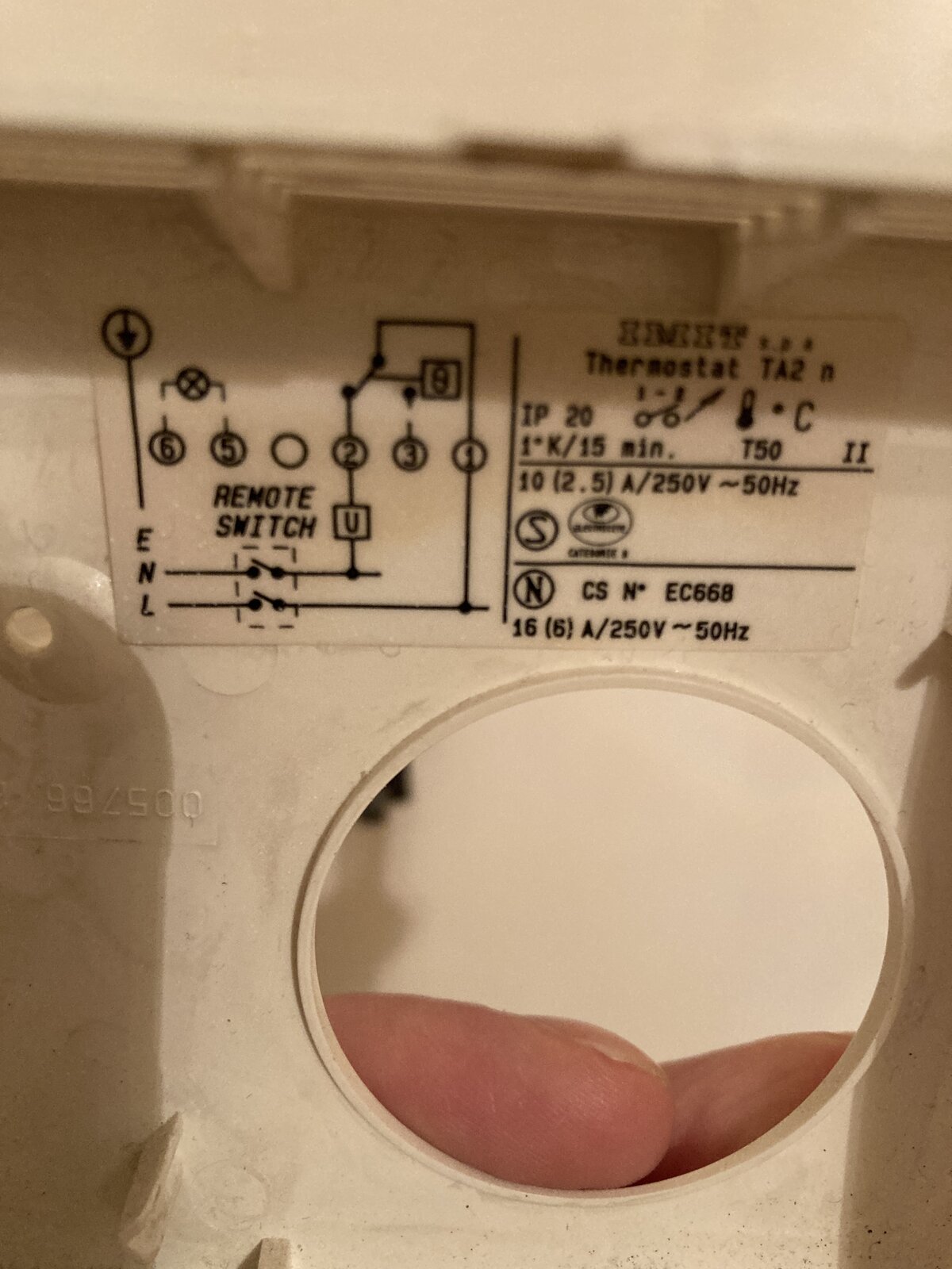

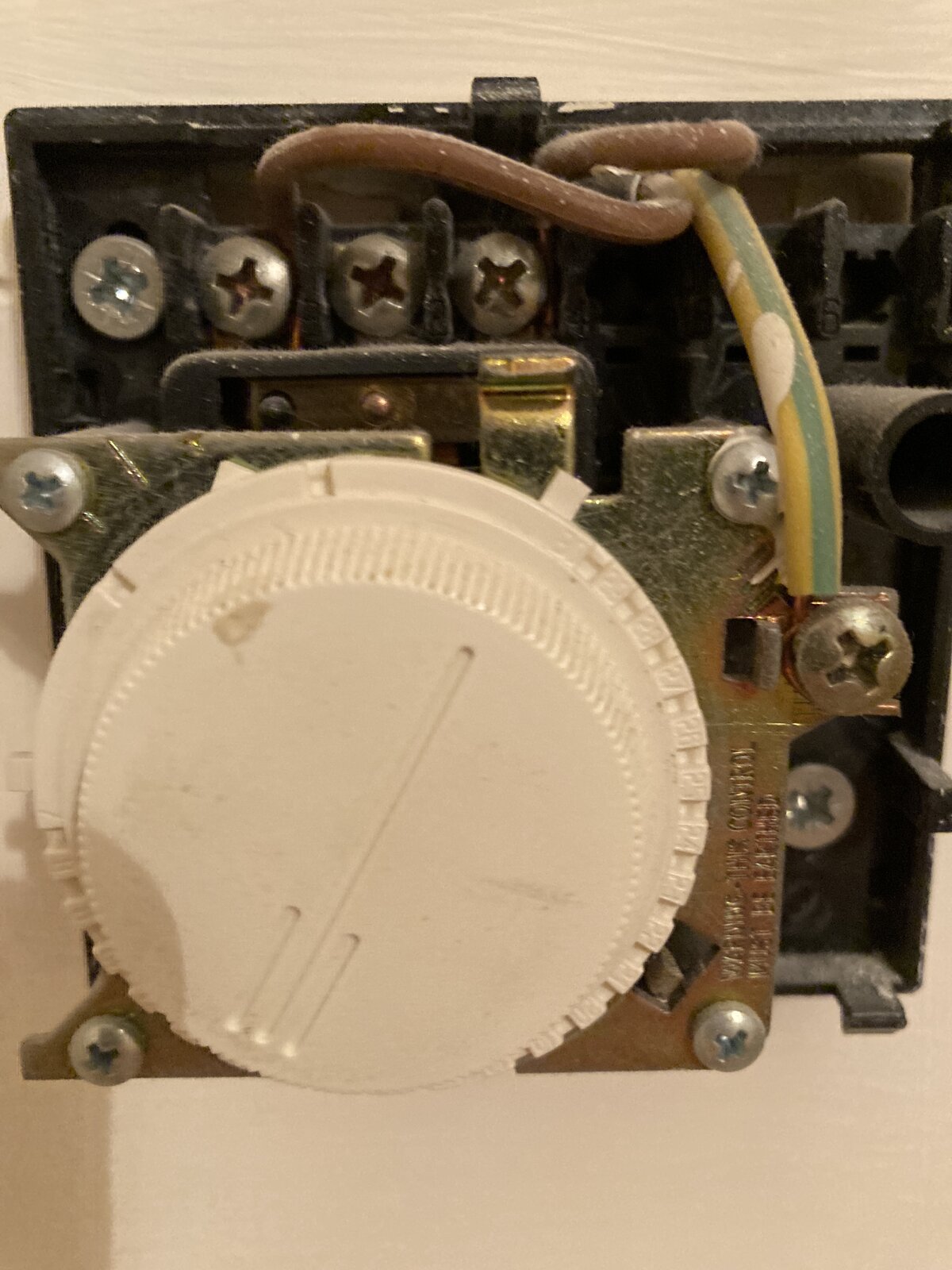

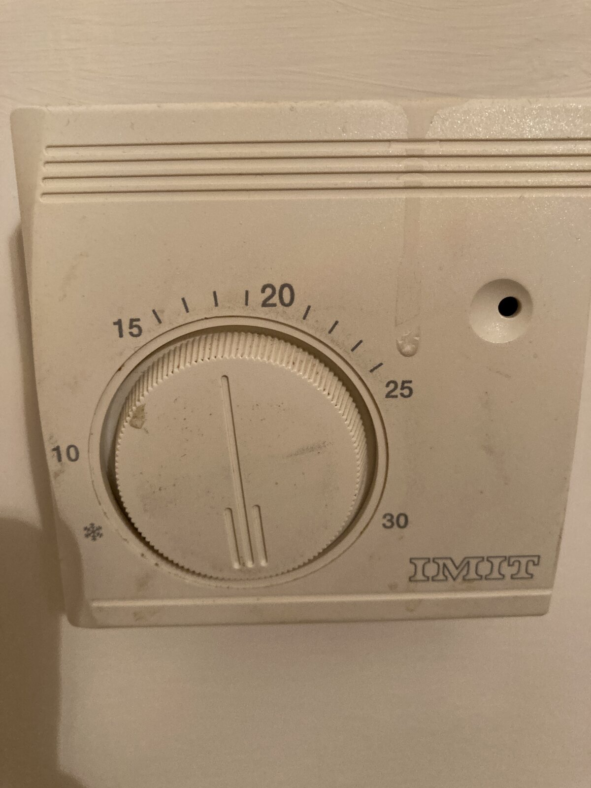

Hi again. Thanks for the info. Just to update, I have included a few photos. The actuator is the problem. When we arrive in the apartment I put the Horstmann time clock to 24HRS, the boiler fires up and usually the radiators stay cold until I move the lever on the Danfoss HPA2 actuator to manual and the hot water eventually makes its way around the radiators. I removed the actuator and checked the valve underneath and the valve can be opened & closed easily with my finger & thumb. The actuator itself can get quite warm when getting the signal from the thermostat to open but it isn't opening. I have bought a new actuator which i intend to fit at Easter with the help of my wife's uncle who is a qualified electrician. I'm wondering should i replace the thermostat as well. The current one is an IMIT one (see pic). It's wired as per the 3rd pic. Going from left to right is 1,3,2,4. The signal from the time clock comes in to 2. If the temp is below set point, 1 becomes live and send signal to Danfoss actuator which sometimes only opens less than half way and radiators stay cold.
When i search for an IMIT stat they only seem to be available from Germany. I saw an ESI one which looks very similar so can anyone recommend a suitable replacement? I would like one which would be a straightforward replacement if possible. BTW, only the lives and an Earths seem to be connected. Is this right? Wiring details included.Like i say my wife's uncle should know but I don't want to be wasting his time with a stat that's completely wrong. Thanks in advance.

If the wall stat clicks cleanly, when adjusted from minimum to maximum - at approximately the correct temperature - then it is likely absolutely fine. Therefore no good reason to change it.
My apologies for the previous poor signal to noise level.
Yes it does click audibly when adjusted from min to max so probably more hassle than it's worth to change it. Just wondering. Cheers Harry.
