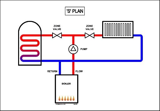

I HAVE 2 VALVES, 1 IS THE PLASTIC COVER DRAYTON COVER ONE AND THE SECOND IS A METAL LOOKING 1 AND DONT KNOW WHY THERE IS A SECOND?

If they are two port valves, one will be to control the central heating and the other will control the hot water. It's known as a 'S' plan.

thanks for that, things seem a little more clearer now. But i never see any movement from the second valve (silver one). Only from the white valve. when the heating/wter comes on!!

You worry me slightly now you say that one valve moves with the water and the heating and the other valve doesn't move at all. Are both of the valves 2 port?
or 3 port?
yes they are both 2 port. I always only see the one to the left move when it is turned on, the swith on the silver box on the right does not move but seems to vibrate as if it is on??
does the pipe get hot on bothsides of the valve ?
when the valve is open the lever on the end will have no resistance.
