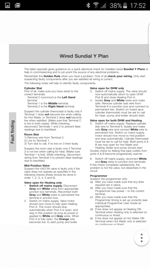

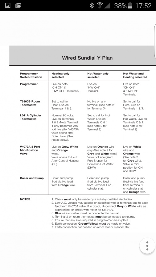

First you need a multimeter
Then you need to follow this guide.
It's the only way to diagnose the fault with 100% confidence
