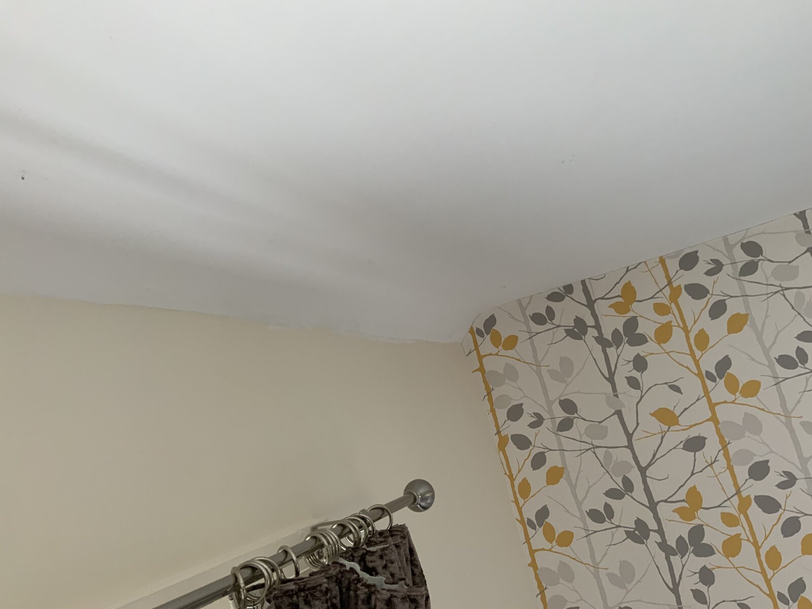

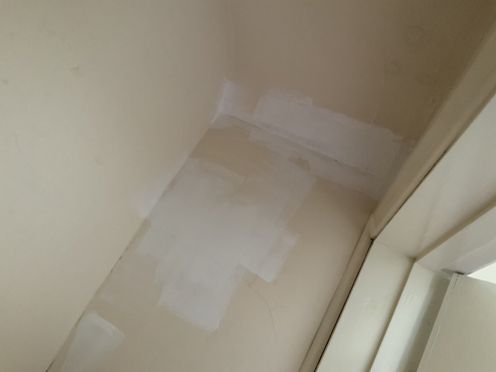

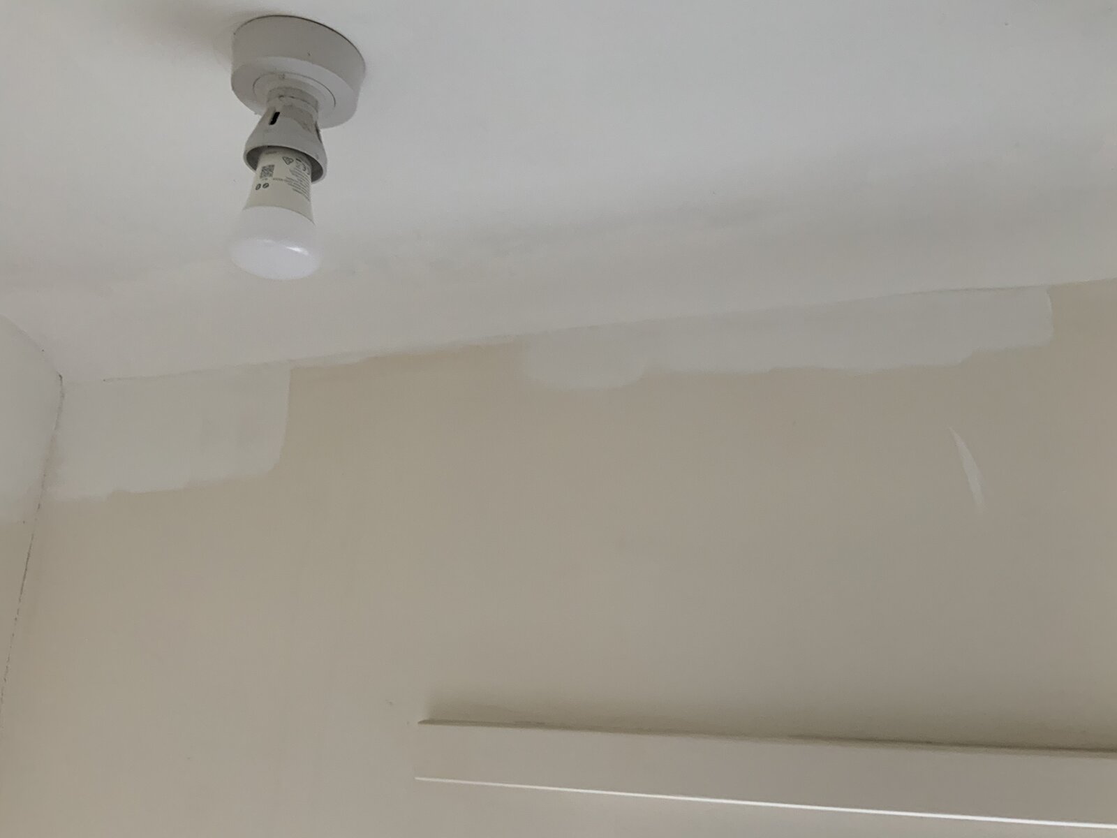

Sorry here we go.
As you can see I have put some anti mould paint on to stop it and almost within an hour the rooms smell better.
It’s the slanted bit where we seem to get mould, I wonder if lost insulation would actually warm this bit up.
I cannot currently get in the loft but should I need to I can climb to work out how much if any insulation is already there

Lack of insulation creates cold spots mould prefer, but lack of adequate ventilation allows it to spread.
Do you dry clothes indoors , guarantees mould.
