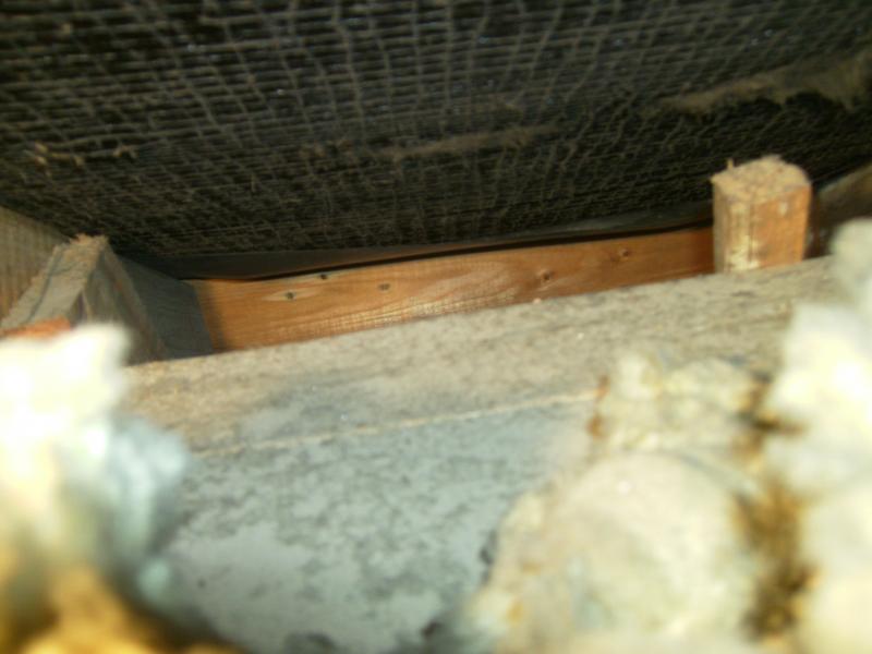

I have been up in the loft today and managed (just about) to get a look at what is above this room. The other rooms bar maybe one (there are 5 in total) would be very difficult to get to. As far as I can tell, there is no block to the vents, which are situated around the edge of the house, think they're called eaves? Here is a picture, which doesn't show it well, but there is a big gap between that wood at the back the foremost edge. So I don't think it is a draught issue.

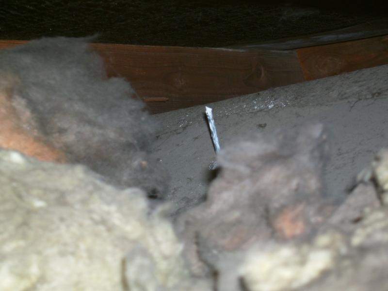

As you can see though, between the edge of the wall and insulation, the plasterboard is bare. I saw this in the few places I could get access to. I also saw a big un-insulated patch where the biggest mould patch is on one of the ceilings here:
Ignore the pin, that was put there by me so I knew where to look when up there. That picture doesn't fully show it but that whole area behind the air heating pipe is not insulated and that is where it is mouldy. You can see though that area is not insulated

it could be that the areas arent insulated causing cold spots underneath, then condensation, or it could be the draughts coming up through the eaves in your pictures are cooling and wicking away the heat from the ends of the insulation, i would stick a plastic bag over the ends of each roll of insulation like a sock to stop this, black bags are cheap and it may magically solve your problem, worth a shot, ive seen this problem in a few houses where by use of a thermal camera shows a fully insulated attic right up to the eaves, can have a cold perimeter because the eaves ventilation is stripping the heat from the ends of the insulation, let us know how you get on

I am certain it's the insulation. The outline of the mould is exactly the same as the bits that aren't insulated. However, it's impossible to fix this because I just can't get in to the tight spaces where there is no insulation.
