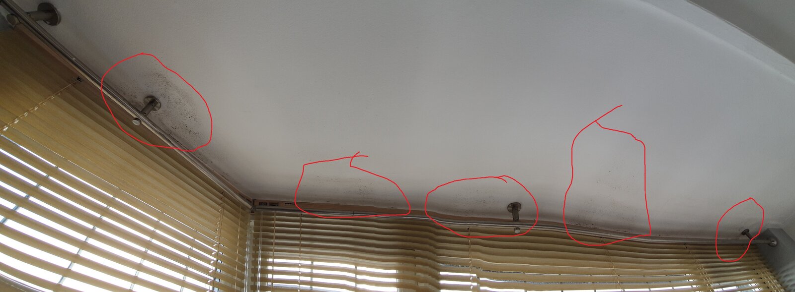

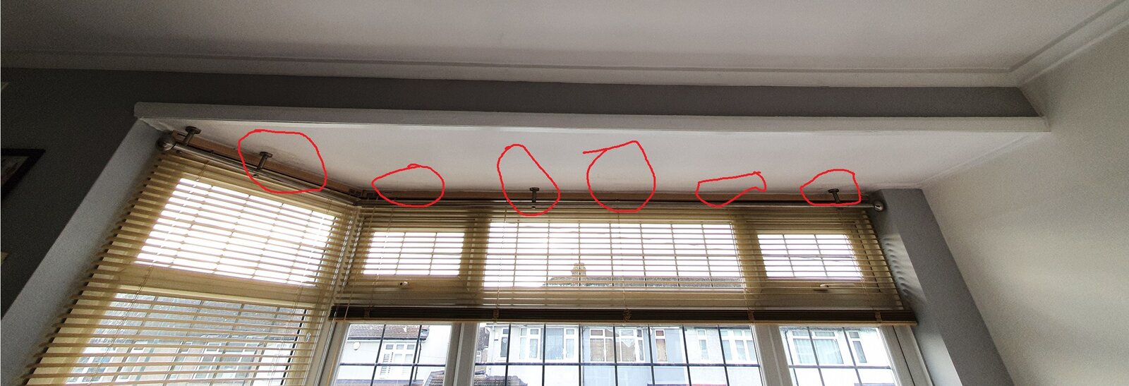

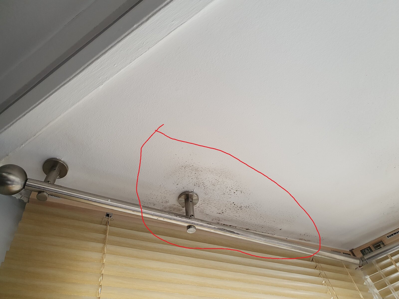

Hi,
I'm having mould growth happening on this part of the ceiling. It's the front facing bedroom which has a flat roof above. I live in a mid-terraced house.
Any suggestions what is causing this and what can be done to get rid of this? I've used mould remover, but it just keeps coming back.
The paint is also flaking now. Should i paint it with a gloss paint so that I can wipe it down in the future (although a gloss paint would smell for longer making the room uninhabitable for my kids)? or is there something else which can be done for a permanent solution to this.
TIA.

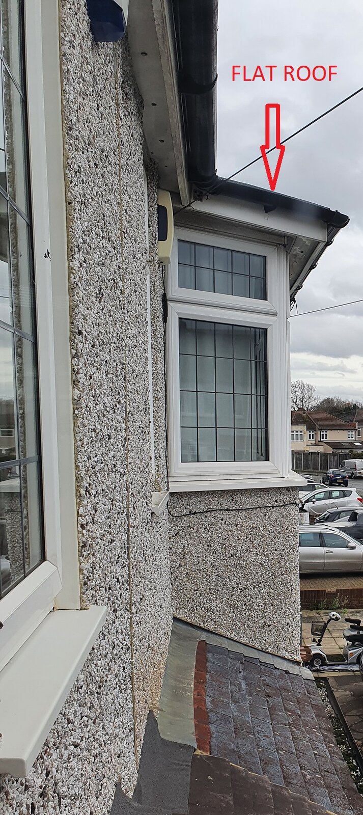

Does the flat above also have a bay immediately above yours, or does your bay protrude from the building and have it's own roof, something like this?
This is on a first floor. There is just my roof over me. However, this part where the issue is, is protruding from the facade and the top is not tiled. It's flat and I guess there's this bitumen felt on it.

Most likely, that is the coldest point on the ceiling and you’re getting condensation.

Re-felting might be appropriate if there is a leak. But if the issue is that it is cold, you need to add insulation.
Probably a lack of insulation in the flat roof, so the ceiling gets cold, condensation forms and then mould.
Is there a radiator in the bay? Keeping the heating on all the time might help keep the ceiling warm and dry enough to prevent future mould growth.
Only long term solution really is to ensure the ceiling / roof is insulated enough to prevent condensation.
That's what I suspected and why I asked the question, because I had exactly the same situation in a property about 20 years ago. I cured it by making a 4 small holes in the ceiling above the bay and injecting a couple of cans of expanding foam through so that it filled the void between the plasterboard and roof and acted as insulation. That's probably not an ideal way of doing it and I'm sure it might have caused a problem later down the line if it ever has to be gotten rid of. The professionals on here might be able to offer you a erm...... professional solution.

If there is a leak then that would need to be sorted first, but looking at the distribution of the mold it looks more like it's caused by condensation.

You appear to have a downpipe and gutters where the mold is, have you checked its not blocked.
