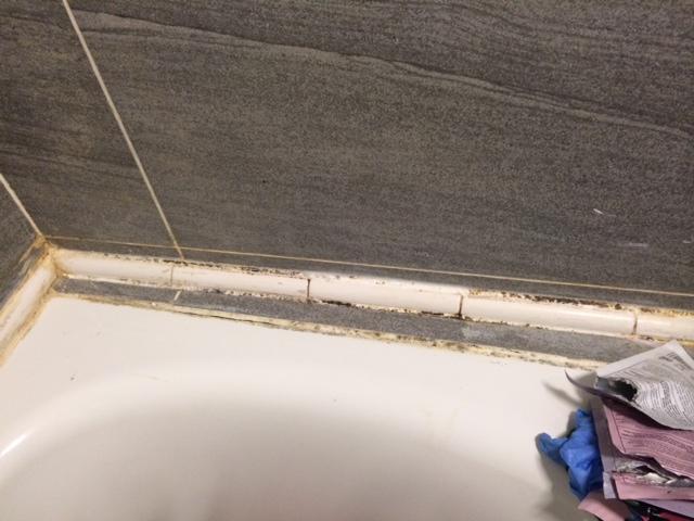

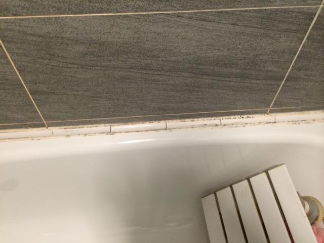

Hi all
I have an issue with this mould appearing on my bathroom
unfortunately my regular builder is no longer around so i need to do something myself for a change!
can anybody kindly please give me some tips on what is required to stop this black stuff keep appearing???

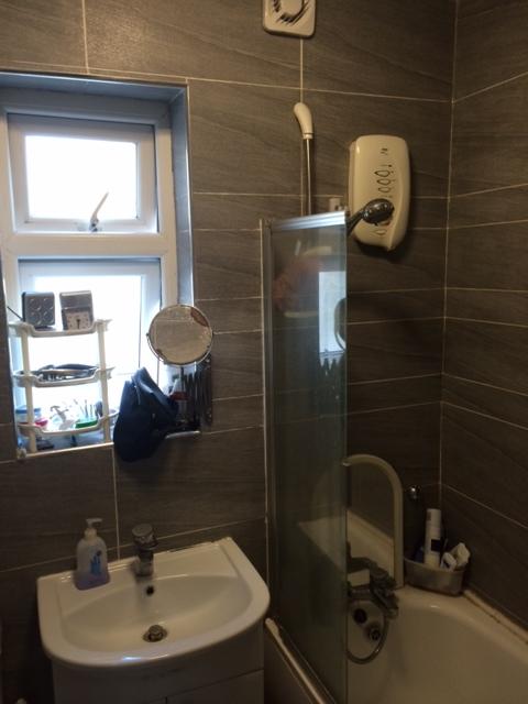

i have a small window which i always open and a fan (above shower) which comes on with the light.

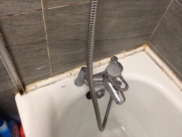

there is even some mould to the right of the sink tap if u can spot on the last pic!
Is the fan fitted with a timer? It should be! It is also too near the shower head, unless it is a 12v type.
Also, give the bath/shower a wipe around every time it is used.

i actually dont use the electrical shower anymore anyway - the water supply in my area isnt great - i prefer to use the tap shower head instead and just use the higher stand :)

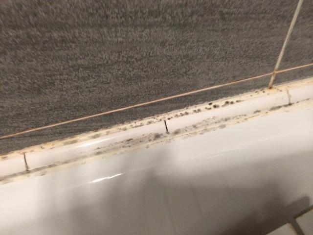

is it just a condensation issue tho?
im just wonder if it was anything else
for example are those little white curved edging tiles he has used the problem...or the silicon he used etc etc etc
Make sure you are using a bleach based cleaner for the bathroom (I use the white cilit bang).
We kept getting this in our flate until we switched to bleach.
If you use the fan with the window open, the air will come in the window and out of the fan, with most of the air in the room never moving.
There should be a gap under the door so that air will enter there and travel across the room and out of the fan, window being closed while the fan is in use.
Bathroom needs a permanent open vent as well as a fan that runs with every use [not just when the light is needed] only adequate ventilation will keep the air containing the spores moving so they don't settle on the surfaces.
No area of the bath should have bottles , sponges etc left in place for days as this also prevents air movement.
