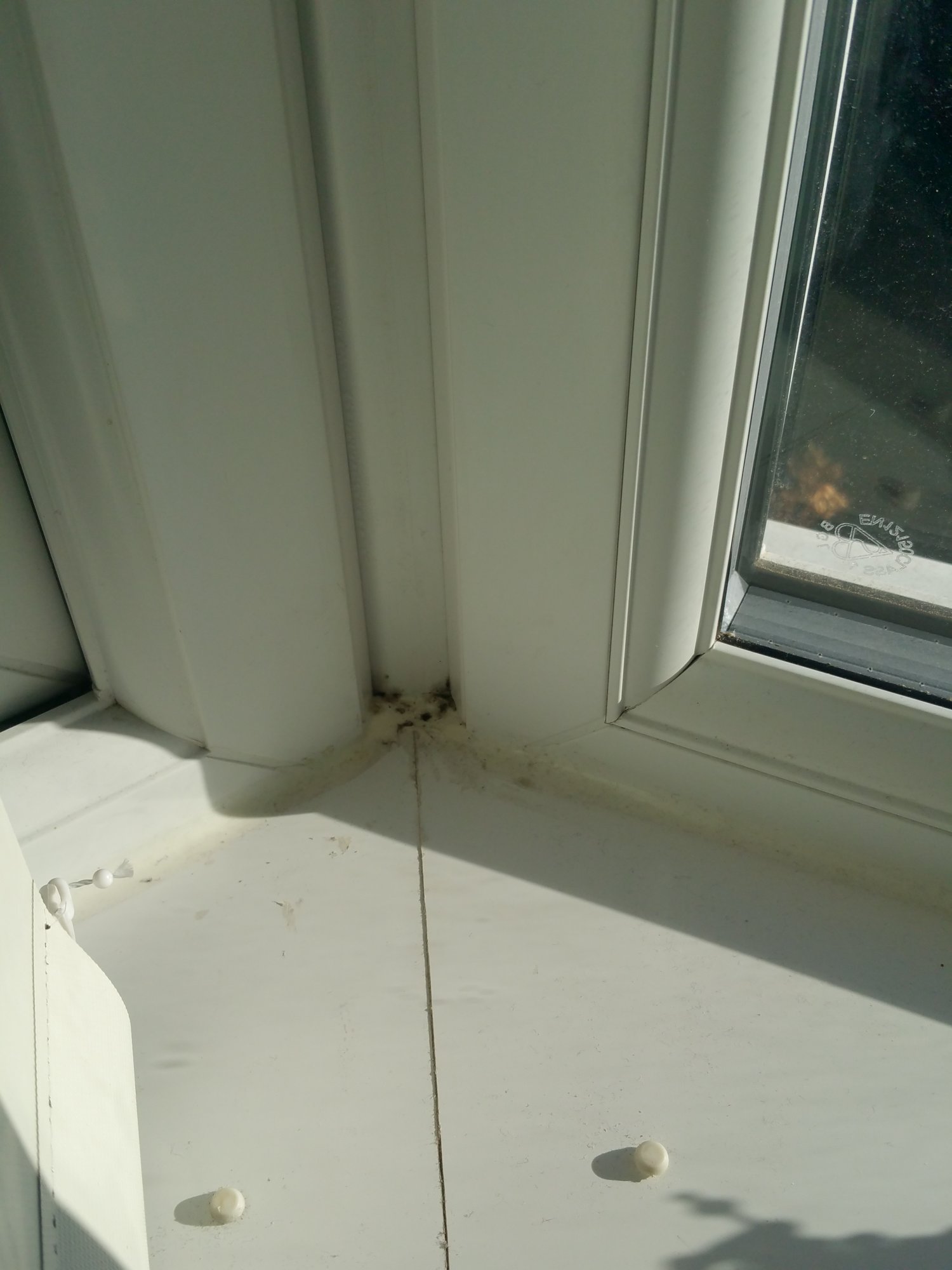

Hi
Have had new windows fitted about 6 months ago and there seems to be mould at the 2 corner joints of the bay window. I saw amall droplets of condensation just above where the mould patch is.
Should I take off the silicone and fill with expandable foam and then reseal? Any help would be greatly appreciated.
Mold spores collect where is damp and lacking ventilation . Do the new windows have trickle vents , are they open.?

When I moved in to my property I had exactly the same issue as this only far worse. At the bottom of every bead of silicone on the frame would be a patch of black mold and in some places it started climbing up the seal.
If there was silicone I could remove I did so and replaced with a bead of top-quality anti-mold silicone (for use in bathrooms, etc.) If there was no silicone to remove, I killed the mold and wiped down with bleach.
It's just one of those things. It got worse after I insulated the bay window wall because the warm air couldn't condensate on the new wall which is warmer. It had to find the next coldest surface which is the window frame/glass. Trickle vents are in my view absolute carp (only good when new). Steps such as windows open on the latch and locked throughout the day, a strong bathroom extractor fan and NO drying clothes in un-ventilated rooms solved it for me. So long as you can stop warm,moist air settling on cold surfaces you should not get mold like this.

do you have extractor fans in kitchen and bathroom? no drying clothes in home?

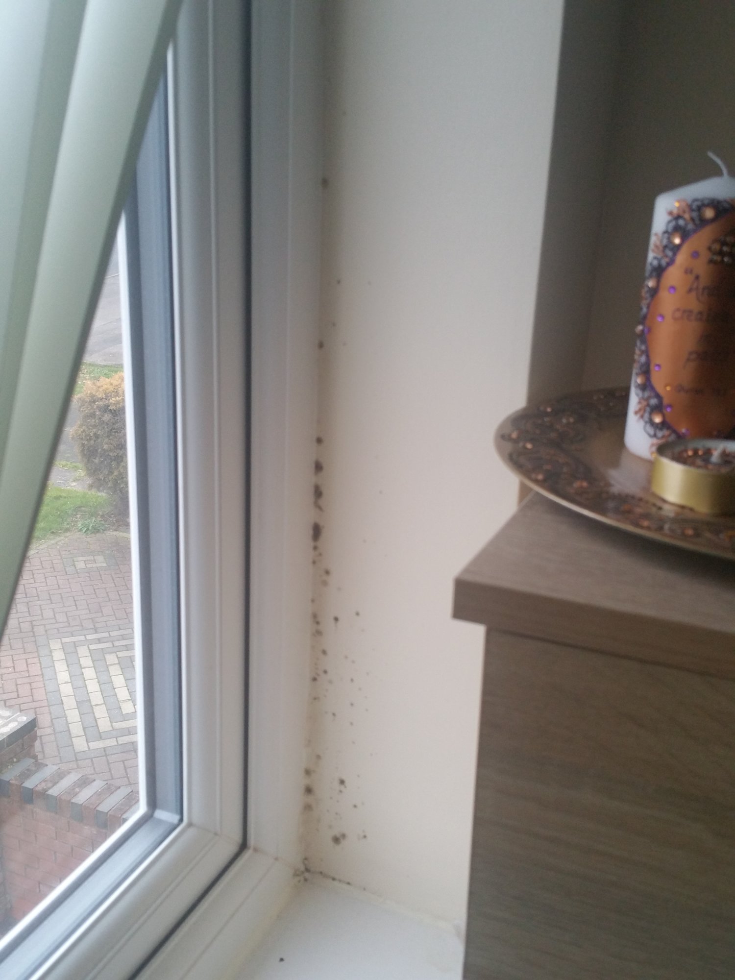

Yeah both. Got really good ones when renovating a year ago. I think the previous occupants never opened windows as when we moved in, there was damp on walls and ceilings. I got a humidity meter and it shows quite high readings. The mould spots are on allot of the windows and on the wall around the windows.
Any vents in the rooms apart from tricklevents, what style of property is it?

I'll take ur advice and use high quality silicone to replace affected areas.
