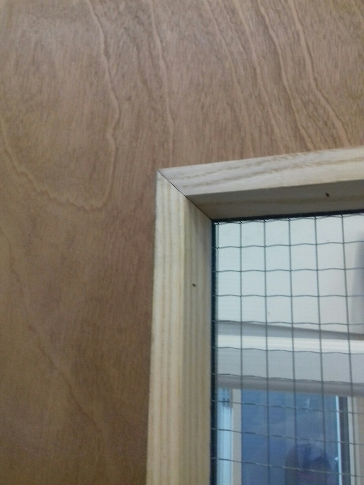

I have a door with a wooden moulding that makes up the window frame - anyone know the name/type of moulding - google isn't helping me :(
it just looks like rectangular stripwood. You buy it by the section dimensions, e.g. 12x18mm
Measure the old, and the stuff in the yard, because "nominal" size may not be what it really is.
some examples
http://www.wickes.co.uk/search?text=stripwood
a real woodyard may have a larger range
Thanks for the reply, its not standard 15mm flat on the door, 25mm against the glass - however the 25mm part has a slope of about 30 degrees.
'mmmm
you might find it, if not, you'll need a plane.
a door supplier might possibly sell it.
Thank you - "door supplier" been looking in the wrong place - its called Glass Bead I've been searching mouldings.
