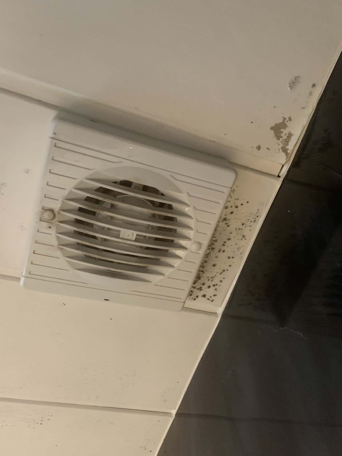

Hi guys
As in the title, I have a mouldy bathroom. I’ve replaced the extractor fan a while ago with a Manrose VXF100LVS which has a rate of 85m³/h but it doesn’t seem to have made any difference from the last Manrose fan. The main reason I chose this one was ease of replacement.
My picture shows that the mould gathers around this area (also there’s a line directly where showering takes place, and around other various edges of the room. I’m wondering if this is lack of insulation, or with the extractor vent being out there and there are slats which have broken off.
Can anyone please advise so that I can replace the fan correctly?
The room is approximately 6 cubic metres.
Thank you!

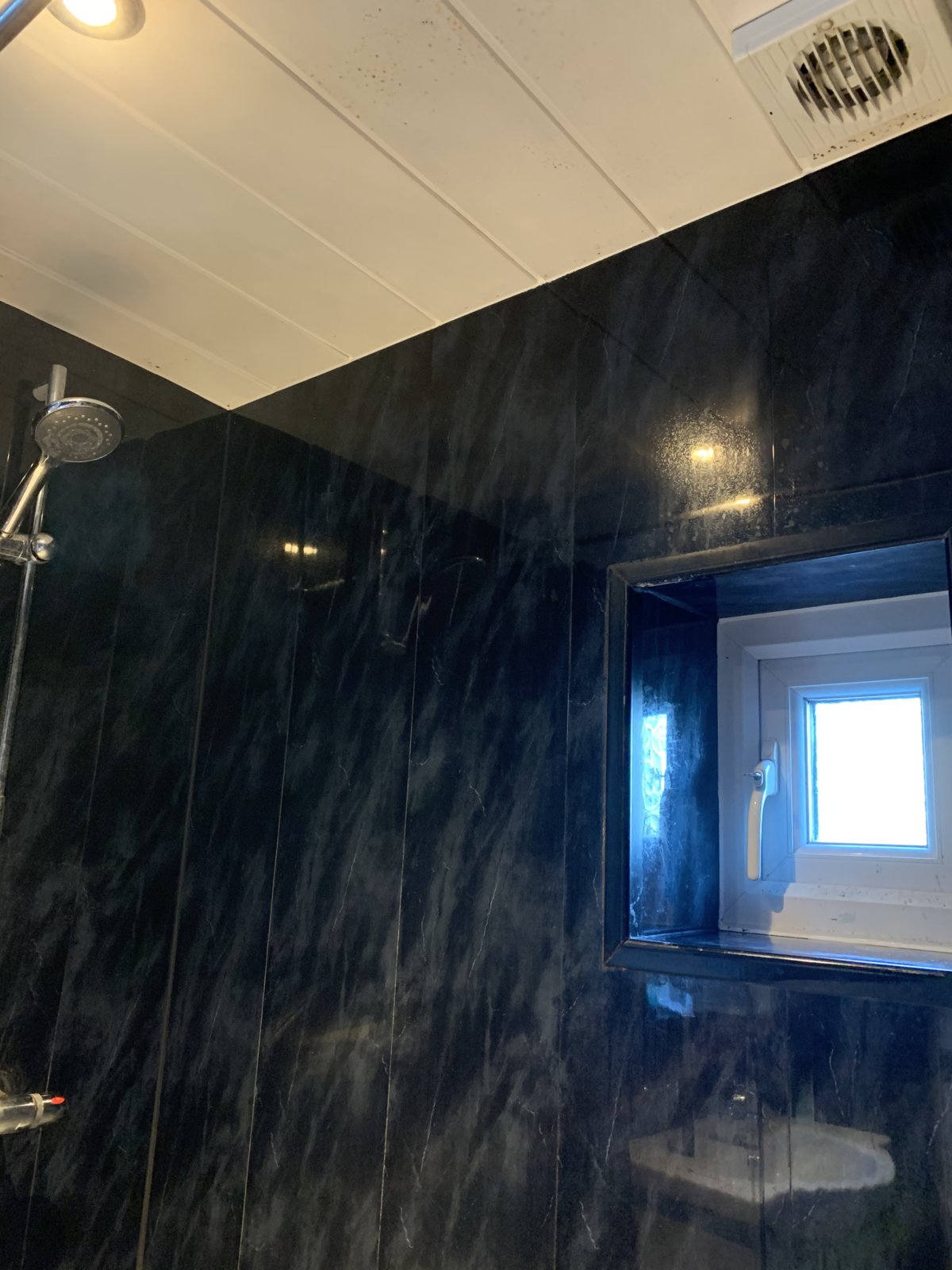

Manrose fans are not very good, you can buy a quieter one, but it will not be much more powerful. Yours is a 12-volt fan, post a photo please showing where it is in relation to the shower and the ceiling. Are you using the correct transformer?

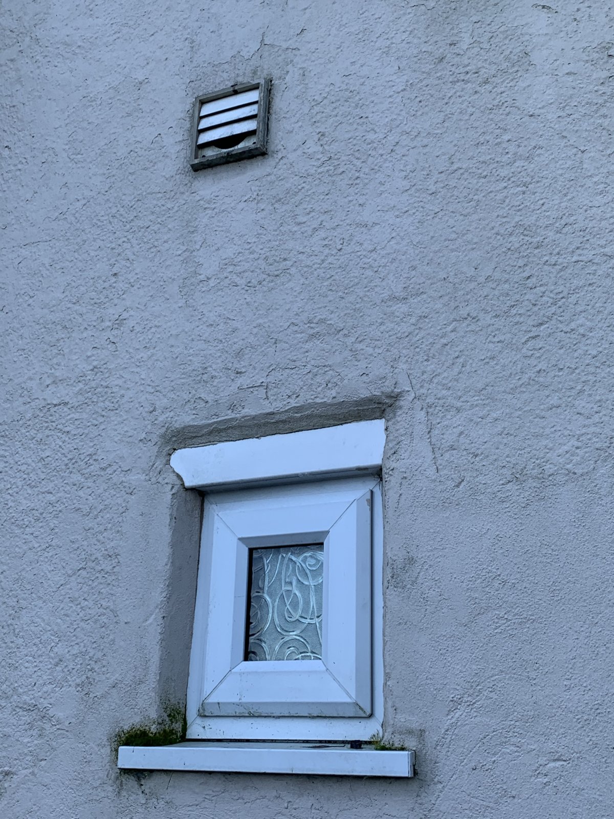

Hi and thanks for the responses. I’m including a couple of photos to show more information. The fan vents out using a flexible duct going up and out, only a distance of 6-8 inches. You can see the broken slat on the picture.

I prefer a Cowl vent, it is better at keeping rain out, and does not rattle so annoyingly, or break

Check for cobwebs or fluff obstructing airflow.

Is that a false ceiling? If so you can fit a more powerful and quieter inline ducted fan in the space above, which will do a better job. They are bigger than your current one. Steamy showers create a lot of water vapour and damp. Your existing fan will need to run for a long time to dry the room because it is not very powerful. If it is not annoyingly noisy leave it on constantly and see if that does the trick. I see there is no trickle vent in the window so you are reliant on the fan.
Rigid duct is better than the flexible type, you assemble it with elbow connectors. Worth doing if you change the fan.

JohnD I’m going to have a look at the type of fans you’ve suggested as it is a false ceiling. The gap under the door is large enough and not blocked, I wonder if the fan just isn’t strong enough for the be sufficient. The cowl also looks good and cheap!
Jonbey the bathroom isn’t consistently warm. It has 3 outside walls, and nothing above other than insulation and a tiled roof. We have a towel radiator in there but it’s not always on. We’d need to look at a separate method of heating the room. I’d need to look into how difficult it would be to fit a bathroom heater!
