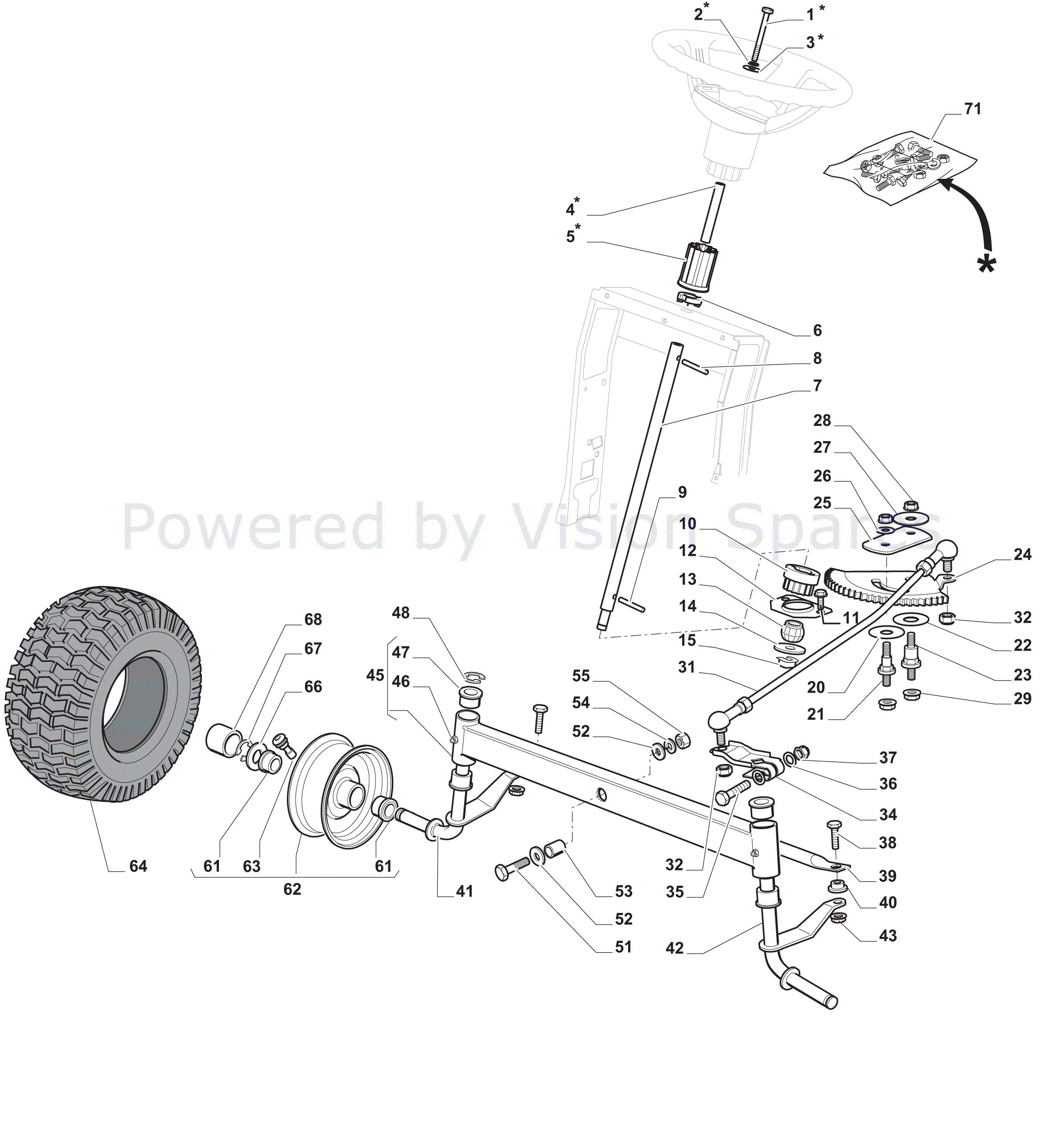

When mowing my lawn with a Mountfield 1538M-SD ride on mower yesterday I managed to knock the front wheel on a tree stump. This has put the steering out of centre such that it only steers a little to the right on full lock, but has a tiny turning circle when on a full left lock. It is otherwise ok.
An inspection shows that the steering is very simple, but I cannot see anything that looks wrong.
Found some parts schematics on line, and there doesn't look to be anything that can twist/move.(see
http://www.partslookup.co.uk/getdiagram/20171803-6fba-4ec1-8f5d-2528c7bf8568.gif). There is a quarter circle toothed plate (24) that should be central when the wheels are straight, but is now at about a quarter in when the wheels are straight. The plate is linked to the top of the wheel by a rod with ball joints (31), but this does not appear to be bent or damaged. This fixes to the squared top of the stub axle (42) by a steering arm (34) with a square hole that cannot possibly turn out of square. Both wheels are parallel so it is not an individual wheel at fault.

Pin 9 drives pinion 10. and I'd suggest that pinion 10 has slipped allowing the cranked gear 24 to jump a tooth or two.

Surely that shouldn't make a difference as the quarter circle is direcly fixed to the top of the stub axle. The plate should be central when the wheels are straight, regardless of the position of the the steering wheel.
Looking closer there are adjusters on the ball joints at the ends of the steering rod that appear to be to centralise the steering, but a knock to the wheels should not 'unscrew' the adjusters to that extent. I am not even sure there is that much play in it. Might have to look at those, but it is now tipping it down with rain.
The pinion that drives the quadrant can shear its roll pin that fixes it to the steering shaft - its also not unknown for the odd tooth to shear off :eek:
Also check the steering tie rod (39) for kinking.
