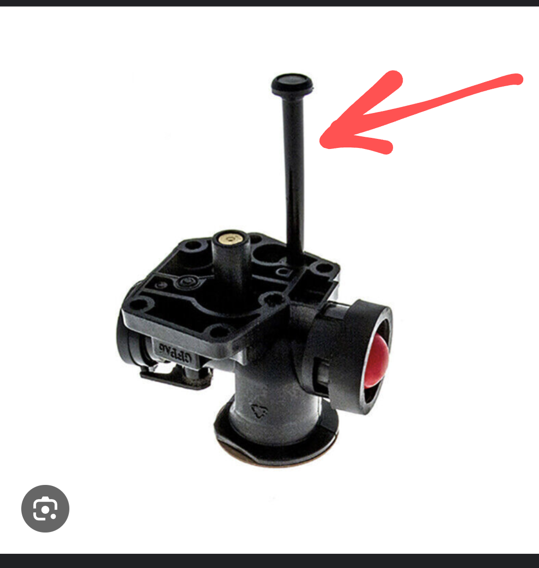

I've just serviced my Mountfield HP470 mower. I've replaced the blade, oil change, new air filter, new spark plug, new fuel primer, cleaned the carburetor (used brake cleaner spray), new diaphragm & gasket...but it's not running right.
To be honest, it's pretty similar to how it was before serving it!
any thoughts on what's up there?
Did you manage to remove the main jet, and the emulsion tube which is above it?
I presume the engine is surging - i.e the revs are going up and down?
John :)

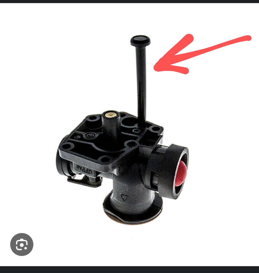

Hi John...is that this bit? (See photo) I removed the tube and just sprayed cleaner everywhere else, including inside it. Would you disassemble it more?

Yikes, humble apologies, your machine must have the side valve engine.
That pipe shown is the dip pipe which pumps fuel from the tank up to the carb.
The big issue with this set up is the gasket between the carb and tank - it’s vital that it’s in good condition.
Are you happy that you have the gasket and diaphragm assembled in the right order?
Other than that, this carb responds well to cleaning but compressed air helps a lot.
One more thing, if your engine has a rubber pipe connection at the carb, this takes a pulse from the crankcase to pump fuel. That rubber connection needs to be tight.
John
Thanks mate, yep pretty sure I've got the gasket & diaphragm on right. (Thin bit on the tank side). There is a rubber pipe elbow connecting through carb to the mower, I'll have a look at that.
