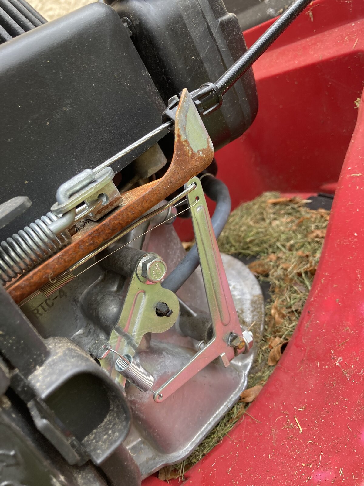

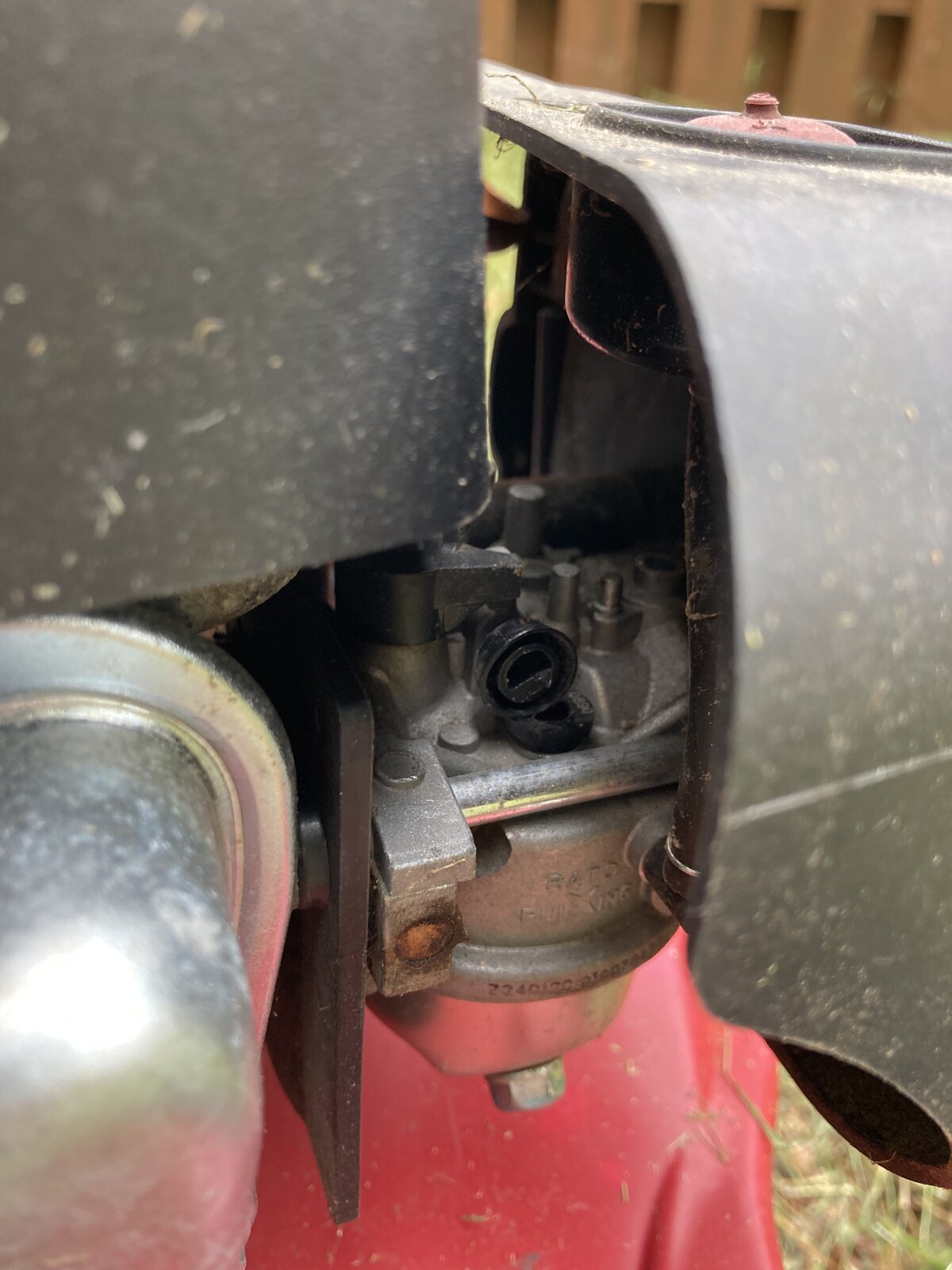

So I had this same issue and followed the movi by control rod to the front. It ran better with a little extra throttle or reduced air flow.
I played with the black ‘half moon’ grub screw in the bottom photo till it stopped bottoming out. Seems to work well now.
