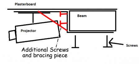

Could you not fabricate a metal bracket that you can secure to the beam itself, in a sort of "S" shape, so that you have a metal anchor plate a few mm from the plasterboard?
Screw holes in the wooden beam would be easy to hide.
Or am I reading the whole situation wrong?
Something like this crude sketch!
I was thinking this also. I would also suggest that you would need to put screws towards towards the vertical face of the beam, just before the bracket bends at 90 degrees to the ceiling, as otherwise the bracket would suffer from droop- and there is nothing worse! Some bracing pieces may also be a good idea- if if was all painted white to match the ceiling this would probably all match in ok?
IMO, the rear screw in the bottom would only need to be very short, if there at all, the shape and load would be pushing that part of the bracket up, into the beam (fulcrum point would be the bottom corner)
Correct. It would just keep it all nice and straight and flush against the beam, although as you rightly say it would actually be getting pushed upwards by the load anyway.
