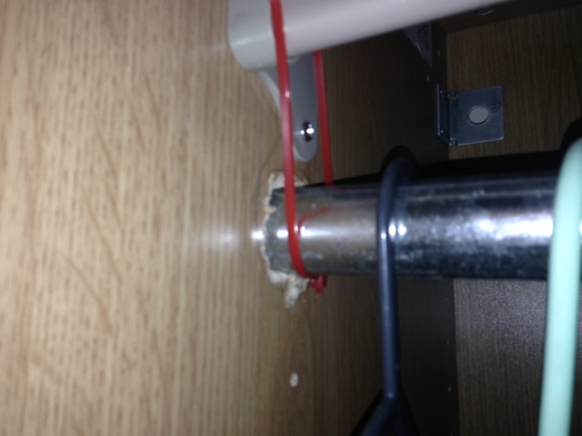

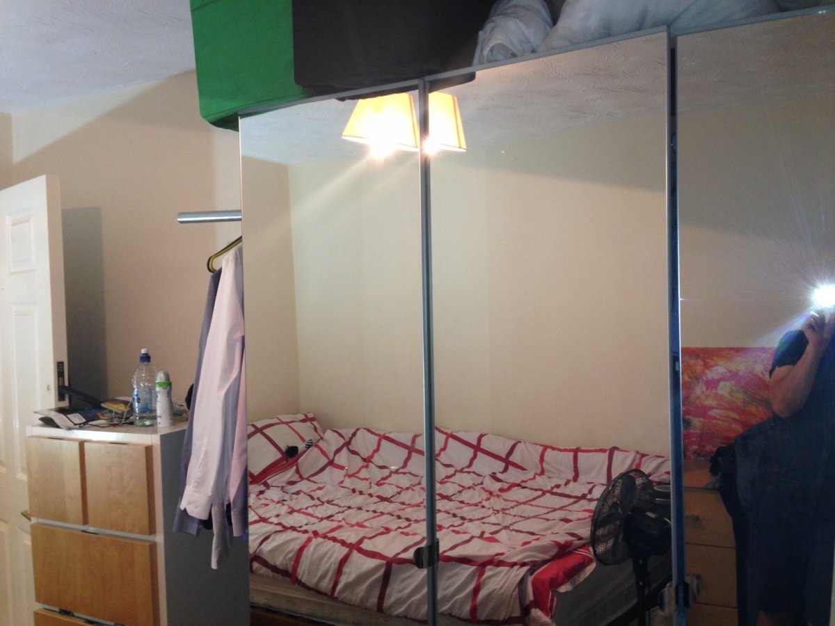

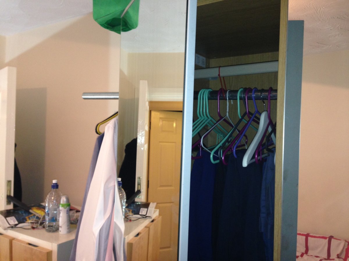

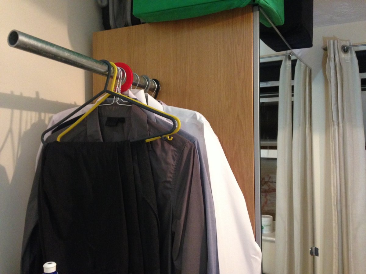

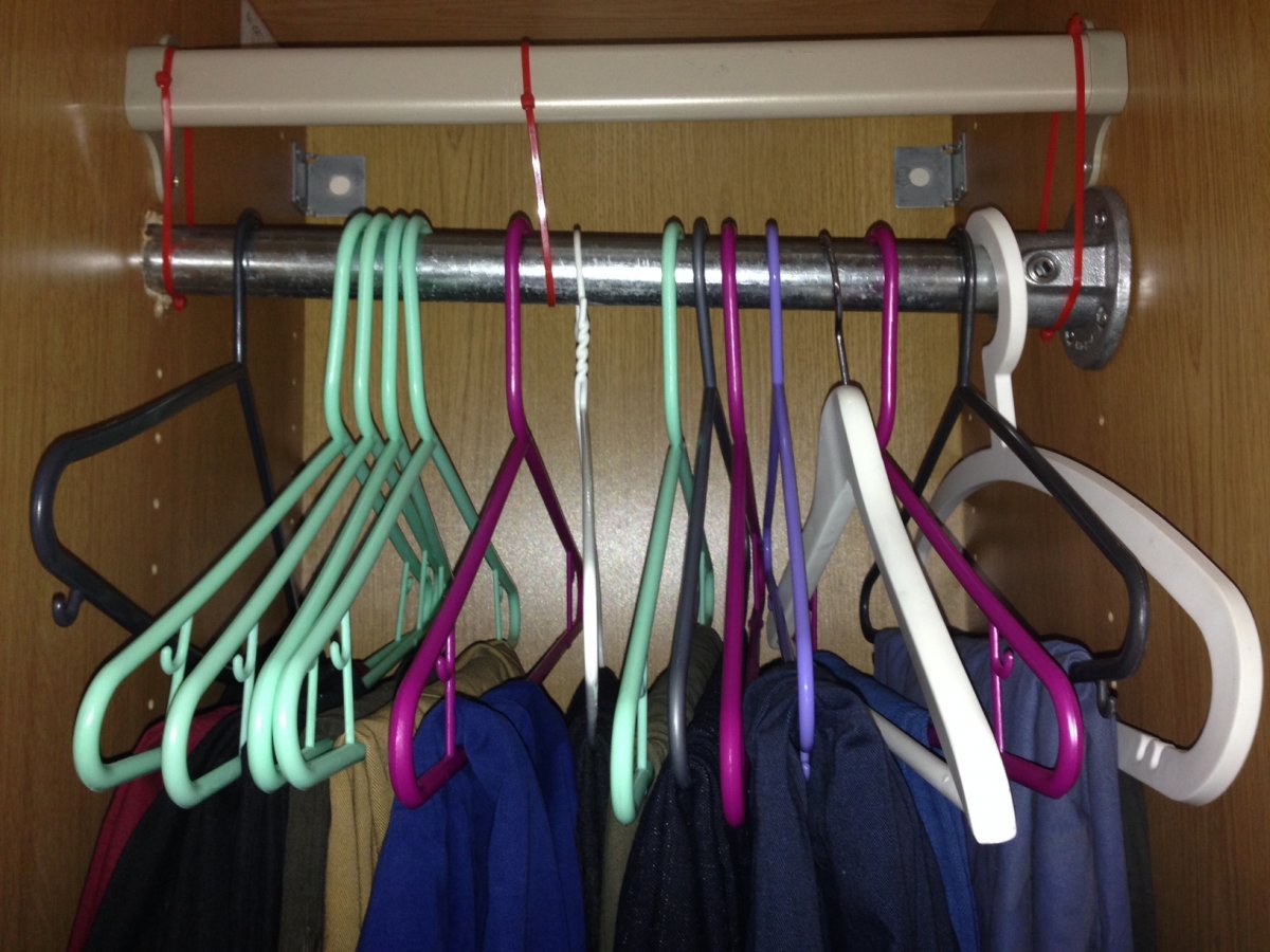

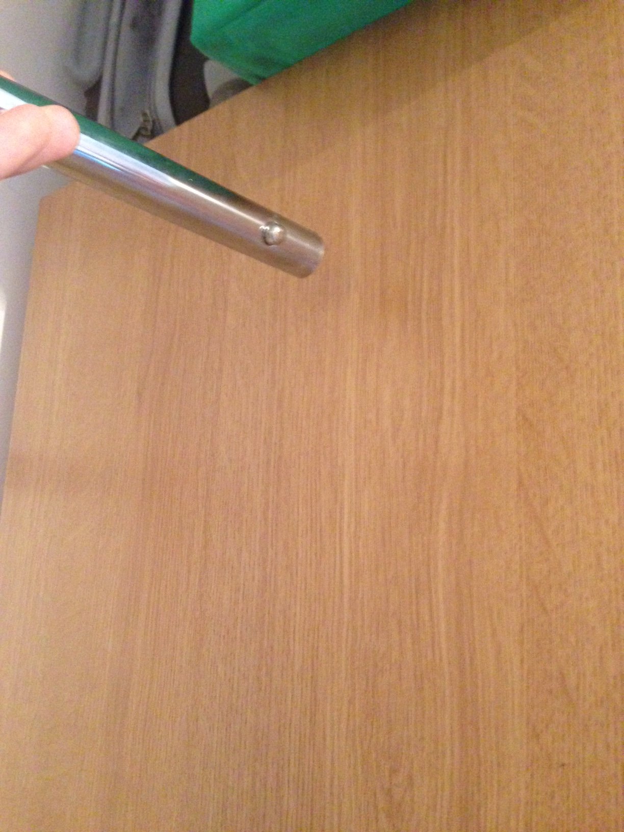

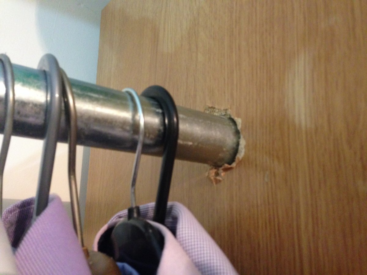

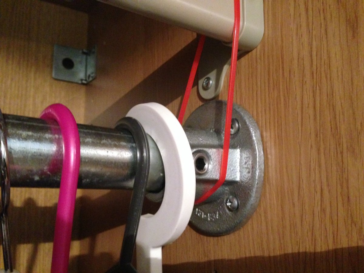

Hi guys, I know this is far from good DIY but I ordered the rail recommended above and in the past hour I decided to give it a bash and put it through the side of the wardrobe and fix it on the inside. I don't have much time at the moment but I've just ordered some new shirts, so I need somewhere to hang them, so I've come up with this!
Again, I know this isn't good DIY, I'm not claiming it to be but it seems to do the job for now, that's all I care about. It's not fixed on both ends so I used cable tyres for safety and. See photos below...
IMG_1214.JPG IMG_1215.JPG IMG_1216.JPG IMG_1217.JPG IMG_1218.JPG IMG_1222.JPG IMG_1223.JPG
I know this will open up lots of question marks but ultimately do you guys think there's anything important I need to think about here? I am wary that the wardrobe might fall apart! But if it does, I'll learn! ;)
keep your eye on the hole
with all that weight the chipboard may start to crumble or crush
Okay, thanks for not slating my DIY skills :) That's the kind of advice I was looking for, I'll keep my eye on it. I actually think the cable tyres will help, because they should hold the majority of the weight.
If you buy another wall plate, you could do a spot of metal work to make it a through bracket.
I think at the moment the base has an internal stop?
Then fit the bracket to the chipboard and slide the rail through.
To be honest, I assumed that you'd support the end with a vertical.
Take care not to get that end in your face as it will hurt! You can buy plastic caps in yellow that act as a warning. A thing that I do while working on old motorbikes is cut a hole in a tennis ball and shove it on the end of the handlebars.
Just to let you know, I took a look on the key clamp website and saw they offer a bored out option on the flange plates, pop one of those on the rail that is protruding through the side, screw that in and an end stop in plastic, and you have a fairly finished article there, could ditch the cable ties im sure!
