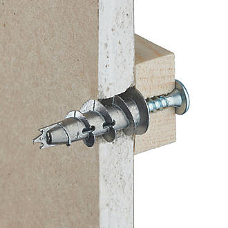

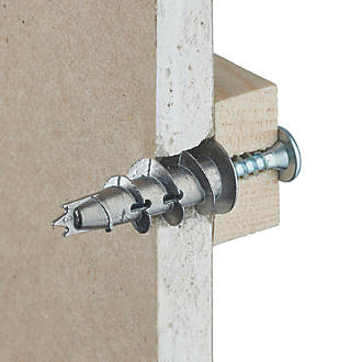

It sounds like a partition wall system - the sort of thing still used in offices and sometimes shops. They often use glass fibre reinforcing in the plaster and can have metal edges. Generally fitted into a steel channel section at floor and ceiling levels which get covered with the skirting and coving respectively - there are other systems where the partition is grooved to fix onto a hidden track as well. TBH I haven't seen them used in houses for a very long time (the well known version used to be called Paramount and had two skins of PB with what looked like a cardboard egg box in the middle). The one thing I know which will fix into them is a "curly whirly" plasterboard fixing like this Easyfix Self-Drill PB Fixing:
but I've found that you do need to pilot drill them carefully at about the same or just smaller diameter as the body because they always seem to run off line if you just screw them in (in other words self drill? phuey!), They will hold light weights and items which are flat to the wall, but they are a case of the more the merrier. I've used them in office partitions on one job to hold smaller flat screen monitors, but I used 8 or 10 per pattress to affix biggish 12mm MDF pattresses to the walls (with some grip adhesive on the back as well) and then attached the monitors (about 20 to 24in, from memory) to the pattresses. I can't see them carrying a 42in flat screen TBH, but maybe someone else has a better technique
