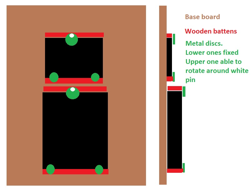

A suggestion
That's more like it, thanks Bernard, I'll give that a bit more consideration - my only change to your design would be a wooden batten each side (a smaller one on the sides where the cables are) but I like the rotating disc, bit like an old-fashioned 'turnbuckle', and the fact that its front-loading!
My latest thinking was similar but each with a batten running vertically down from roughly where you have the rotating disc, it would mean access space was required from the open side though to slip them under the batten. Not got the time at the moment to draw it up, hope it makes some sense...
