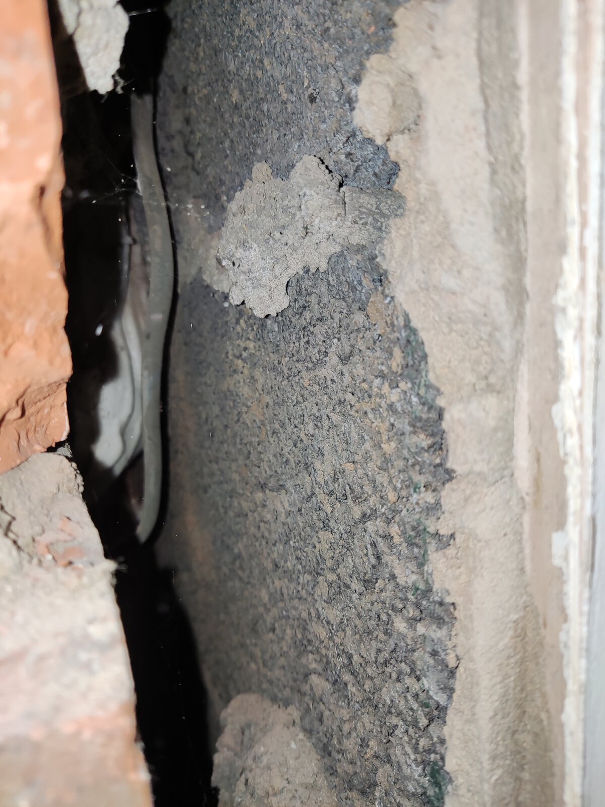

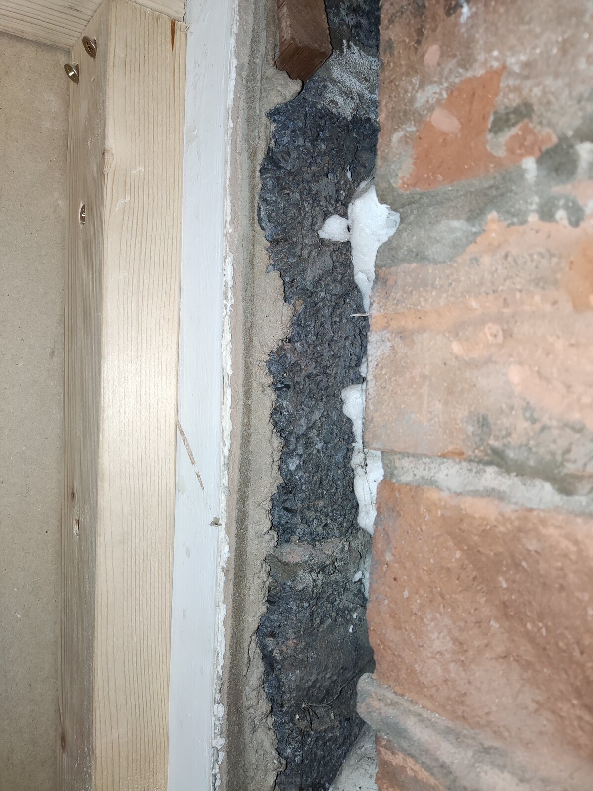

Want to mount 55 inch TV to block walls. The manufacturers of most of these mounts say not to mount into breeze blocks (though I'm sure I've done it before). I thought most of the houses in the UK had breeze inner leafs? I've attached some pictures of the type of block I have. Debating a floor standing mount instead. TV weighs around 15kg and I want it on an extending bracket.
Fine if you get decent fixings into the block. Hardly ever recommend using resin, but in this case it may help
Never used resin tbh is it fairly straightforward? Am sure loads must hang these brackets on block with screws or bolts . My thinking is a kitchen cupboard full of crockery surely weights more than a TV, though the weight is closer to the wall etc
I re-fitted my shower room that's built from very similar block. This included a radiator and shower mixer and rail. I wasn't happy with it. I buggered about with plugs and glue, ended up getting something adequate, although I suspect that the tiles may be assisting more than the wall behind.
Definitely use chemical fixings. Thoroughly blow out the holes after drilling, e.g. with an aerosol air can.
My 1990 era blocks seemed to be particularly rubbish. Bits of black rubbish barely stuck together, just waiting to crumble.
