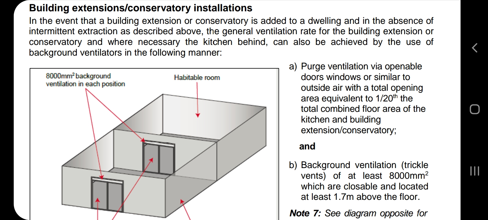

Currently have a freestanding gas cooker in a small kitchen. The 'outside' door and adjacent window lead to a 'lean-to' type utility area. This in turn has an external door and openable window but are rarely open.
The property has currently been passing it's annual gas safety checks.
However, I am wanting to move the location of the cooker by about a metre, meaning that a new / extension of the gas supply will be needed. Unfortunately though the plumber says that he won't be able to do this as it will invoke current regulations saying that ventilation must be to an outside space and not to another 'room'. One would assume that this utility area would be classed as another room.
Is he correct?
Is there any way around this? Presumably to have an extractor to vent to the outside? But how do we ensure that this is always on whenever the gas hob or oven are in use?

Found this:
Is this saying that it's OK as long as I have a door in each (mine are normal size) and a trickle vent in each room?

Yes if you can comply with the dimensions, a ducted extractor fan would be easier and more effective at providing purge ventilation.
Although it would appear that I do not need an extractor fan of any means, surely?
For smells etc, a room re-circulation fan could be used. For the removal of combustible materials / gases, the ventilation via trickle vents and the occasional opening and closing of the doors would appear to be sufficient as per the diagram above?

A trickle vent can only allow fresh air into a room is there is someway for the stale air to leave the room.
