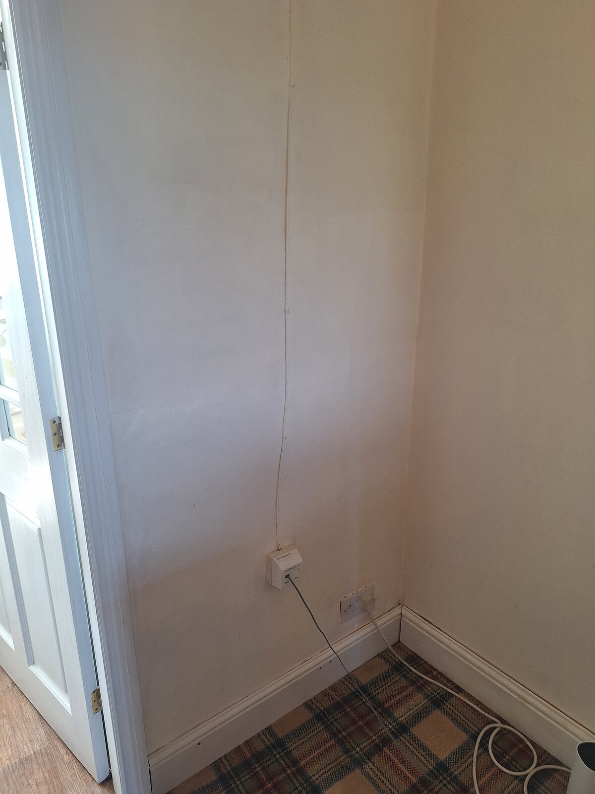

Hi Guys,
When my phone line was put in years ago line comes halfway up the wall. I want to move the cable outside to come in a new hole lower down just above skirting board but the wire is not long enough i need to extend it what connector should i use and what type of wire.
Cheers Kev.
You need gel filled connectors and the crimping "alligator" pliers. Additionally you will need a suitable exterior cable.
Others can recommend specific products that will make it look like BT openreach fitted it.
Additionally, you will be advised that you are not allowed to touch anything before that NTE plate/box because it is the property of Openreach.
Over the years I have moved a few NTE boxes on behalf of customers without issue. Just sayin'...
