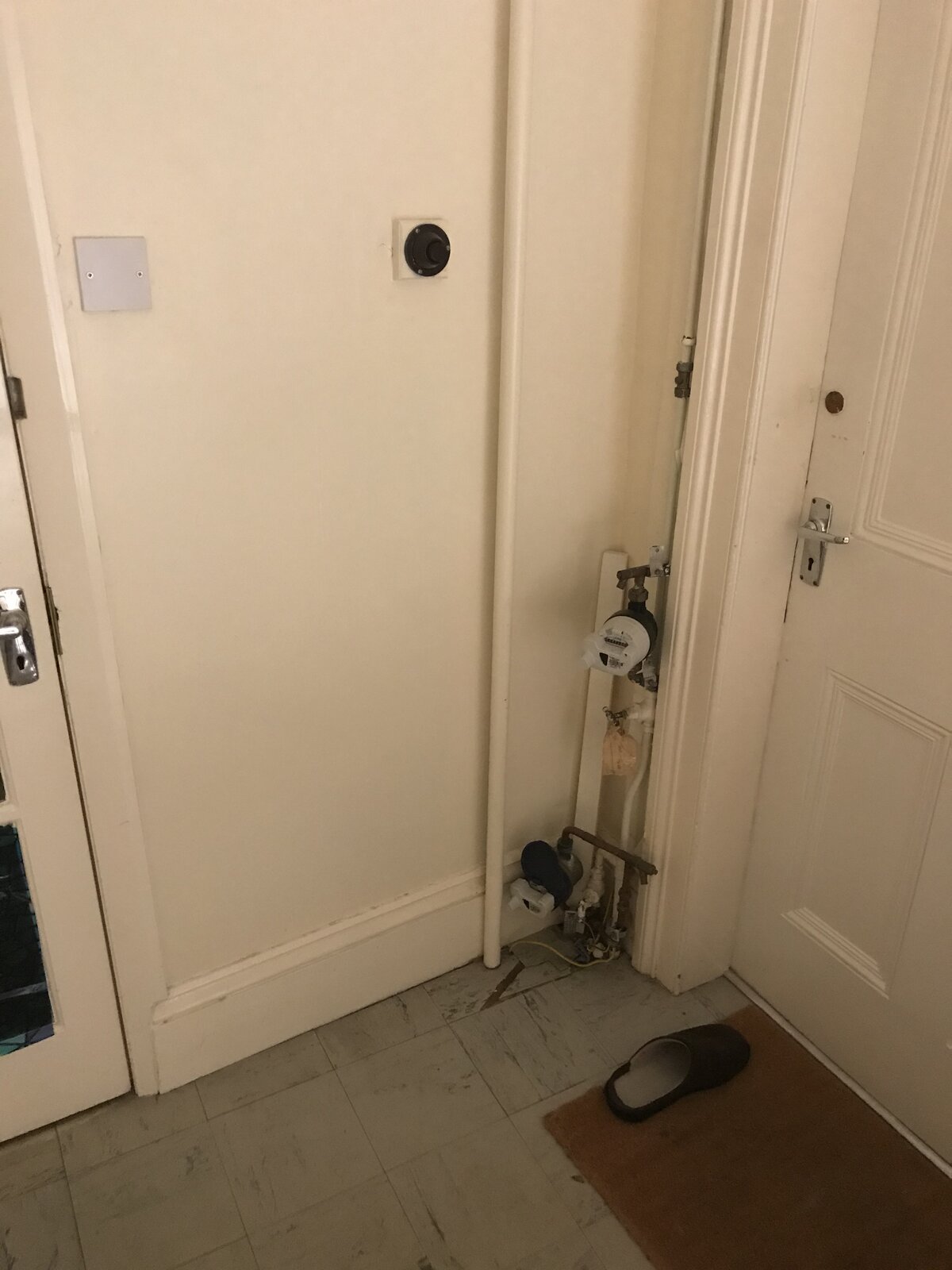

I have contacted northern gas networks and will wait for their email reply about getting the ball rolling for moving this meter.

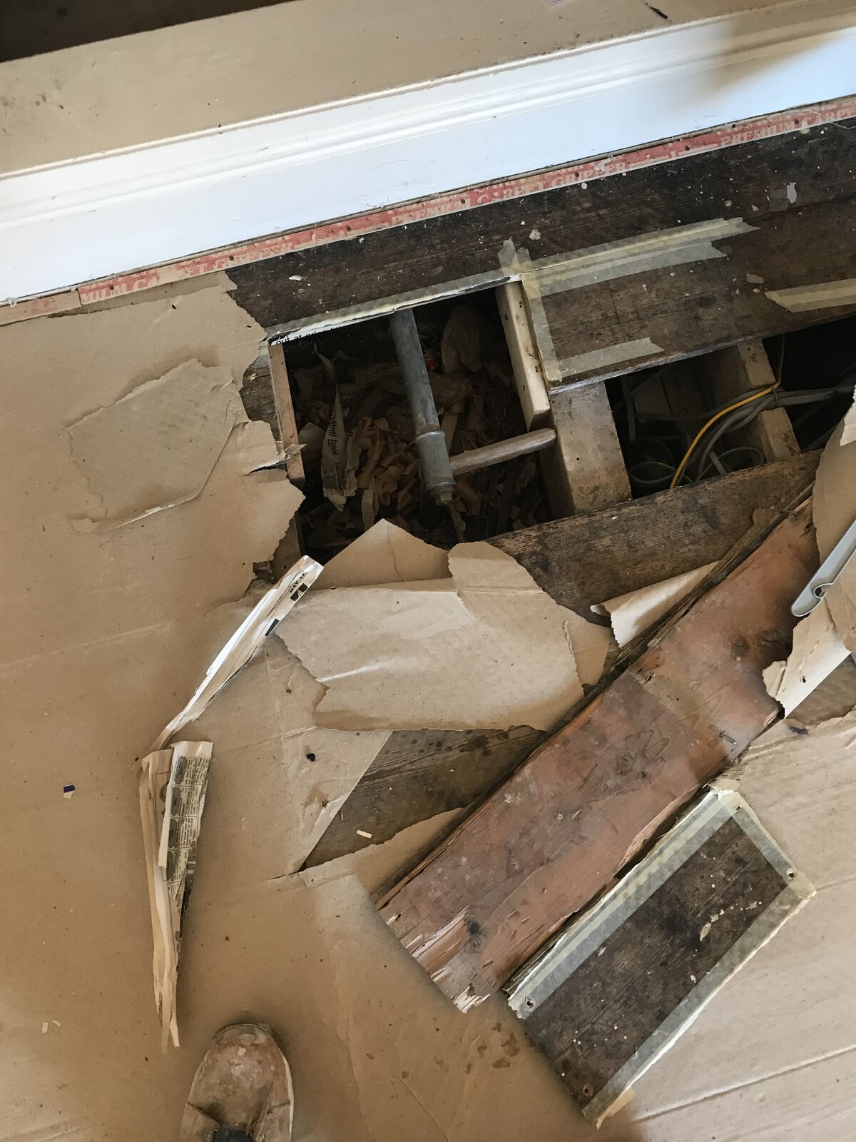

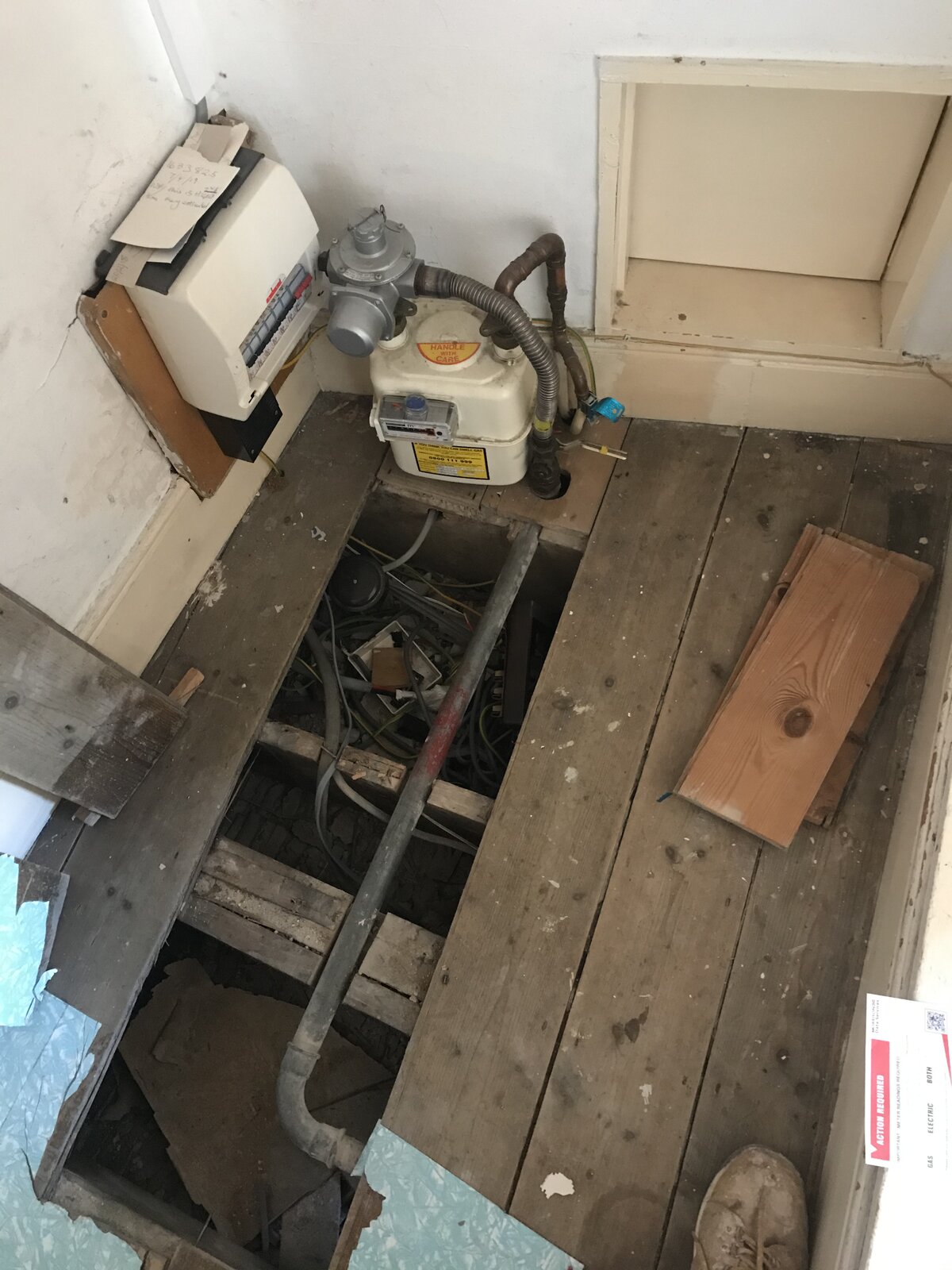

From the photos, do you think i could put the meter in the hallway. The pipework gas feed in steel can be seen going up the wall into the floor of my flat above. The other photos show how this pipe work moves until it arrives at the meter.
The area where the meter is now will be a bathroom so i need it moving.
Could the meter sit in the hall next to the 2 water meters. It would also sit next to my downstairs neighbours front door.

I looked into moving mine but postponed it due to cost/benefit.
However, if you gonna pay- can you move it outdoors on a wall?
Don't quote me on this, but the National Grid Guy who came out to change the ECV on my supply said the rules now dont permit pipework inside the property that cannot be isolated, so NGN may insist if you're moving it, it goes outside the property.

Thanks for replies
I am sending off a diagram and form tonight.
It sounds like I am going to have to pay lots to get this moved, but it can’t stay where it currently is.
If it went outside, what happens to the other 2 meters in the respective flats?
it is conservation as well and I don’t think we can set the boxes outside at the front.
