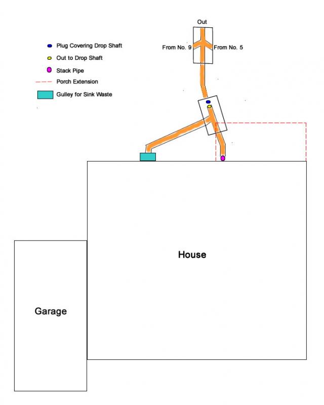

I need to move a manhole because it’s in the way of a porch extension. I have two manholes in my front garden, one is for my house and the other is shared between neighbouring properties. The manhole in question is the one for my house. This manhole has 3 entries and one outlet, the outlet being a dropshaft to the shared manhole further forward in the garden. I plan to use an inspection chamber elsewhere to replace the current manhole. My question is, how do I connect to the existing drop shaft or do I need to be going down a different route?
I have included a rough picture showing the current situation.
I hope someone can advise me on what to do.

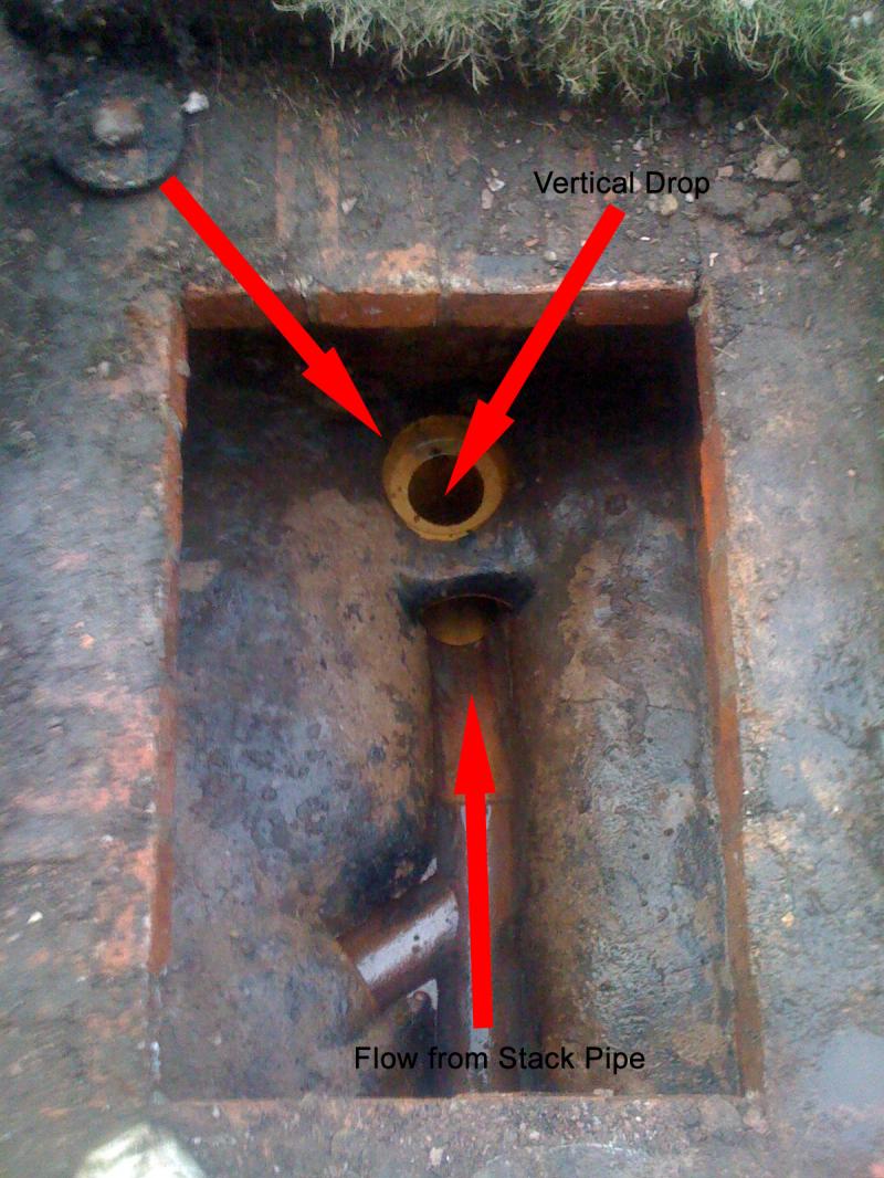

Maybe my terminology is incorrect, ooops. I have done another (rough) drawing of the side view and also taken some real pictures. I hope this clarifies my situation better :)

If it were me i may consider moving the inspection chamber to the left as opposed further away from the building and re-hash the stack pipe thus modernising it too.
The stack pipe could be moved over too provided there are no windows and just extend the loo pipe to suit. This would be more convenient regards the porch.

I have replaced the stack pipe from the ground up already. I will be replacing the remainder during this job. I'm pretty certain whatever is left of the stack pipe is the asbestos stuff.
I can't move the stack pipe as there is nowhere for it to go, plus it would mean doing the upstairs bathroom plumbing all over again.
Thanks for the pic. ;) Strangely it looks different to an interceptor :confused: that plug you removed is nearly horizontal -does the pipe under it drop down. not seen one like it here in sussex
Pictures do a better job than my drawings, haha. It definately isn't an interceptor.

The plugged pipe is a rodding point that rods beyond the U trap to stop the whole estates drainage smell coming up my spur.
Well my system may be different but the chances are your pipe doesnt go straight down (as it would block up alot) but goes at a fairly steep angle and the plugged pipe is a rodding point.

Static, the plug at the top is just for rodding purposes, because the waste flows down before the plug end. The drop is vertical, most definitely. I was in both manholes yesterday clearing out waste that had dropped down whilst I've been excavating the area.
