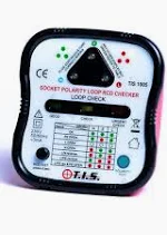

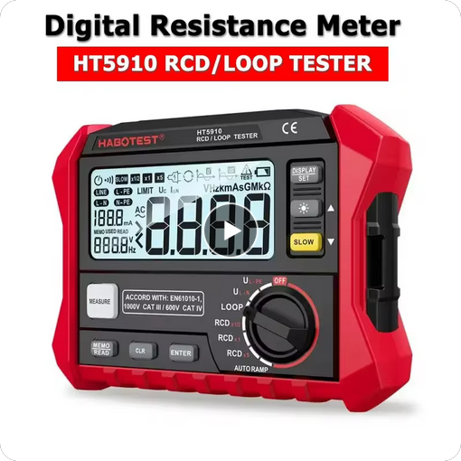

If you want to follow the rules, then a meter like this 1725269605834.png is required, and cheapest I can find is £60, you could use a meter which does less, like this 1725269753652.pngthat is £30, but it does not time the RCD tripping, and the loop only good enough for a radial, so if you have the skill, to fit a socket and tick all the boxes will likely cost £90 for the first one, however most DIY people don't test, they trust to the lord.
