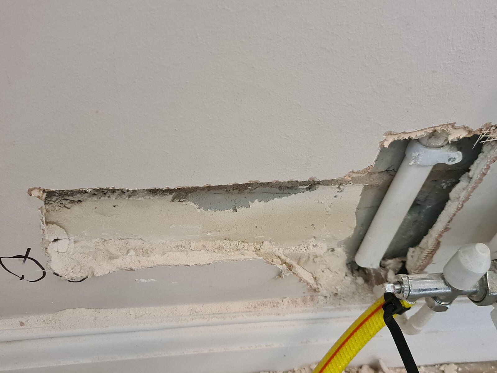

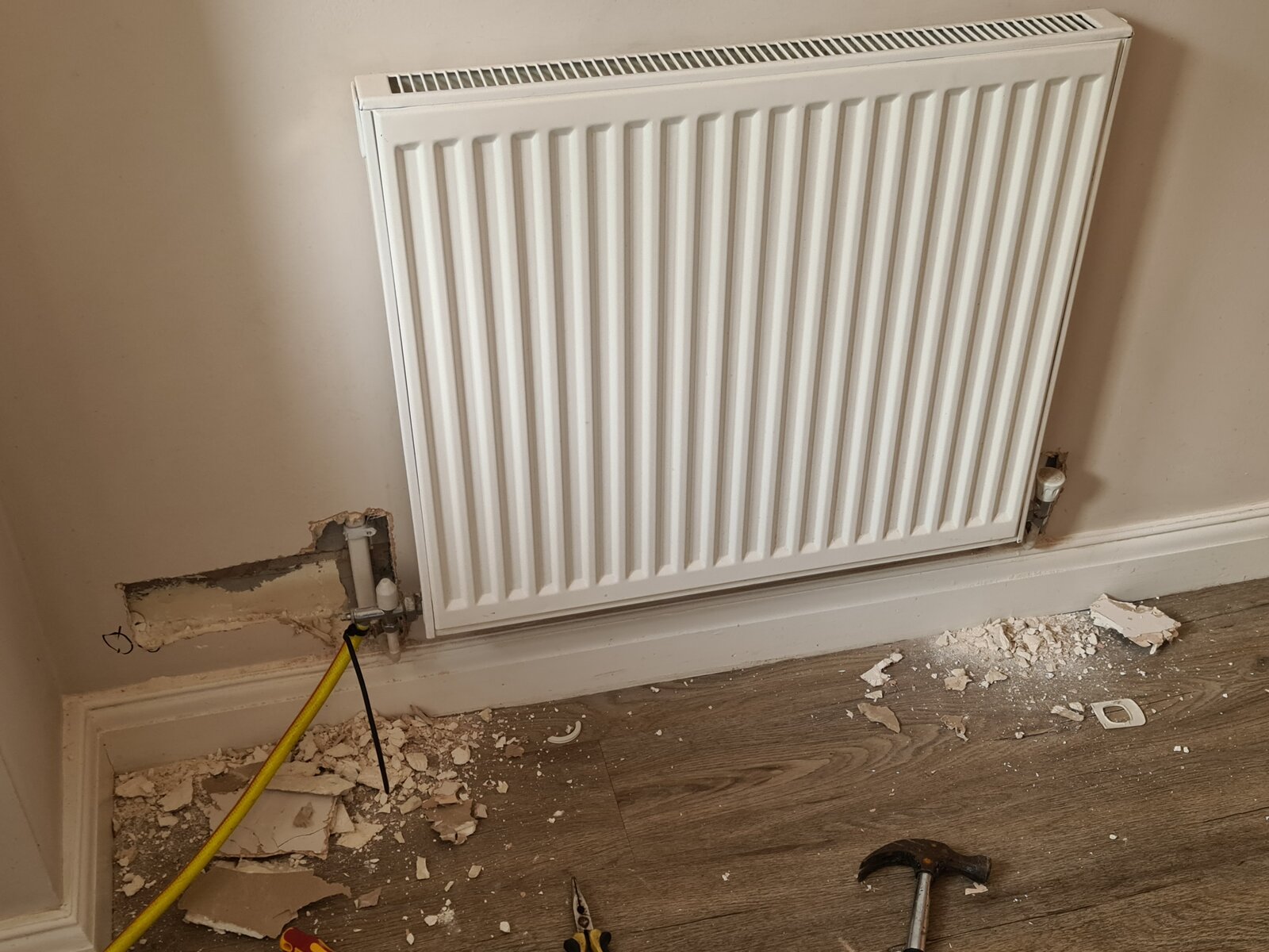

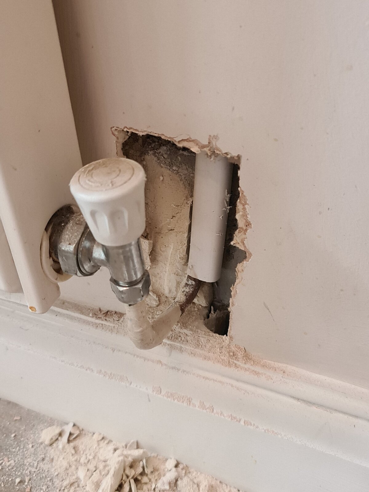

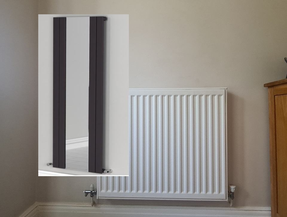

I'd like to replace a radiator in my hall with a vertical and at the same time move it 1 foot to the left.
I've not tackled this before but after watching a few youtube videos and reading a few articles it doesn't seem too difficult.
The current radiator looks like it has a drain off valve and is 10mm microbore.
My plan is to;
turn of water and boiler elec's.
drain system down from the drain off valve.
remove radiator
cut a couple of holes in platerboard around existing pipework.
cut a couple of pieces of new microbore to the correct length to move rad to left 1ft
solder new pipe to existing (in wall cavity)
mount new radiator to the wall and connect pipework
refill system
patch up holes I cut
the only slight concern I have is that the house is using a boilermate 2000, and they can be a bit fiddly to refill.
Is there anything I've missed or need to lookout for?
