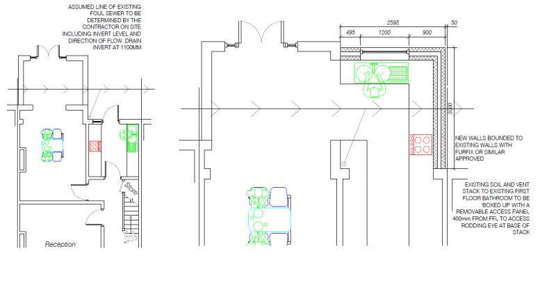

Hi all,
I'm looking to have a sewer manhole moved as per the attached plans. What is the process of this? How is this done?
Many thanks for your help.
The notes relating to the to the sewer move read as the following:

The thread title and your first line are a little confusing.
Are you asking how to form a new chamber on an existing foul line or are you moving the foul run? (you plan suggests a new chamber location)
First (obvious) question - is the sewer is only serving your property?
Forming a new chamber is reasonably straightforward. The existing foul line is exposed and a section of the pipe removed, new chamber constructed (dependant on depth, it may be possible to use a preformed chamber rather than constructing a brick built one) the existing foul run is then connected to the new chamber. Remember that you will not be able to use the foul drain for some (or all) of the time the work is underway unless the sewer can be diverted to allow continued use.
It's also vital that the existing sewer is properly protected where is passes under (?) the new foundations and floor.
Hi newboy, many thanks for that. the contents seemed quite technical and so before planning anything, I wanted to make sure that I knew exactly what the plans were advising.
Apologies, the title is quite confusing. What I wanted to know is, is it better to move the entire sewer run from where it is to a new location, or is it better to just leave the existing one as it is with a suitable cover and seal it and then construct another drain further in the garden and connecting it to the current drain/sewer?
From the plans, is either option available to me or should I choose one and not the other?
many thanks.
From your diagram it would seem the sewer serves properties other than just your house.
The law changed a few years ago and any sewer serving more than one property is the property and responsibility of the water company even if it runs under you property.
You need to check with the water company whether the sewer can be changed or built over. The good news is they may do the work free of charge for you. The bad news is they may insist they do the work and charge you for it.

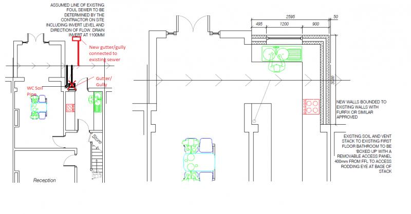

Went over today and had a look at what is going on.
There is basically a WC soil pipe which comes out of the first floor bathroom and enters the ground, concreted in place. This will remain in place and not be touched. There is a gutter/gully next to it, into which the waste water from the kitchen sink/washing machine go. This gutter/gully is what needs to be sealed.
The problem however is that the WC soil pipe and gutter/gully flows into the manhole (which was what I previously thought needed moving). This however is underneath the existing extension.
The question now is:
Would this existing gutter/gully be blocked and sealed and a new hole made into the sewer line running under the proposed extension into which a new manhole would be connected for rodding purposes? (Diagram 1)
Or alternatively, could I use the existing gutter/gully, connect a pipe to this and run that pipe to a new manhole for rodding purposes? (Diagram 2)
Or have I got it totally wrong and will it have to be done in some other way?
...... Just thought of this idea, could I use a boss and use it to connect the new gulley into the WC soil pipe?
