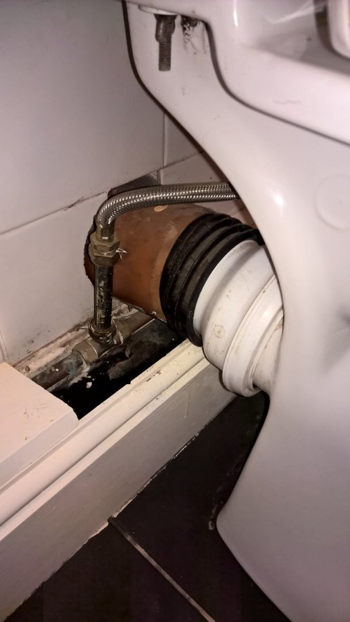

I recently moved house and am working my way around a number of issues of previous DIY. The downstairs toilet is in quite a large room (for a wc) however the toilet is very close to the wall/door. As you sit on it your shoulder is pressed against the wall and the door can hit to toilet sometimes, the toilet isn't fixed to the floor either! So this does vary.
I want to move the toilet about 3-4 inches away from the wall however the waste pipe is quite tight and it already appears to have a offset connector on. Is it possible to cut down the existing pipe in the wall and fit a flexible connector. I really don't want to try and move the pipe through the wall.
In the photograph the toilet needs to move towards you.

yes a flexible pan connector would work, but it might be worth looking at a shorter loo too as they are not all the same size. Personally I'd avoid a flexible connector if possible, but it would be the easiest option.
If you cut the pipe back a bit, you could try a longer off-set connection

Where does that pipe go to once through the wall? It look too high and too short, if you want to do a proper job I think you'd be better to move it across and down if at all possible and get a tight connection onto the pan. That is only just sealing, (if it is sealing!) in your picture!
Thanks, this on the outside wall so goes directly out but it is quite low to the ground already on the outside and would necessitate adjusting the whole stack so I'd rather avoid this. I'll post a picture of the outside tomorrow, it's a bit dark now.
