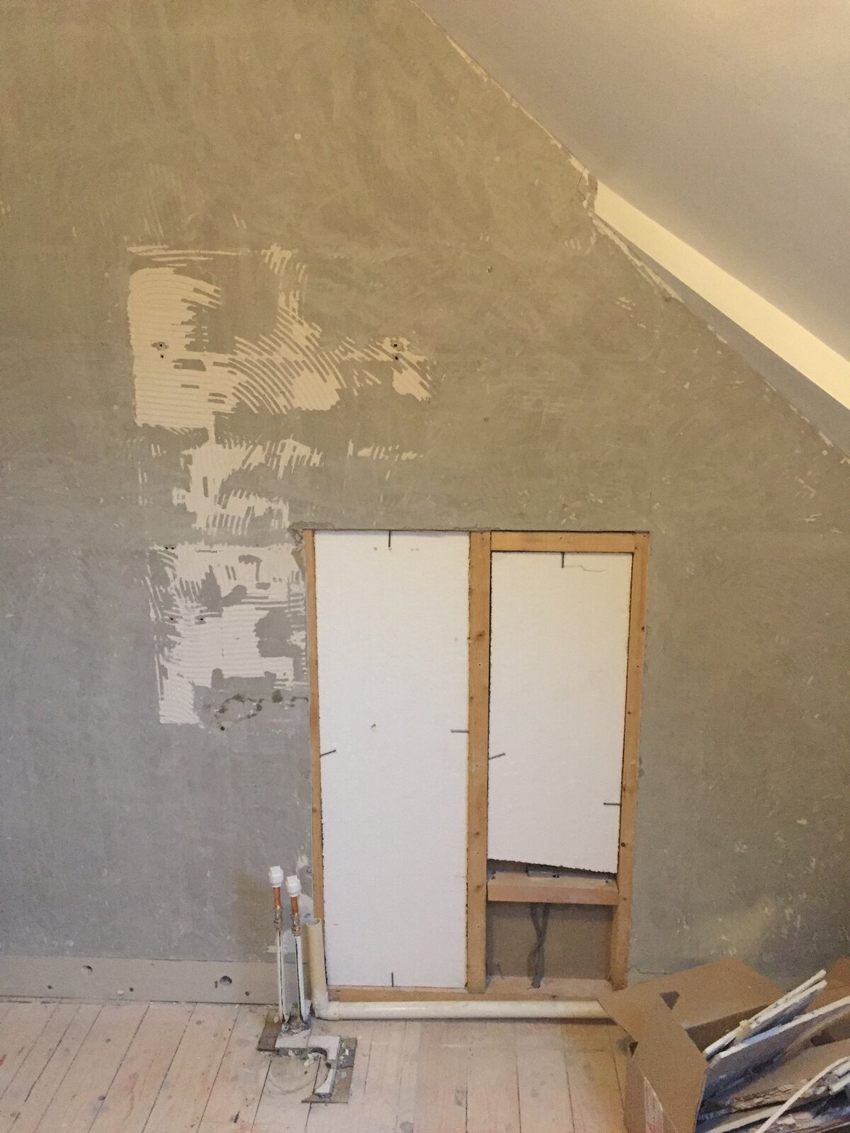

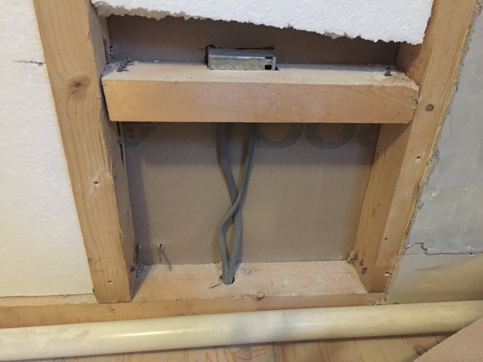

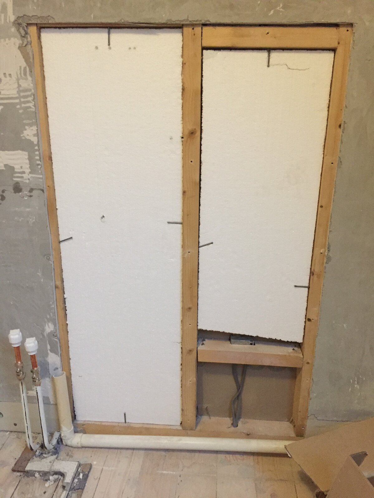

Right, I've pulled the board off and now I think the news is less good :( please see the following images:
Image #1 shows the wall with the plasterboard cut out. Note that there is a sloping ceiling. It's the middle stud that I need to move 3 - 4 inches to the right (towards the cables). There is a bedroom on the other side of the wall.
Image #2 shows a closer view of the cut out area.
Image #3 shows the actual section (on the left, needs to move to the right, closer to cables) that needs to be moved.
I expected the upright would have been in 2 sections, a lower piece I could easily move and an upper piece which would stay put. Please note that the poor looking workmanship is nothing to do with me! Splintered wood, badly fitting cross members and inaccurate nailing make me shudder, I guess that's 1990's new builds for you (?)
Hoping for some inspiration. Thanks..

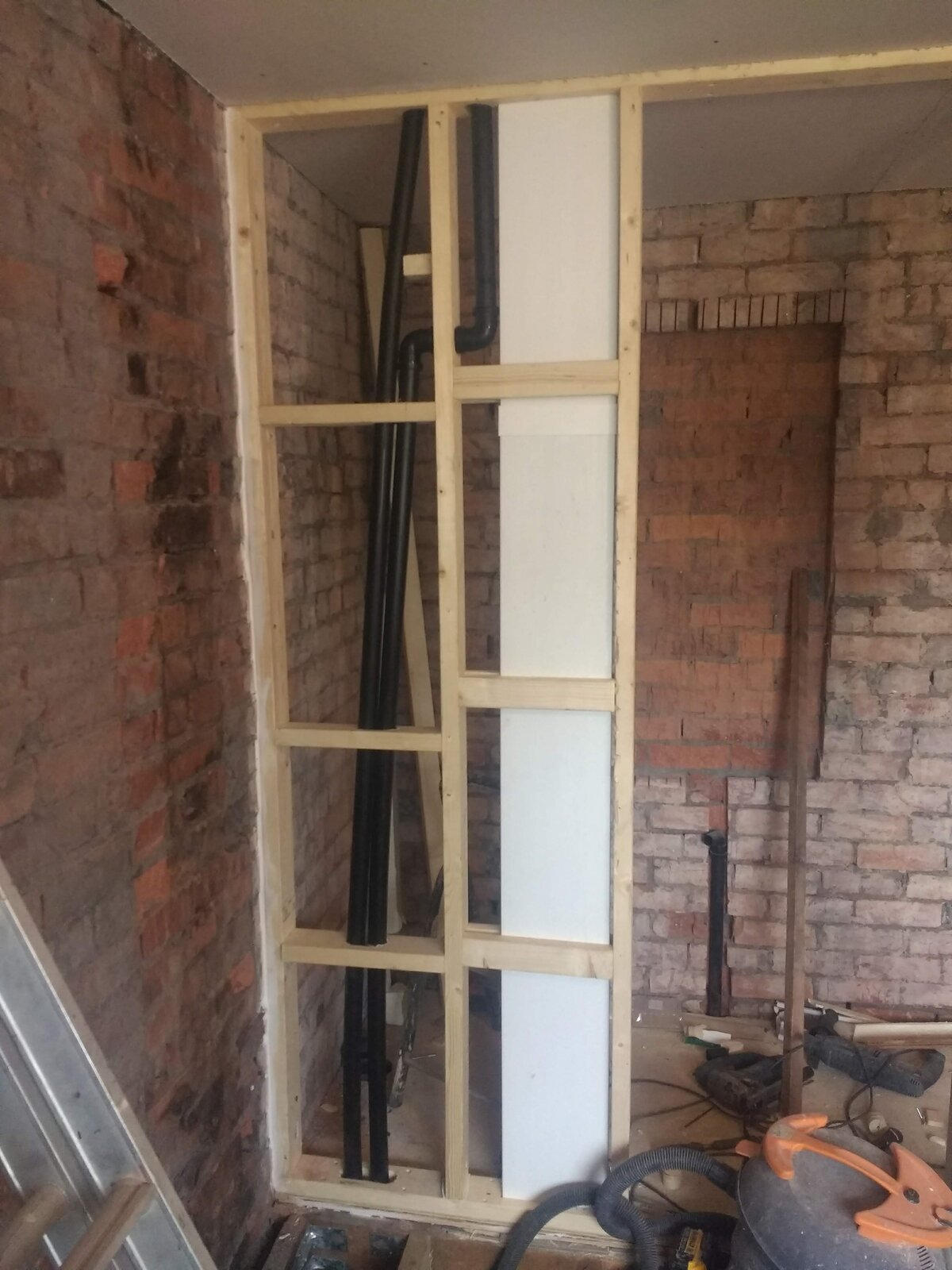

I can't figure out what your trying to do but you can easily reinforce any hacked out studwork with some plywood or steel plate. And pull that polystyrene out and put some decent acoustic insulation in if there's a bedroom next door.
If you look at this picture it's an 89mm stud wall with 2 x 40mm waste pipes and a 225mm x 25mm fan duct stuffed inside it and it's solid as a rock.
