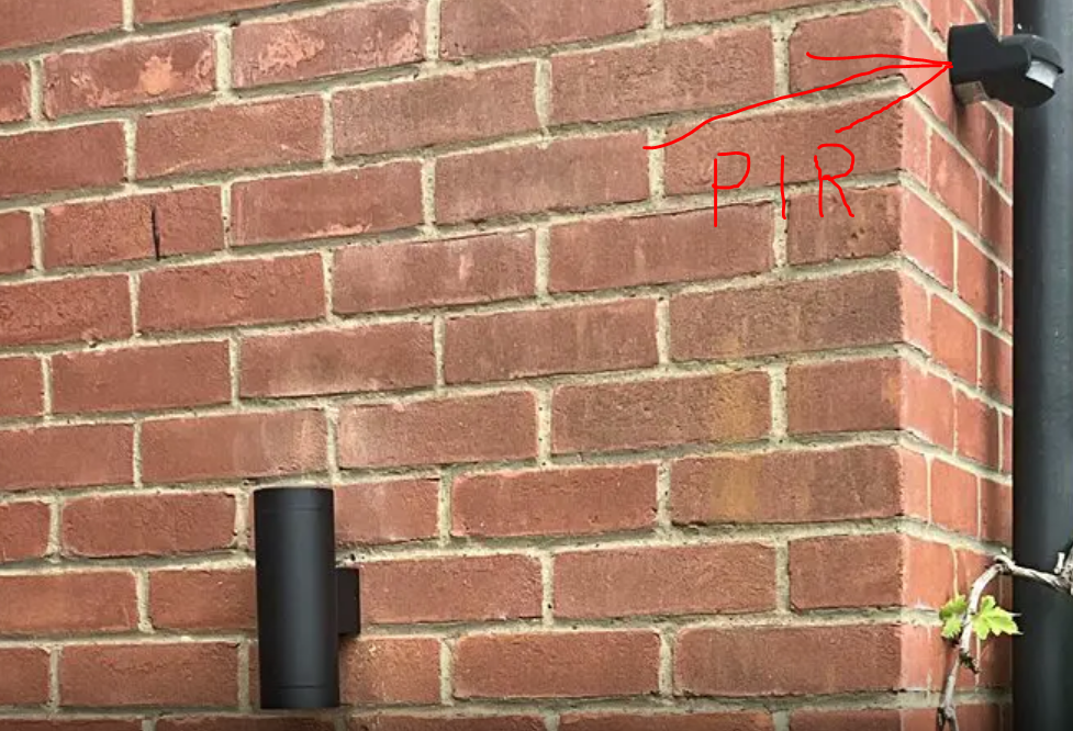

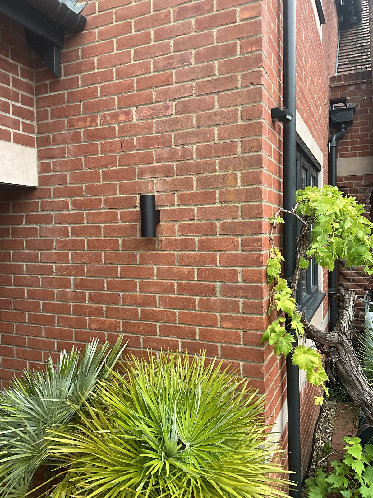

Hi all,
I have a pair of outside lights on the house exterior Brick walls either side of my drive at first floor level. One lights is 5 bricks lower in height than the other light. I’ve replaced the lights with Up/Down wall lights and its now more obvious that they are mounted different heights and it affecting my OCD
The room inside of the lower light is the kitchen, so I don’t have access to re wire from the inside.
Q. Any suggestions on how the cabling will be routed ? and suggestions of how to move the cable access point up 5 bricks ?

Fit a junction box and conduit or trunking to both, the fact that one is empty would not matter. I have seen where the building is illuminated with churches and the like, but why with a normal house would you want the light to shine up? I spend ages with my outside lights which were designed to take a bulb with connections at the bottom fitting a reflector to direct the light down to floor, as LED bulb direct all light up.

I’m trying to avoid having surface fittings otherwise they will just be illuminated by the light which defeats the purpose of brick surface up/down lights.

Well, it is difficult to tell from the internet but I would guess that the PIR is supplied from a first floor socket - is there a Switched Fused Connector Unit near one of the sockets? - then the cable is just fed to the nearest light in the picture. Can't say how it gets across to the other light but as you only have to move one...
It’s not a PIR light, just standard Up/Downlight. There are 6 all connected via a switch to the circuit in the garage. I just want to move this one to the same height as the one opposite this one, so it’s symmetrical.

If there are kitchen cabinets in the way that gives an opportunity to hide the cabling, then drill through at the appropriate point in the wall, otherwise add cable and jb outside but will look unsightly. Sometimes you can fish cable down inside the insulation.

There are no kitchen cabinets on the other side. Just plasterboard wall

The only other ways, are to see if there is enough slack in the cable to run the cable out and up the wall, to the new position, or....
Do a suitable soldered joint, well insulated with heat shrink sleaving, to enable you to push the joint back into the hole. Then if you still wanted the cable hidden in the wall, chase the mortar out between the bricks, and mortar over the top..

what does the pir on the right hand wall switch on?
It’s not a PIR light, just standard Up/Downlight. There are 6 lights all connected via a switch to the circuit in the garage. I just want to move this one to the same height as the one opposite this one, so it’s symmetrical.

It looks like the mortar around the light has been hacked about quite extensively already so perhaps removing a couple/few bricks might be the easiest way.

I cleaned the mortar as there was some algae growth around the old light.
That old PIR was a motion sensor for something else. There are no PIR’s connected to these lights.

Channel that with a multi tool, drill through wall and add cable, then repair p/board, it can be made to look almost invisible.
