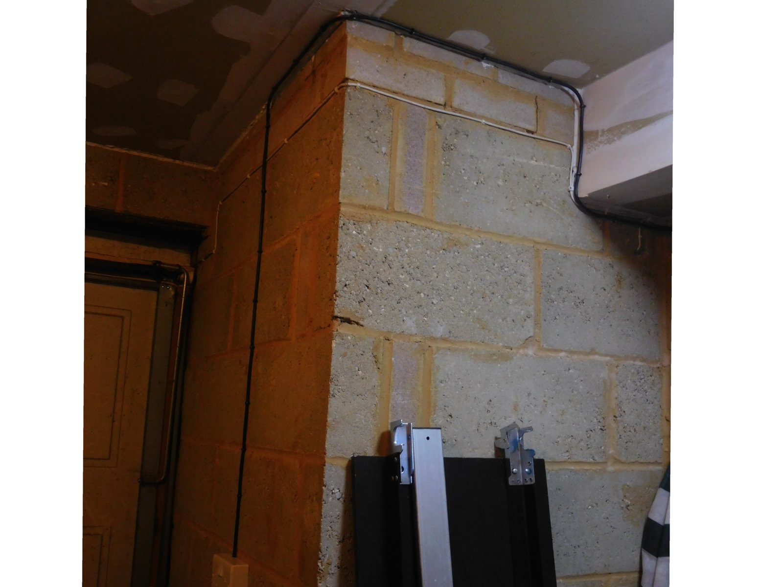

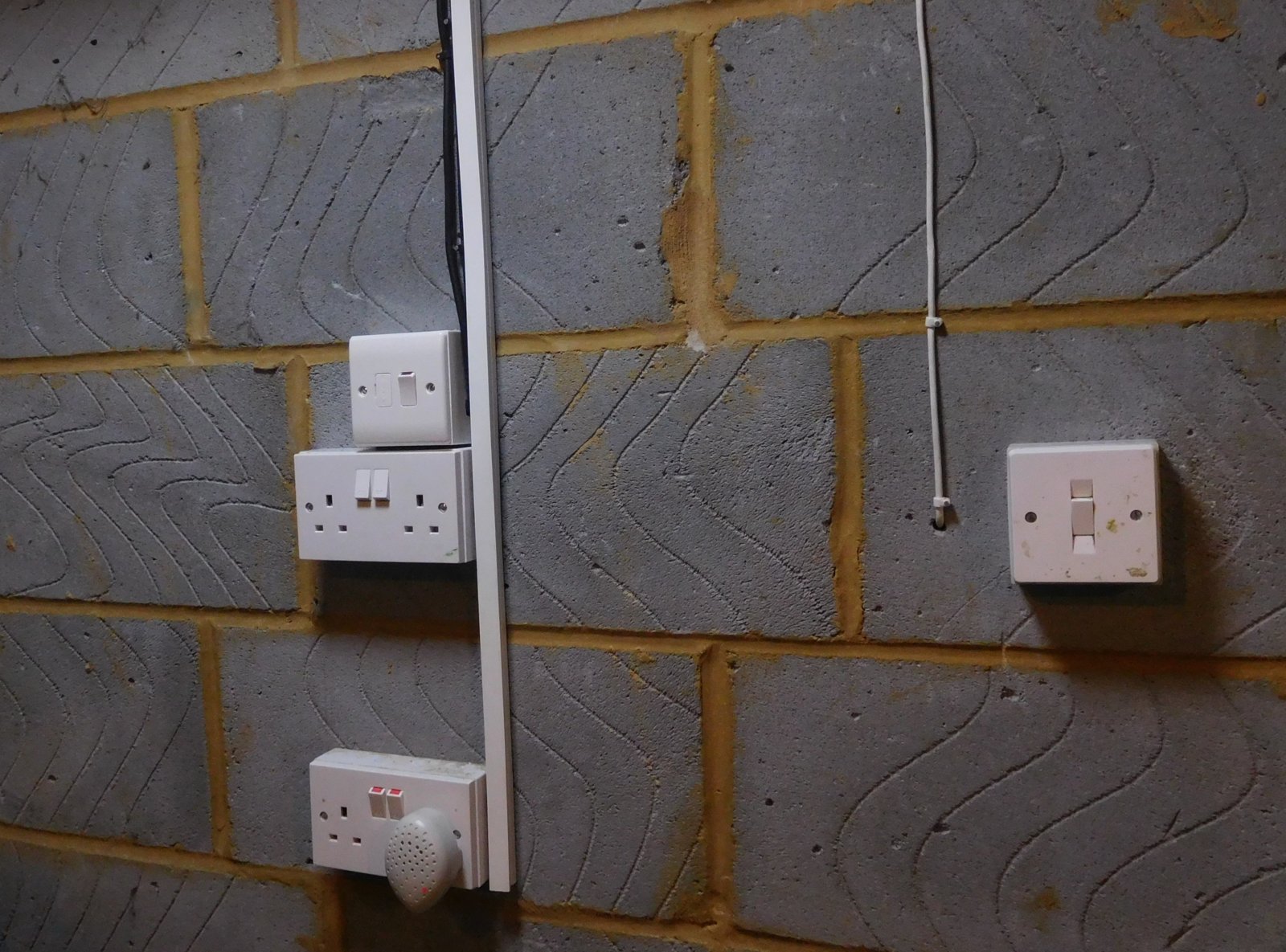

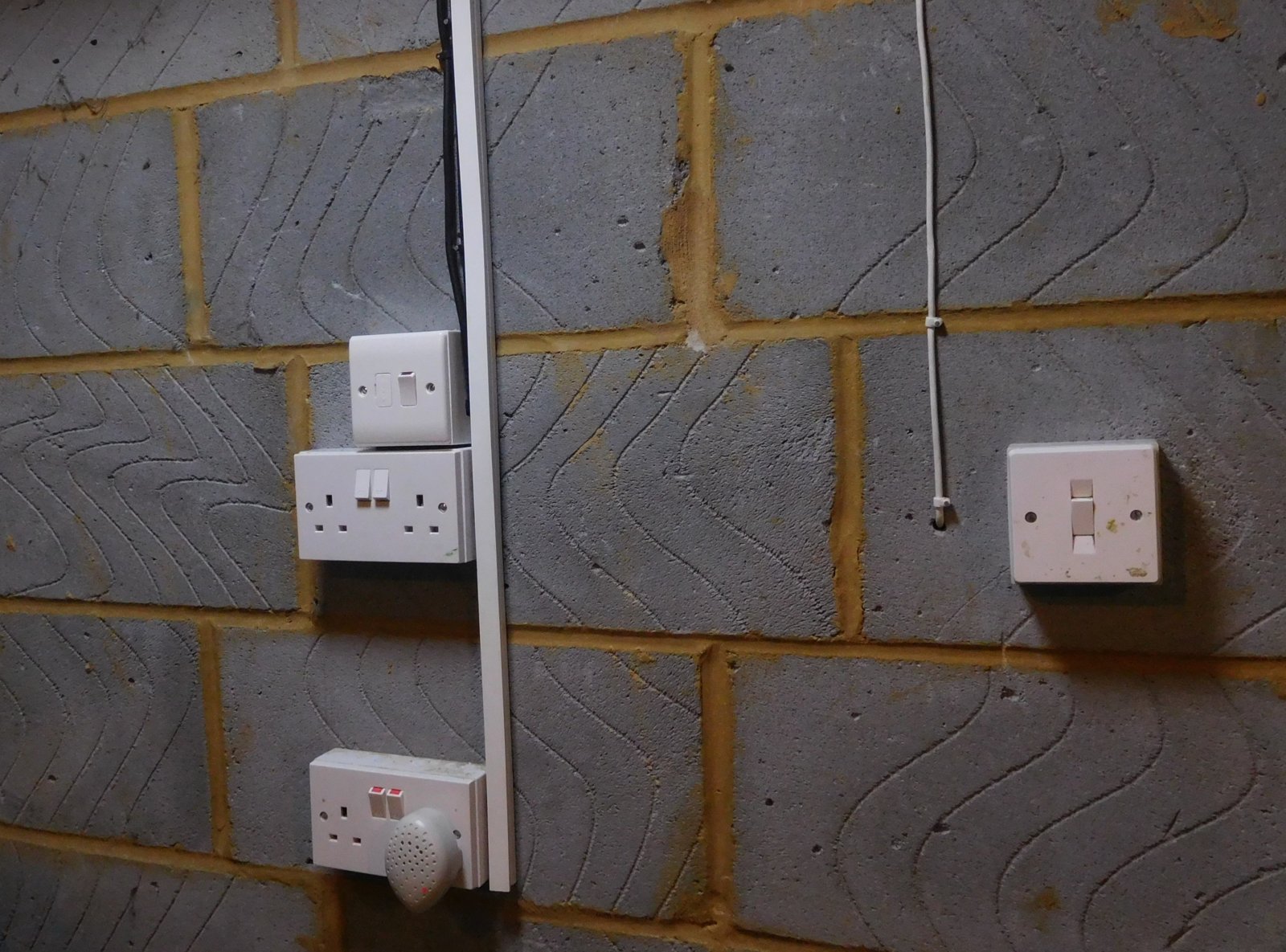

I'm trying to move the current setup in my garage - see pictures below - to make more space on the wall and improve the appearance. We are trying to convert this space into a small entry hall/porch - it will be painted as well. I've done some basics like replacing ceiling lights before, but am still quite a novice with respect to electrics, so all advice would be appreciated.
1. On the right hand side there is a two way switch - leave that as it is (perhaps just replace like-for-like for cosmetic reasons)
2. Remove the bottom double socket - not needed anymore
3. Move the fused switch to the right of the other switch (1.)
4. Move the double socket below together with it, so that is is below the two switches. This socket gets it supply via the cable in the white cable trunk, which also needs to be moved along to the right.

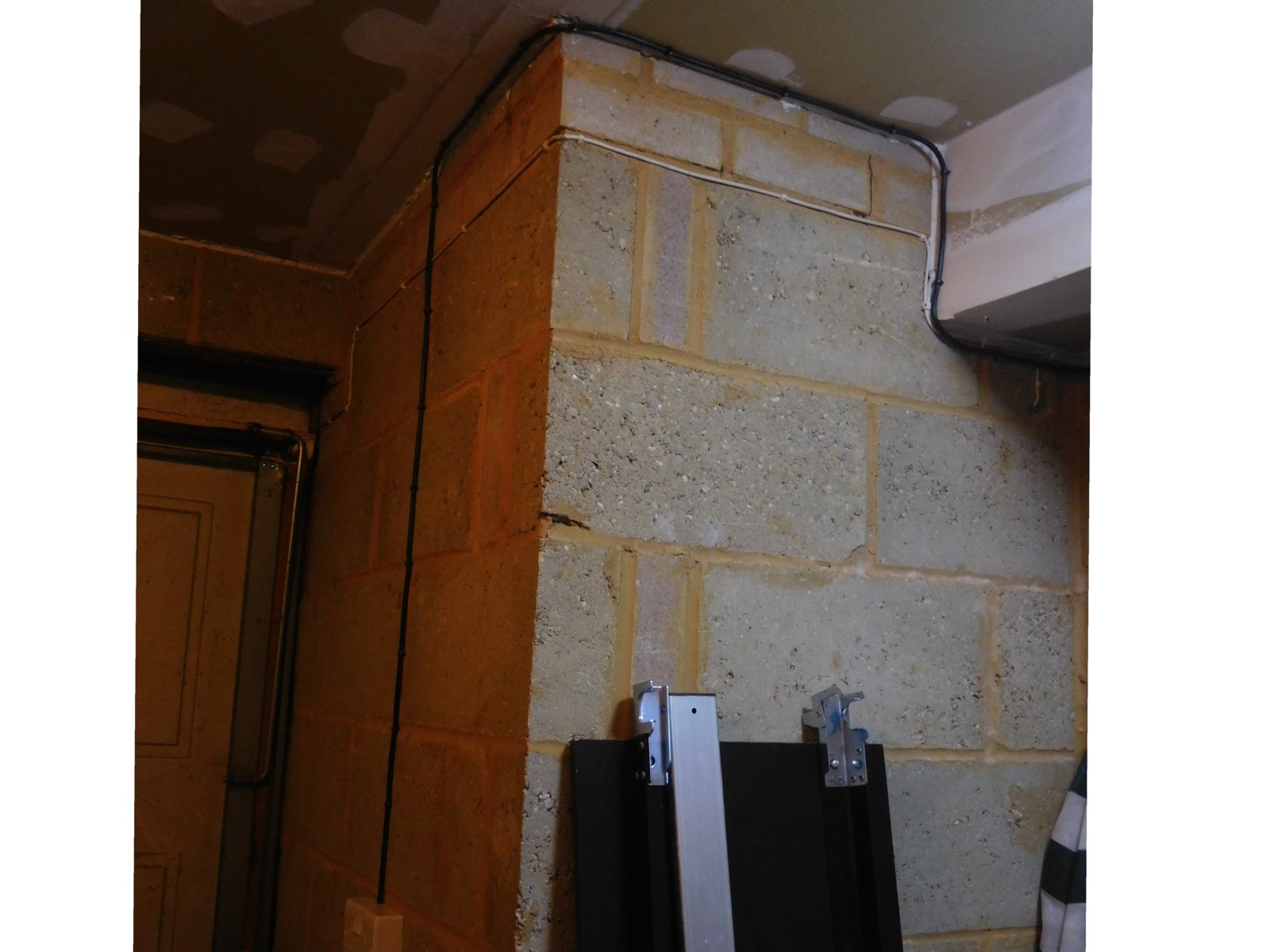

5. The black cables lead to a ceiling lamp and another double socket further inside the garage. I'm planning to use white cable instead of the black and put it into a cable trunk where possible, running along the right side of the wall and close to the ceiling instead of on the middle of the wall.
My main question is what type of cable I should use? I can't see anything written on the black one, and I know there are different sizes (1.5, 2.5 etc). The fused switch and the double socket it connects to via the black cable are both 13A. The same type of cable is used to connect the ceiling lamp, and I'm suspecting it is 1.5mm3 because there is this fused switch in between.
I think I only need to replace the black cable, and can get away with shortening any other cables.
Right now I, certainly, would prefer a diagram showing what's connected where and how rather than photos, and I expect most other people would.
But basically you've not got a lot there, I don't see why you don't just remove everything and start again, putting sockets and switches where you want rather than thinking you are constrained by what's already there.
And don't use surface trunking - it's naff. Plaster or board over the cables. And that type of block is really soft - easy to sink holes for flush back boxes.

How is all this supplied? Is it on it's own circuit, or spurred from a socket circuit etc?

2) As far as I can see the whole setup is spurred from a socket circuit with fuse. I can try to draw a diagram over the weekend, but as I said I think it is sufficient to just shorten some of the white cables which are already there and then replace the black cable (like-for-like). Just need to find out what type of cable it is...

1) Re painting/plastering: I was thinking of just using masonry paint on these blocks. I'm trying to get the area to look a little bit better and make room on that wall to actually put some shelves etc on it, but it does not have to look as tidy as a living area.
It's no longer going to be a garage (what are you going to do about the up-and-over door, BTW?), it's the first place inside that people will see, and personally I'd not contemplate not lining the walls or having them plastered, concealing all the cables etc. But, your house, your rules, your standards.
If it's all from one FCU then you can have what you like after that. If you want to just shorten cables, go ahead. And you don't need to replace that black cable like for like, you just need to replace it with any suitable cable rated at ≥ 13A when clipped to a wall, i.e. ≥ 1.5mm².
