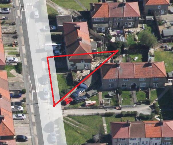

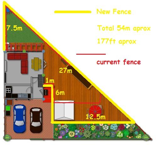

At the moment I have a massive front garden and a smaller side garden separated by a 2m high fence. What I want to do to move the current fence closer to my front boundary so the side garden gets bigger. Like this:
The fence will be kept at least 2m away from the pavement so I should be allowed to keep 2m high. But will this cause any problems with the local planning department?
Heres a view so you can see the surrounding areas. My house is the red area.

from your drawing you appear to be covered more than 50% off the total garden area if so it will need planning
At the moment the decking etc is just a rough plan and isn't down so we can worry about that problem later. However the whole back, side garden and driveway areas are already 95% covered as is.
