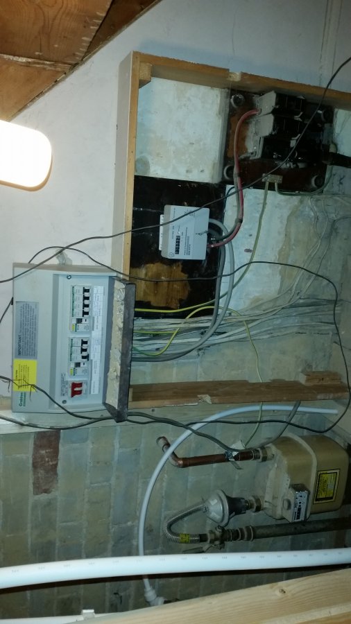

Hi,
My gas meter is under the stairs where we are a planning to build a small bathroom. The gas meter is kind of in the way of the toilet bowl
I had three SGN Gas engineers coming over the last 4 months and everyone tells me a different story about the possibilities. They a very keen to move it outside at an expensive cost but not so much within 1-2 metres from the current position. They alleged regulations to avoid moving it inside the house. One did not see any problems to move it close from its original position just to receive a call a few days later from SGN telling me that he was wrong. I have been told that they wont move it within inside the house as they do not make money out of it.
Other sources tell me that any approved gas engineer can move the meter or install a smart meter and put it in a different position.
It is all really confusing. I would like to avoid going with SGN because I think they are a mafia and would prefer to go with any alternative solution.
Any one has got any advice?
Thanks!

I do not want to move the supply inlet. The inlet pipe will stay put. I only want to move the meter around a metre from its current possition. At the moment the meter is connected to the inlet through a flexible still pipe (anaconda?). I believe a longer one can be installed. Can this be done by a Gas safe engineer?
Do you need to move the ECV (emergency control valve)?
If it stays where it is, can it be seen and safely operated from the new proposed meter position?
My view is that if the inlet pipe and ECV remain in the same position then ANY gas engineer can move it within a small distance from the ECV.
That's if they are happy doing it.
Generally the ECV is expected to be in the same area as the meter.

If a customer had come to me with this issue i would've explained some of what has been said above and i would have no issue moving the meter a short distance from where it is as long as the ECV stays in the same place. You can get long flexible supply pipe.

I have no issue moving a meter around on the Conda either, but, from the OPs description, it sounds like it will be some distance and will leave the ECV is an inaccessible position! Without greater detail/photos, we just can't tell!

I have attached a Pic. The ECV can remain in the original possition however the meter once the bathroom is made it will be in a "different" cupboard and i have been told it may need another ECV. As you see there is space enough, the plan is to move it under the RCD box. Since i have the choice of getting a smart meter for free this should make things easier. Does smart meters HAVE to be installed by SGN as well?
