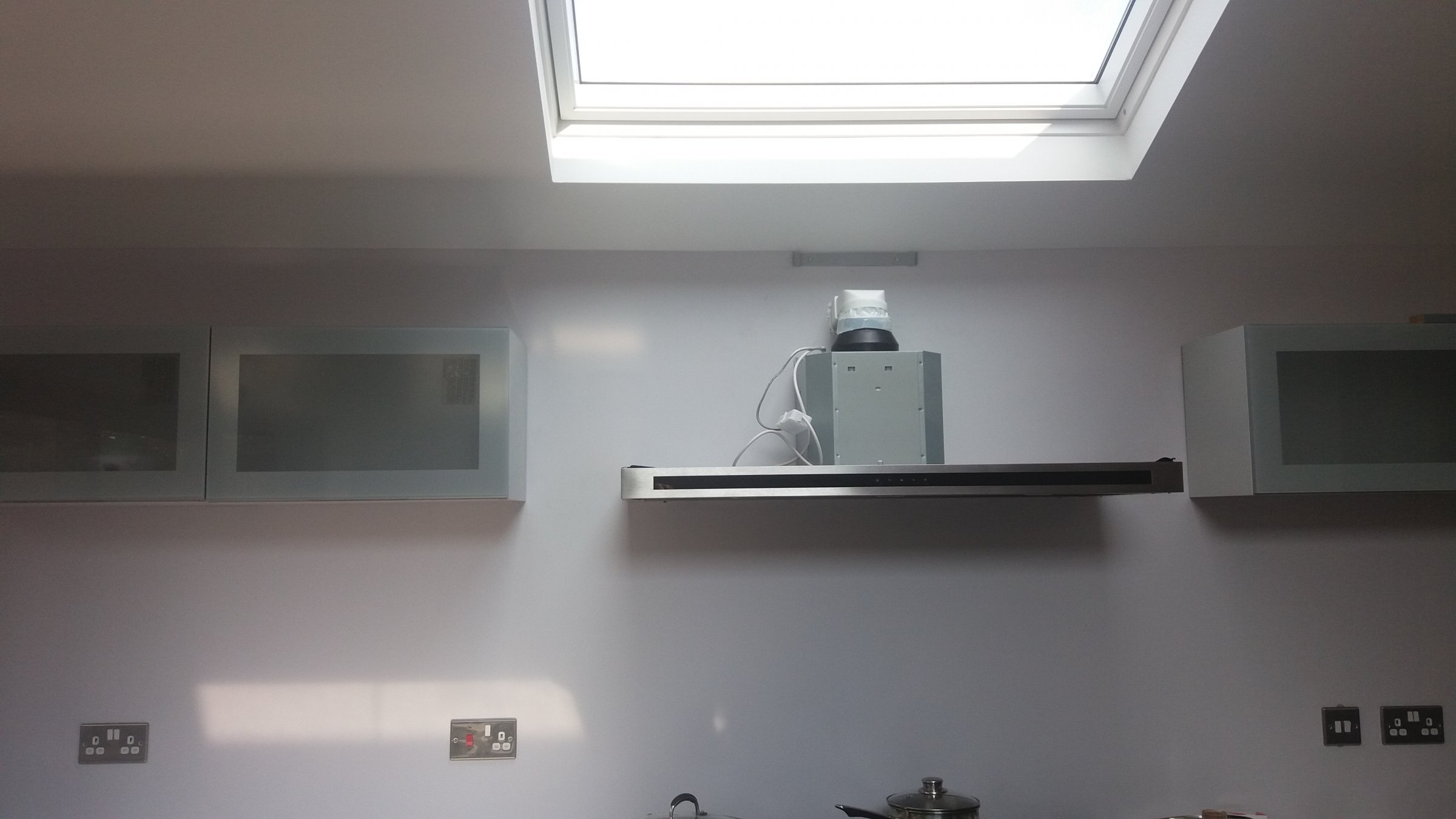

Hi, sorry this might be a bit of a silly question. We are fitting a kitchen and had planned for the wall cabinets to line up with the bottom of the cooker hood. Stupidly forgot to account for the cornice on the bottom when fitting, so I'd like to move them up 20mm.
Question is as it's such a small amount to move them is the 20mm between holes likely to be strong enough to take the weight or am I worrying about nothing? The new screw holes have to be directly above as the cabinets line up with the ones below. Wall is comprised of lightweight breeze blocks (ones which are good for thermal insulation) and dot and dab plasterboard which is quite tight to the wall. Cabinets are midi height 600mm ones.

I think you will struggle not to break into the existing hole. What size are your fixings?
What does it look like with the cornice on the bottom now?
use Cabinet Hanging Rail.
You can then put in plenty of screws at any convenient positions.
Available in 1 metre, 2 metre and other lengths.
It does look like a bit of a cock up, even my other half who originally wanted to leave them now wants to move them.
The fittings are about 8mm wide plugs.
