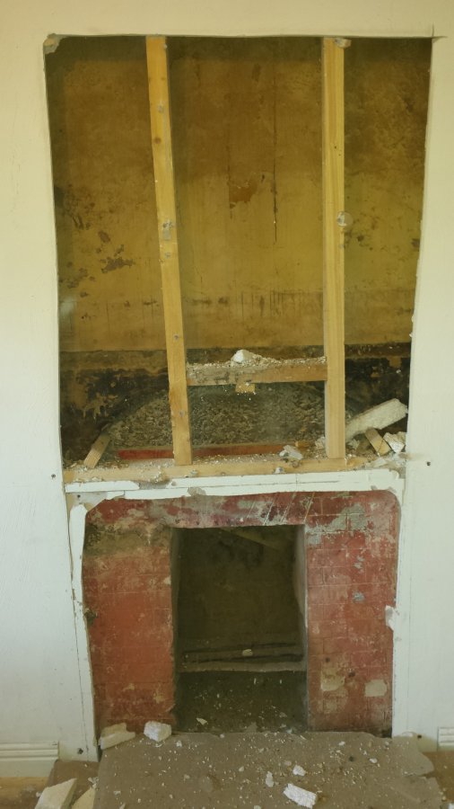

We did a bit more exploring last night and cut out the door area from the plasterwork - that fireplace was inserted inside the old fireplace. There's a sort of arched lintel there already, so the original fireplace would have been about 3' wide, which is the width we need to open up for the door. I imagine if it can take a 3' fireplace it can take a 3' door. We might know more when we've cut away more to get the lintel in.
If you look up inside the chimney you can see that it looks like it runs up to the stack - poor photo I know.

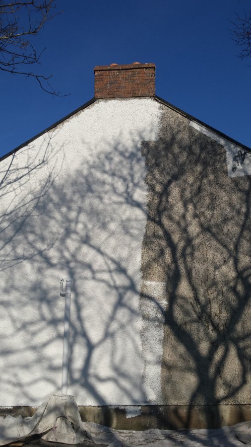

There are very few clues from the outside - it looks like this. The top of the stack is contemporary red brick, everything below it is stone from about 1890 we think. This photo was taken halfway through painting the house! One interesting thing - the fireplace is not directly under the stack, it is a few feet to the left, looking from the inside.
Thank you for the pics.
I now see that the c/breast is a rear projecting c/b. No need for any strong boys or propping in the room but what about the external width of the projecting c/b?
Flues often moved off centre to accomodate other flues in the c/breast and stack.
I presume by rear-projecting, you mean it projects into the room but not outside the house? I'll open up some more this evening and see if I can get an external width on the c/b.
Rear projection means the c/b projects out beyond the face of the outside wall - according to your pics, the c/b obviously doesn't project into the room.
You measure the outside width by going outside and measuring the width. Nothing needs opening up.
Why not pic the outside?

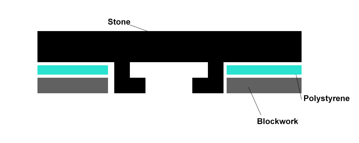

True, it doesn't project inside, but if you look at the exterior pic it doesn't project outside either! I have once seen into another section of the wall from the floor above and I saw the top of a block wall - so I'm suspecting something a bit like this is going on. We might need to get some more plaster off in order to know for sure.
OK, all becomes much clearer. Your c/b does indeed project into the room only for an inner wall to bring the whole wall flush.

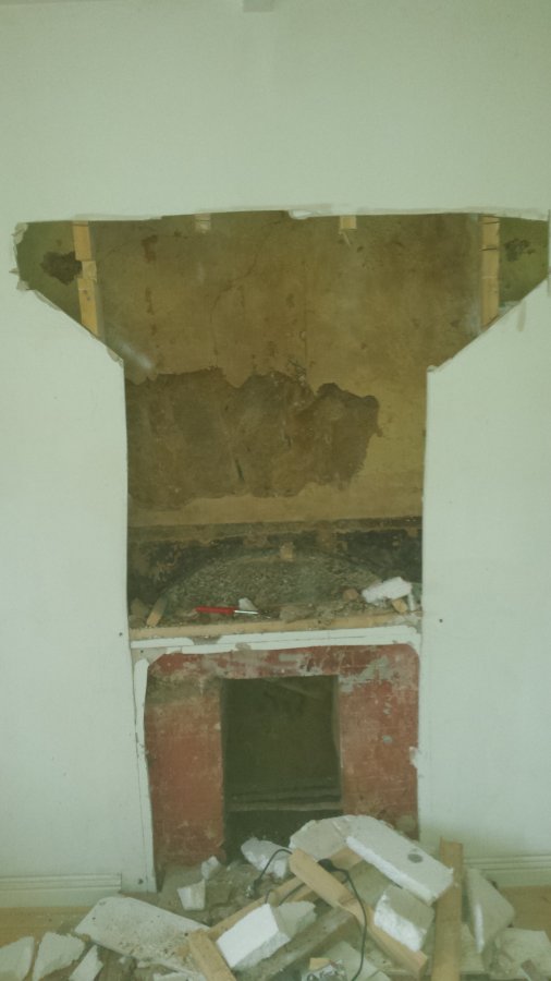

You will need to expose the c/b width by hacking off the plaster,say at skirting level unitl you reach the full width of the c/b - if the c/b is narrow then the lintel could bear on a padstone on the blockwork but wait and see what the measurement reveals?
At a later stage a long bit can be drilled thro the stone and rubble outer wall to give a depth and a reference point. Or a small central hole can be opened up. First, a pic.

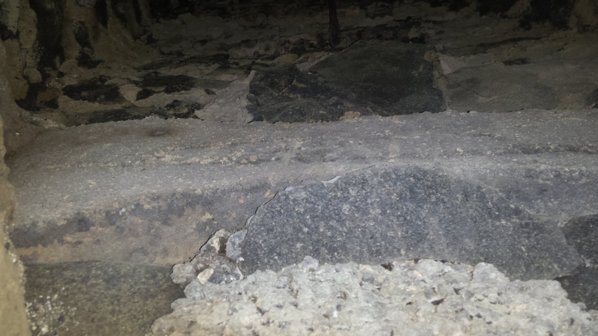

So the plot thickens. I opened up a good 5' of plaster where the lintel would be as that will all have to come off anyway. It's all stone, and that same 1800's rough plaster goes out a lot further than that if you look in behind - no sign of any modern blockwork.

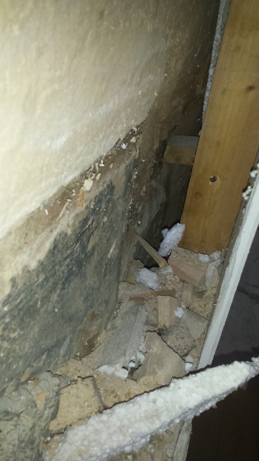

If you look up inside the chimney, there's no joists visible (obviously - they would burn!). But if you look up from in front between the wall/chimney breast and the plasterboard you can see the joists resting on top. That seems to go all the along the wall. It seems like the first floor is resting on an internal wall and the external wall is simply holding up the roof. The blockwork I saw from upstairs may simply have been used to repair the top of the wall some time ago when the bathrooms went in.
2015-07-24 20.00.52.jpg (joists resting on the top of the internal wall)

So I'm guessing that I'm looking at two load-bearing rubble walls with a chimney flue built between them.
I think that you probably have a single stone and rubble wall - altho its not yet been established in any of the pics? It must be pretty thick to contain the fireplace and flue within the wall - but there is no chimney breast as such. A common practice in older cottages.
A plasterboard & stud framing has been built on the room side of this wall. Is this stud wall supporting any first floor joists?
You will only need to lintel the stone wall door way opening.
