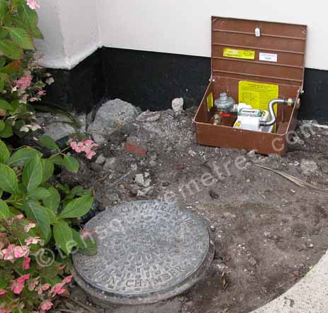

A semi buried gas meter box could be a solution for you.
Thanks for that Bernard. With your 510yr old thatched cottage that is a very nice solution! Probably not worth it for me, I live in a Jerry-built place which wouldn't really warrant it. It was just that it always used to be inside and then it got moved outside for no particular reason that I could see at the time, everyone down my road in a similar-aged house still has the gas meter inside I think?
