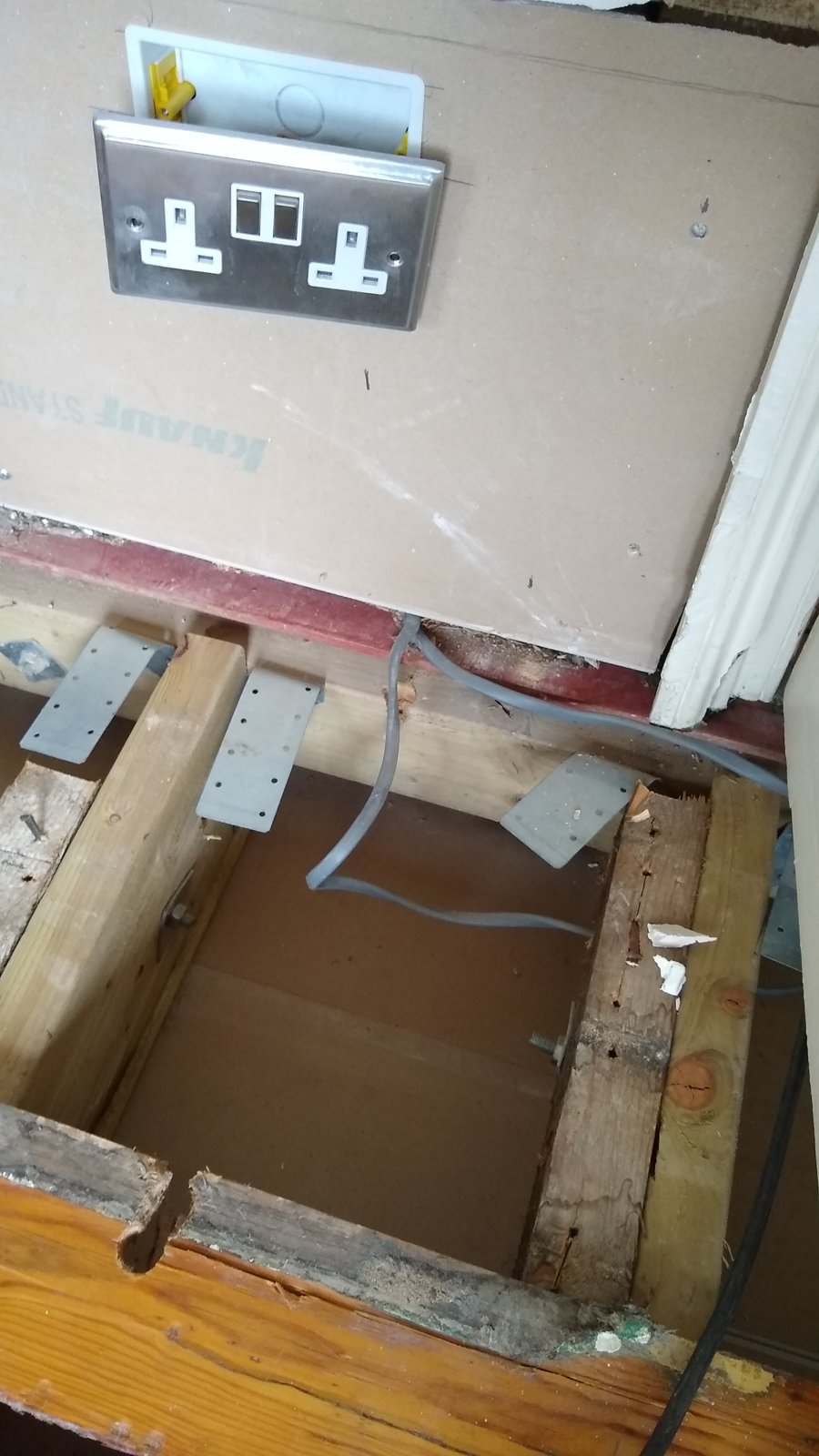

Yes, as long as your circuit is already a 2.5mm² ring or 2.5mm² radial, and not a 4mm² radial for example.
So... the plot thickens . I'd like to move the first socket in the circuit but the cable coming from the fuse box isn't long enough. It is in an awkward position above a steal beam which means the wires coming up from the floor cavity are in the way of the floorboards that i am laying. Is there a safe to extend the cable with a junction box or by any other means? If so, what do i need to get to extend it?
Nope. The "maintenance free" is the important part of the one I linked to, as the joint is going to end up not being 'accessible'.
I obviously can't see the whole room, but, surely, if you are moving sockets further apart, the socket in the picture would have to move to the right, so the wire would be long enough.
Can you not leave it where it is and just install extra ones?
there's a door to the right of the sicket
That was the plan before I realised that the floorboard won't fit with the cable laid over the steel beam
