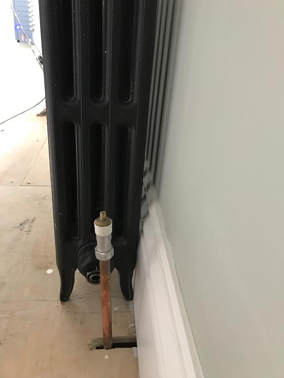

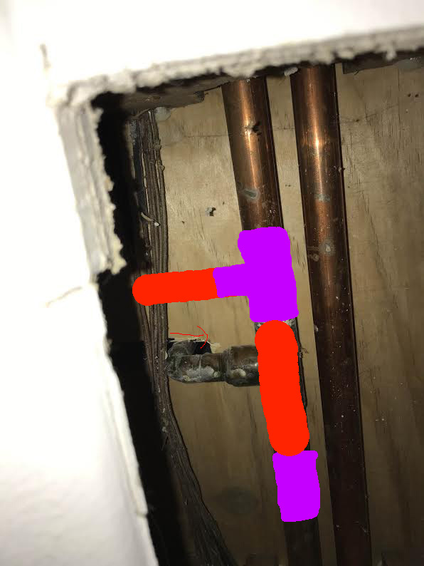

Noob question alert. Note that I am doing this from below, so the picture is underneath the pipework.

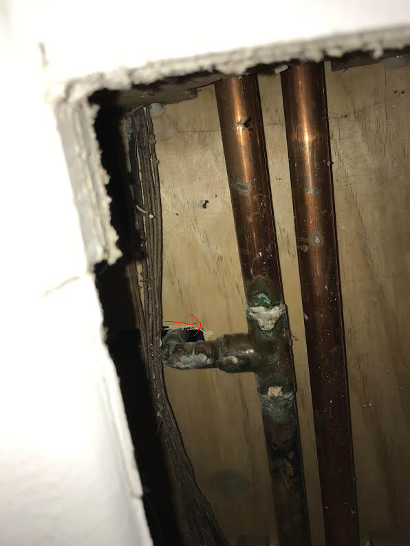

I'm installing a new radiator and I need to move a pipe slightly. The 22mm pipe will not budge and I don't want to force it as it will strain some other joints, so I am left with adjusting the pipe to the radiator.
My initial plan was to cut it off and stick a speedfit elbow on but the soldered elbow fitting goes straight onto the reducer from the tee, so there's no 15mm pipe to work with.
I don't fancy my soldering skills in such a tight spot.
What would you do? Is it time to call in a pro?
so you need to move the pipe forward and across about an inch?
if you're not going to solder it, do it with compression fittings rather than push fit.
fit the rad valve, drill a hole in the floor (mind those cables!) and drop a bit of 15mm down, that'll give you a better picture of what you need to alter.
it maybe the case where you can cut in a 22 x 22 x 15 compression tee into the existing 22 and that'll go into your new pipe you've just dropped, then a small bit of 22 and join that onto the other end with a compression 22 straight

Thanks Gasmanstu
Actually the pipe just needs to come forward about an inch. It doesn't need to go across at all.
What I'm finding tricky is there is no room on that tee at all. There's the tiniest bit of 15mm between the elbow fitting and the reducer on the tee. I really don't see how I can bring the pipe forward. And that 22mm pipe will not budge at all.

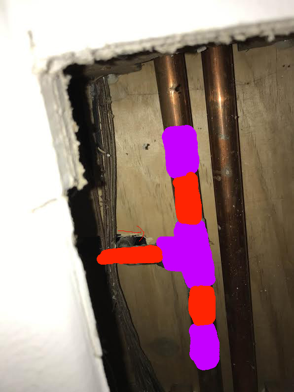

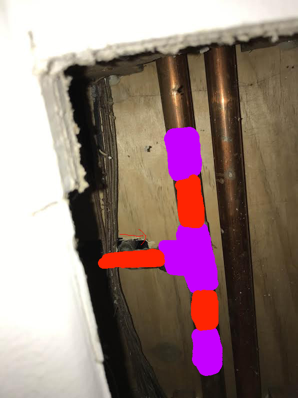

Would it be easier for me to cap off the existing 15mm part of the tee, fit a new 22m x 22mm x 15mm tee nearby and run the new 15mm into that? Seems a bit bodgey and would be a shame as the pipe is otherwise in the right position.
bit like this (except without the funky colours)
Ah ok I think I understand what you're saying. Thanks!

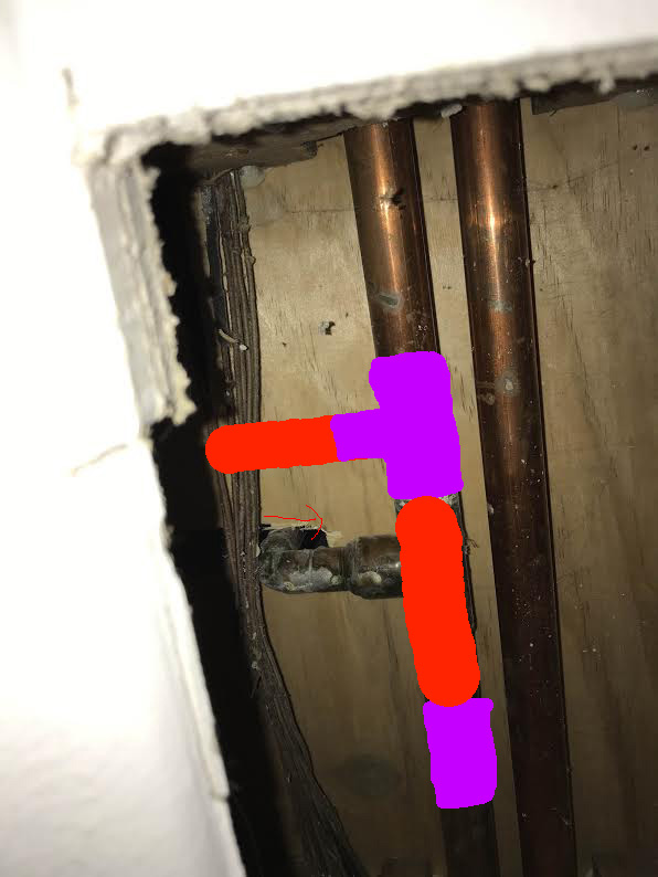

Given that I don't need to move the pipe over, does this sound like a good plan?
1. Cut the old tee out
2. Extend existing 22mm pipe if necessary with straight coupling and some 22m pipe
3. Replace old tee with new compression 22 x 22 x 15 tee
4. Install new 15mm pipe into tee
I think this old tee with the reducing end is using up space and the replacement tee should be smaller to give me more room to bring the pipe forward
You can do the middle T as a solder and the 90 degree bend with a bend as you can do all this in advanced of installing between the two compression fittings.
Any tips for bending without a pipe bender? ;) Don't fancy dropping 70 quid on one.
Actually my biggest problem right now is getting my 22mm pipe cutter around the pipe. Really tempted to get a pro in!
A bending spring !- down the 15mm upright - then ease pipe forward at the top - it will meet the new rad lower down . It will look crooked but I've seen worse ;) If not the way is as gasman stu outlined. To use a spring you need a hacksawed pipe end ( not tube cutter )
So even with replacing the tee with a compression joint the elbow compressions are still too big to allow me to bring the pipe forward. There's just not enough room.
I think my only option is to solder a new elbow fitting.
Thanks for everyone's help.
