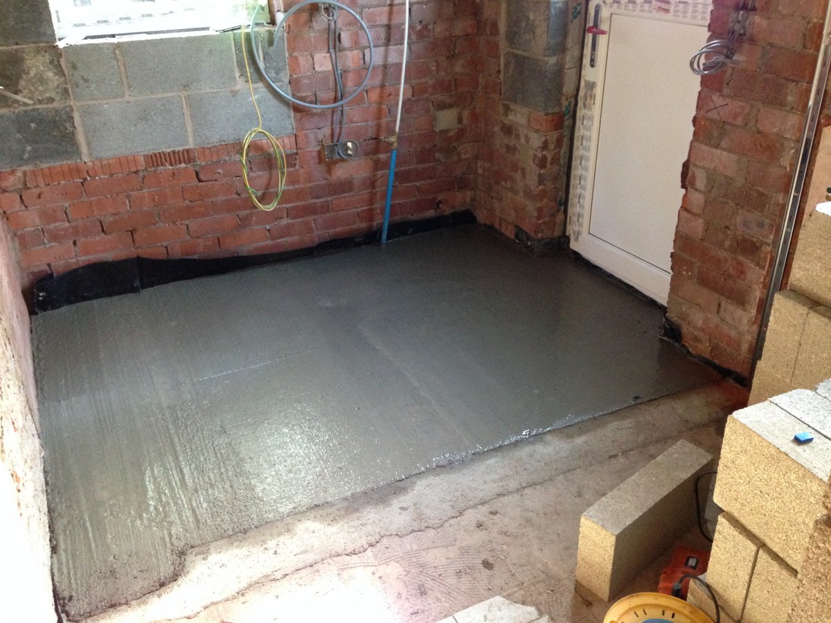

First we insulated and raised up the floor which was 2 different levels:

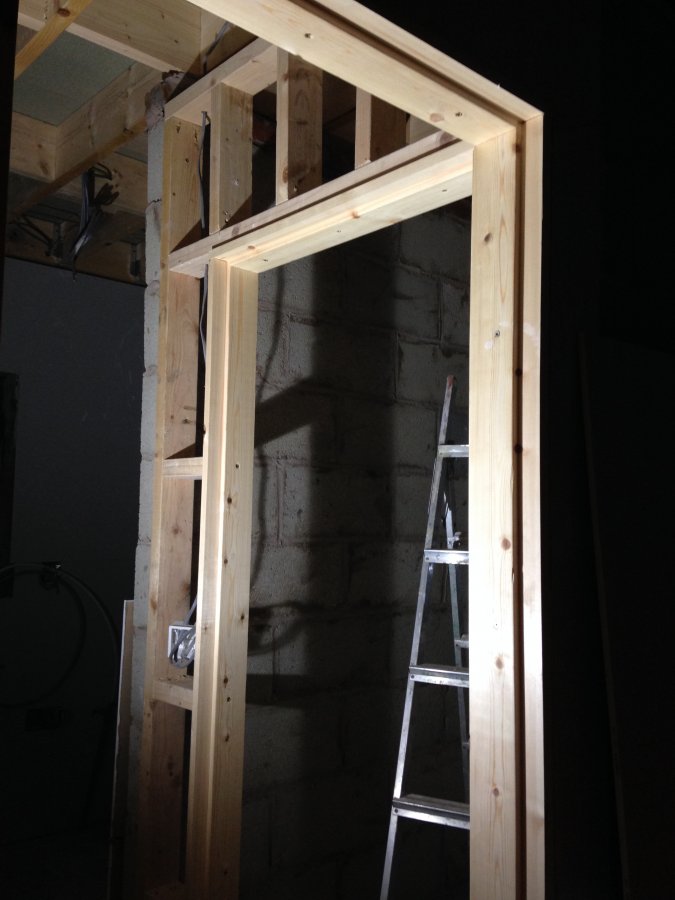

And then a timber doorway:

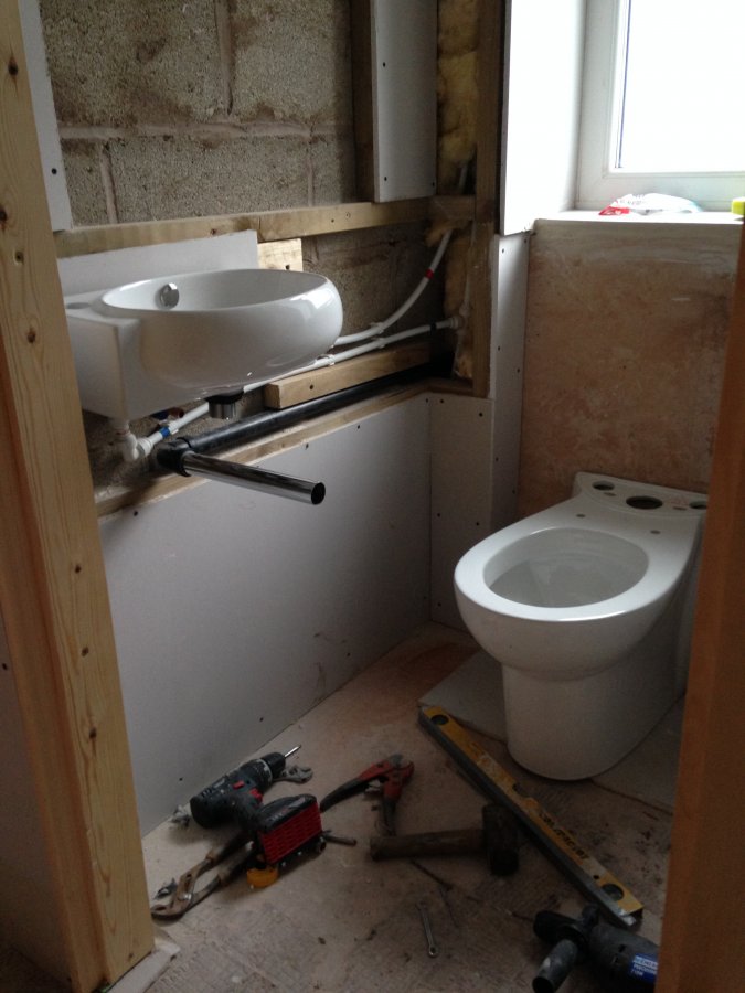

We mocked up the sink and toilet and drilled through the wall:

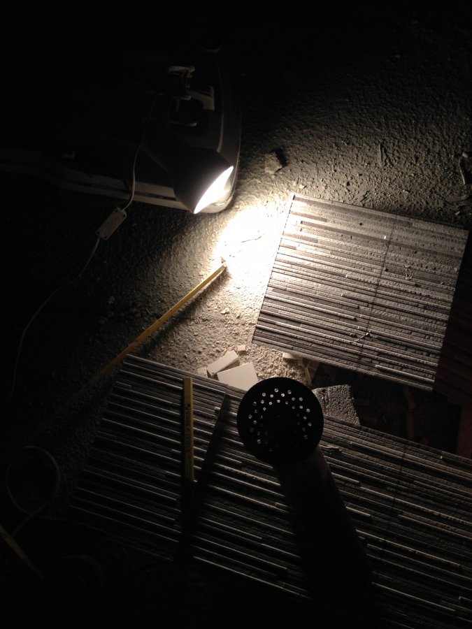

Then when we finished boarding I cut the tiles and my missus stuck them on:
