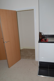

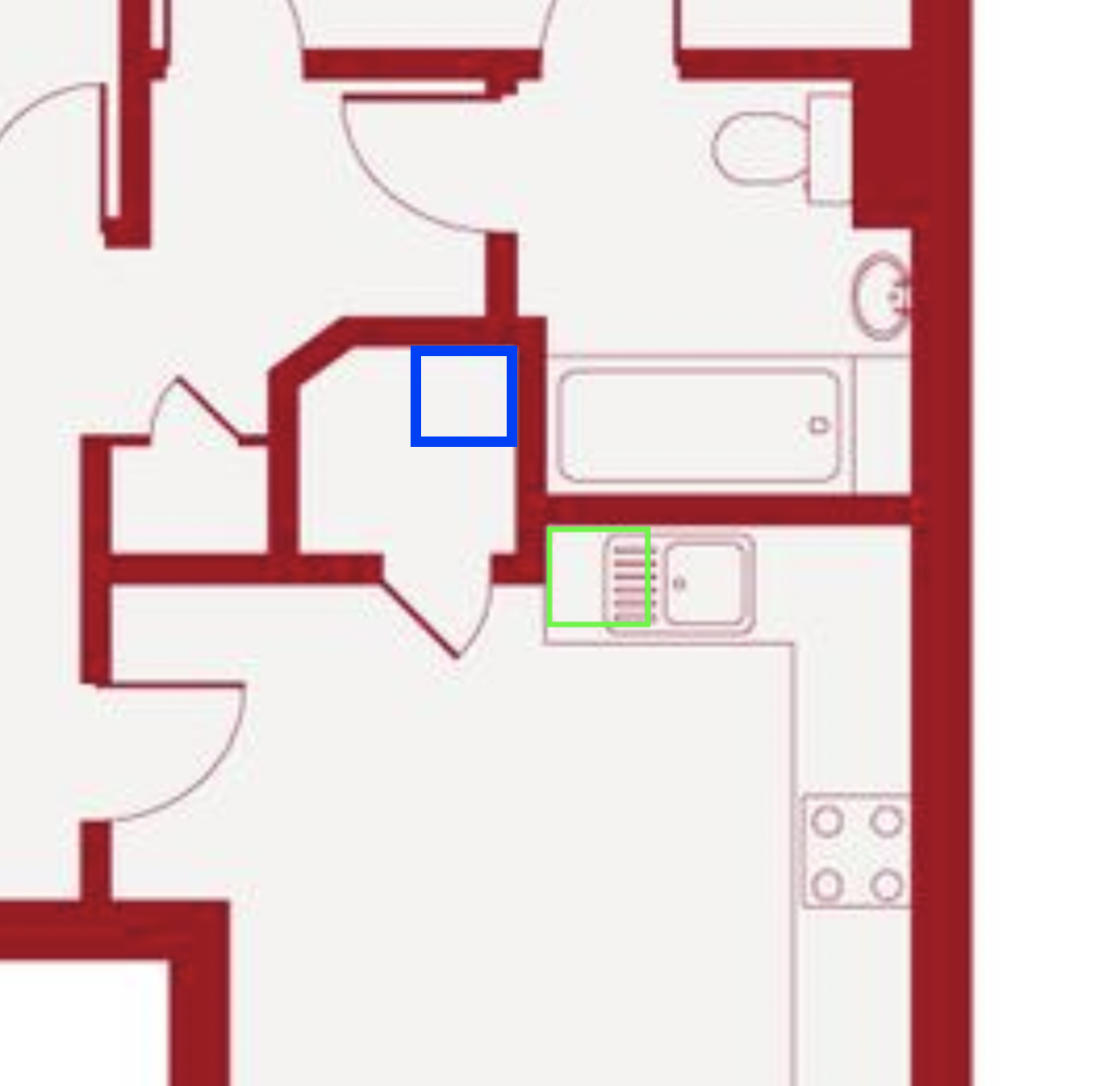

I live in a relatively small flat with an open plan kitchen, an integrated washing machine and no dishwasher (see pictures below).
Next to where the washing machine is (green square in the floor plan below) is a small storage room (see also picture - no longer carpeted but with this luxury vinyl click flooring. Also, no electric plugs or water/drain points).
I would like to move the washing machine to the storage room (blue square in the floor plan) so that I can put a dishwasher where the washing machine currently sits.

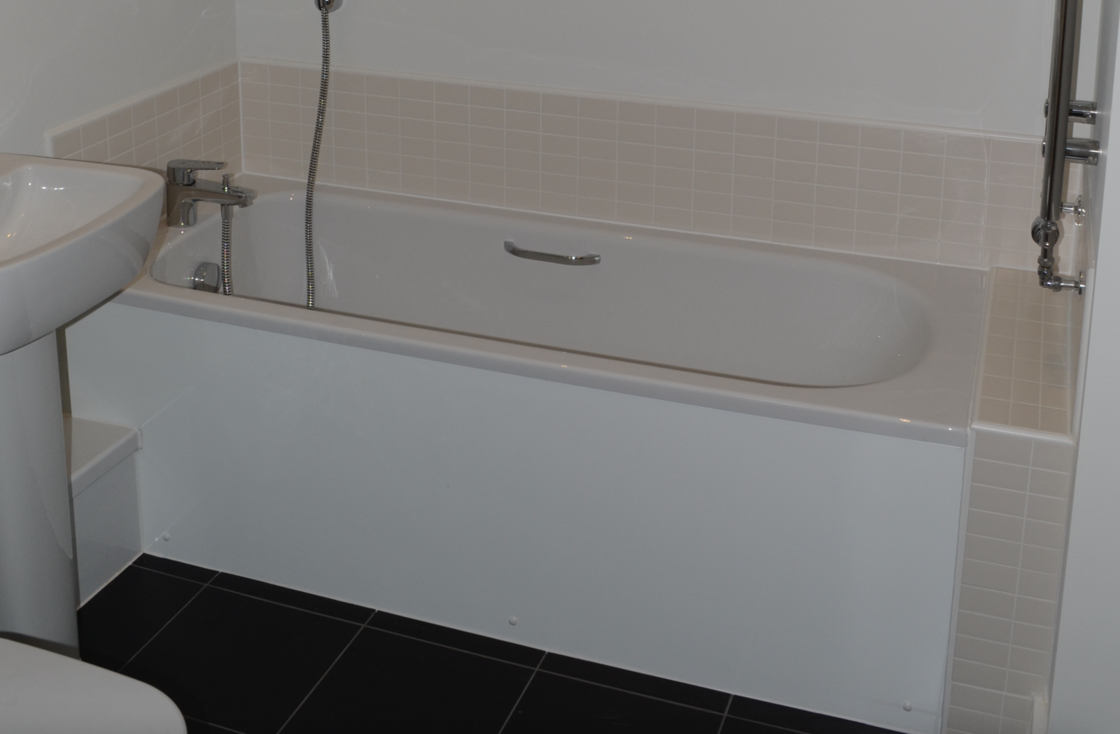

Looking at the floor plan I was thinking that the easiest solution would be to break through the bottom of the
storage room wall to where the bathtub sits (see picture) and connect a water line and drain line to the bathtub's water and drain lines. Of course, I would need an electrical plug, but I reckon that is an easier job by creating an extension from the current washing machine's plug (just behind it).
Does that seem like a feasible project and, if so, any thoughts on the potential cost (not including appliances)?
Thanks!

From a practical standpoint, it's very feasible.
However, in reality, you may have some issues!
The holes you need to make in the structure might need permission from the freeholder.
If you are in a tower block type flat, the structure you intend to drill through may be reinforced concrete (although unlikely!)- not simple to get through.
Is there any fire/smoke detection in the storage room?
Since Grenfell, landlords may be wary of where washer/driers are placed.
Is there any ventilation in the storage room?
You may end up with a very warm and damp room, that will cause no end of problems!
...and if the bath is oriented as in the plan, to reach the water supply and bath waste, you would probably have to remove the bath!
I'm sorry, I don't think this is as simple a solution as you may think :)

And about removing the bath, I was aware of that but was hopeful that all that needed doing was to remove the plastic panel on the side of the bath and that would give enough access!

Access to waste pipes under the bath will be exceptionally difficult.
Probably easier to go through the wall under the bath, and then through the other wall under the kitchen sink.

For the waste and water, I would consider taking it from the kitchen sink and through that stub wall, if there's space. It would be a lot easier than connecting to the bath.

Thanks for the replies. I had thought about taking it from the kitchen sink. I guess the question is whether a washing machine drain hose has a maximum length and whether it bends too much - but might be easier.
