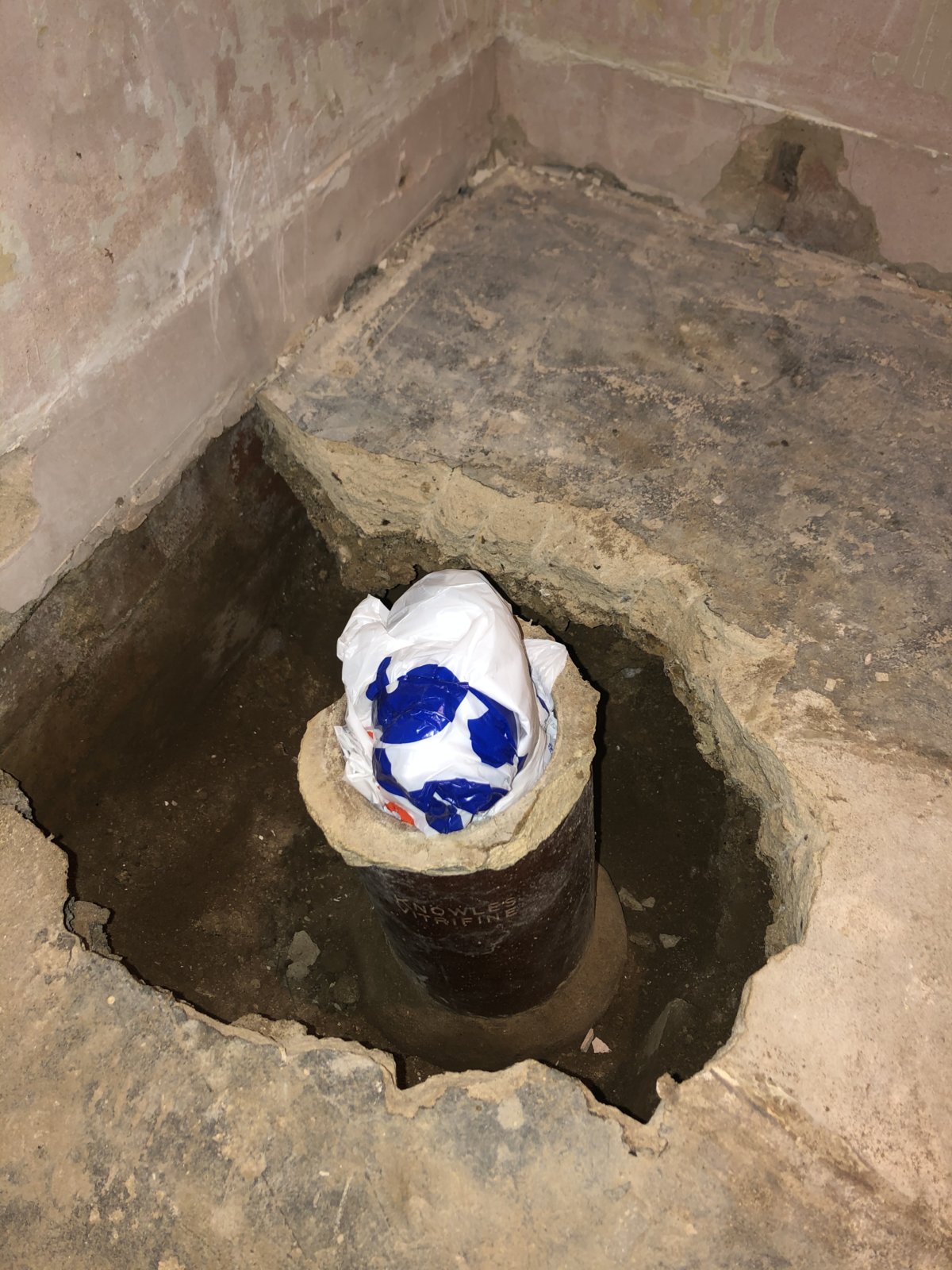

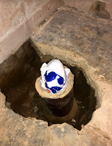

Evening All,
I’ve partly started this process, essentially I need to move the toilet waste pipe closer to the wall so I can fit my new toilet.
I’ve excavated around the pipe and plan to cut (multi tool with ceramic blade) the pipe and fit a suitable fitting which pushes the entry point closer to the wall, allowing my toilet to be fitted with ease.
Has anyone done this before, anything I’m missing? I’ve attached a couple of photos with where I’m up to.

What about a botttom exit pan? Or using a swan neck pan connector?
You just want a BO pan.
What is the distance from the wall to the centre of the soil pipe?
He's done the excavation, so he may as well get the soil further back... Much more options for pans too, when it's standard outlet. :)
You could wiggle the top piece of clay out of the next collar, use the black internal connection above then mortar it in as well. That would be easier than cutting the clay to take a bandseal.

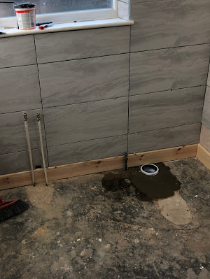

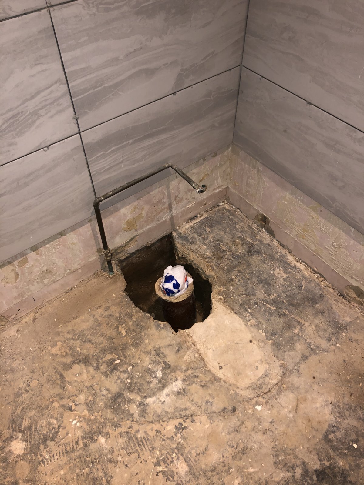

I managed to get this done in the end, however, wouldn't suggest how I did it.
I broke the concrete down around the pipe and fortunately there was a join that allowed me to remove the top part of pipe and replace with a coupler. I placed the coupler in the pipe under the ground and then used a flexible toilet pan connector to suitably angle my new inlet and backfilled with cement.
I have attached photos for your reference but I would strongly suggest NOT to use a flexible pan connector as they're not the most rigid under the ground. Fortunately, our downstairs toilet is barely used and so far no sh1t has hit the fan!
